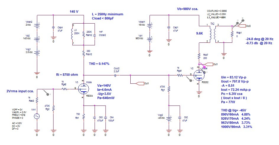

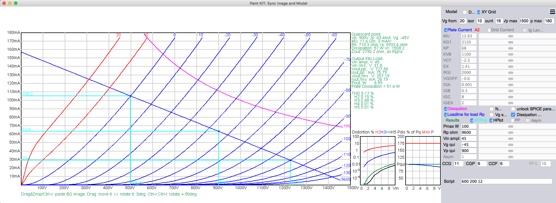

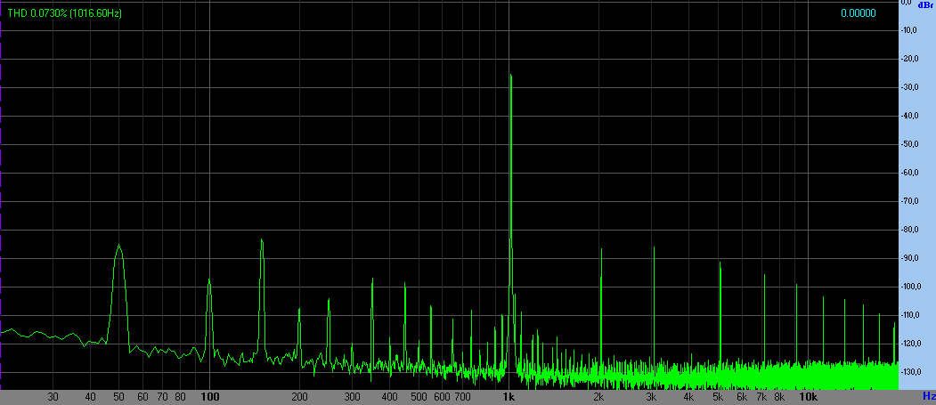

Here is the diagram of 2 stage RE084 + RS282
Look how the RE084 has low distortion with 5.8Vp-p input @ Ug=-3.5V (7Vp-p room for input signal...)
And with 250Hy in anode, with lower Hy in anode THD will be higher...
But observe how is distortion rises with decreasing of Io of RS282
With added 1K in series to the RE084 output resistance there are no visible rolloff on RS282.
Since there is no Cga for triode mode connection for RE282 I put 6pF. Probably there is higher value of Cga?
One of the the main issues in this sch is huge diference in supply voltages on power and input stages
Thatdeservs 2 separate power supplies... One main transformer with multiple taps on secondaries HV can be used.
To optimize that part and avoid another power supply transformer for input stage only...
I observe power from load at the anode of about 6.3W with 5.8Vp-p input signal (2Vrms cca.)
(Ioutp-p x Uoutp-p) / 8
That is without transformation loos and other losses...
Next step is to check same but with Cathode follower prior to power tube to see what is happening...

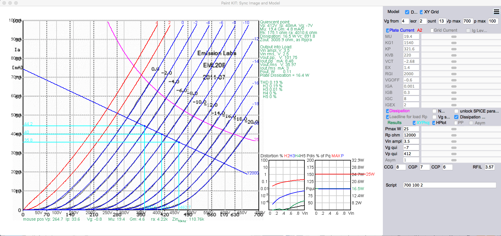

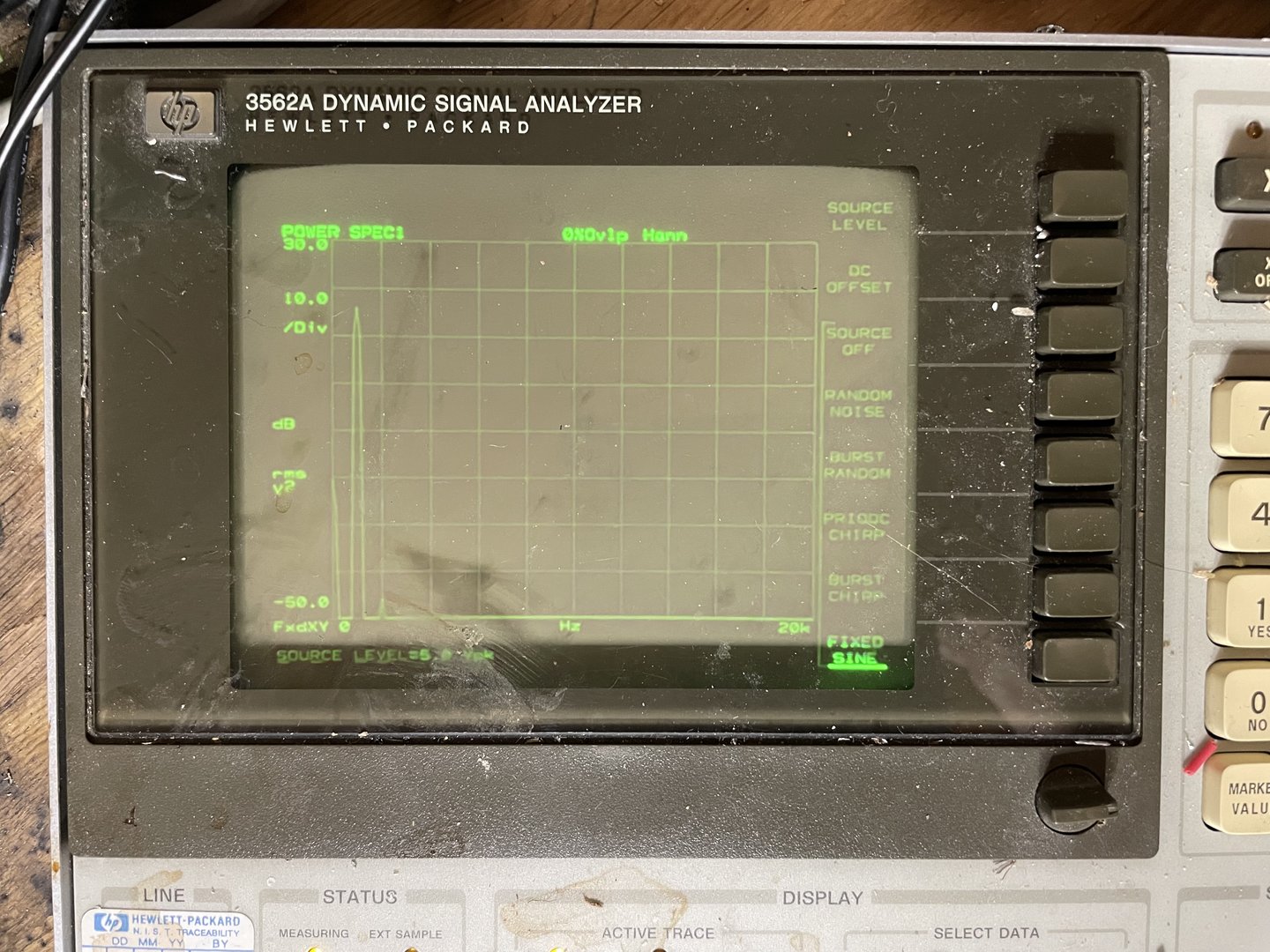

Yes that is another measured anode chrs diagram and should be compared to manufacturers one.If you search for Ale's measurements, easily found this:
https://www.bartola.co.uk/valves/2019/03/24/eml20a-driving-eml45b/
In this measurement Zin (10kHz):590k
590k impedance at 10kHz results about 27pF input (Miller) capacitance.
But where is the transfer graph You refering to?

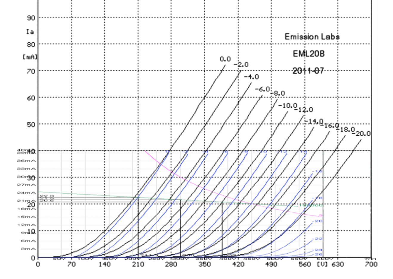

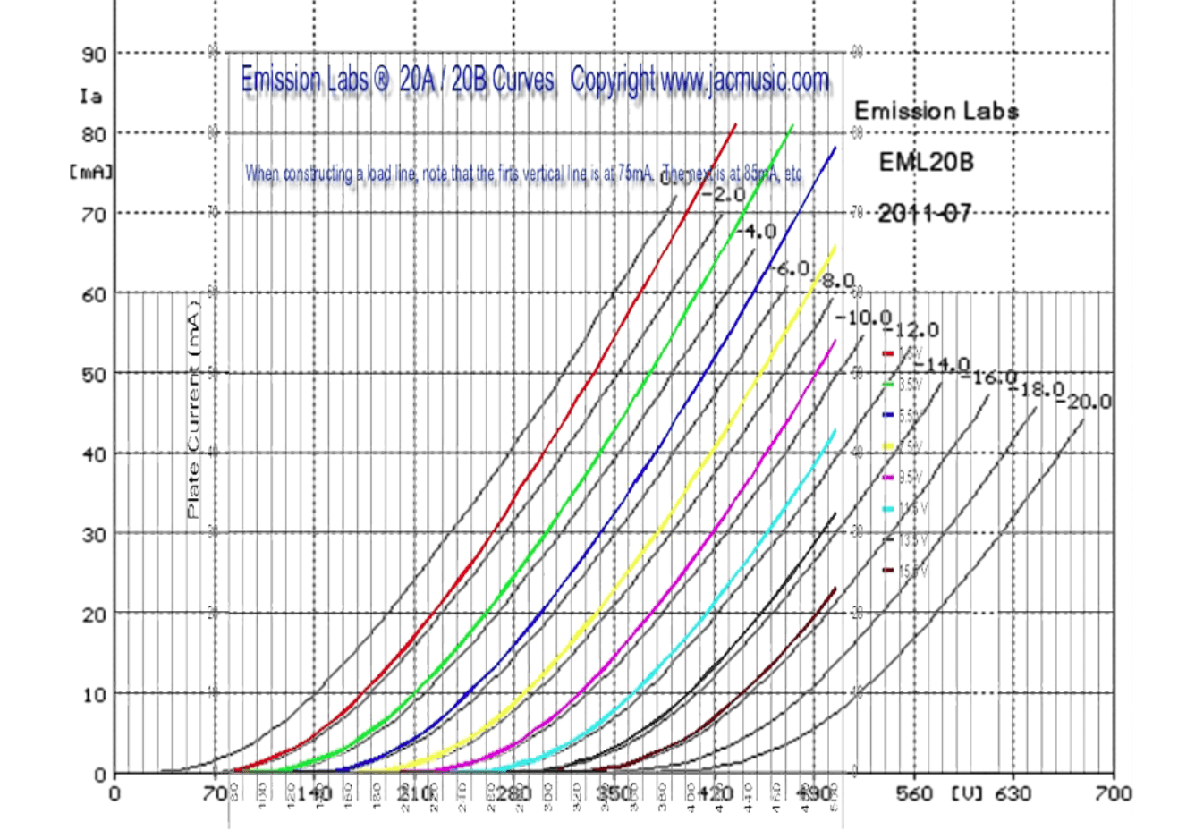

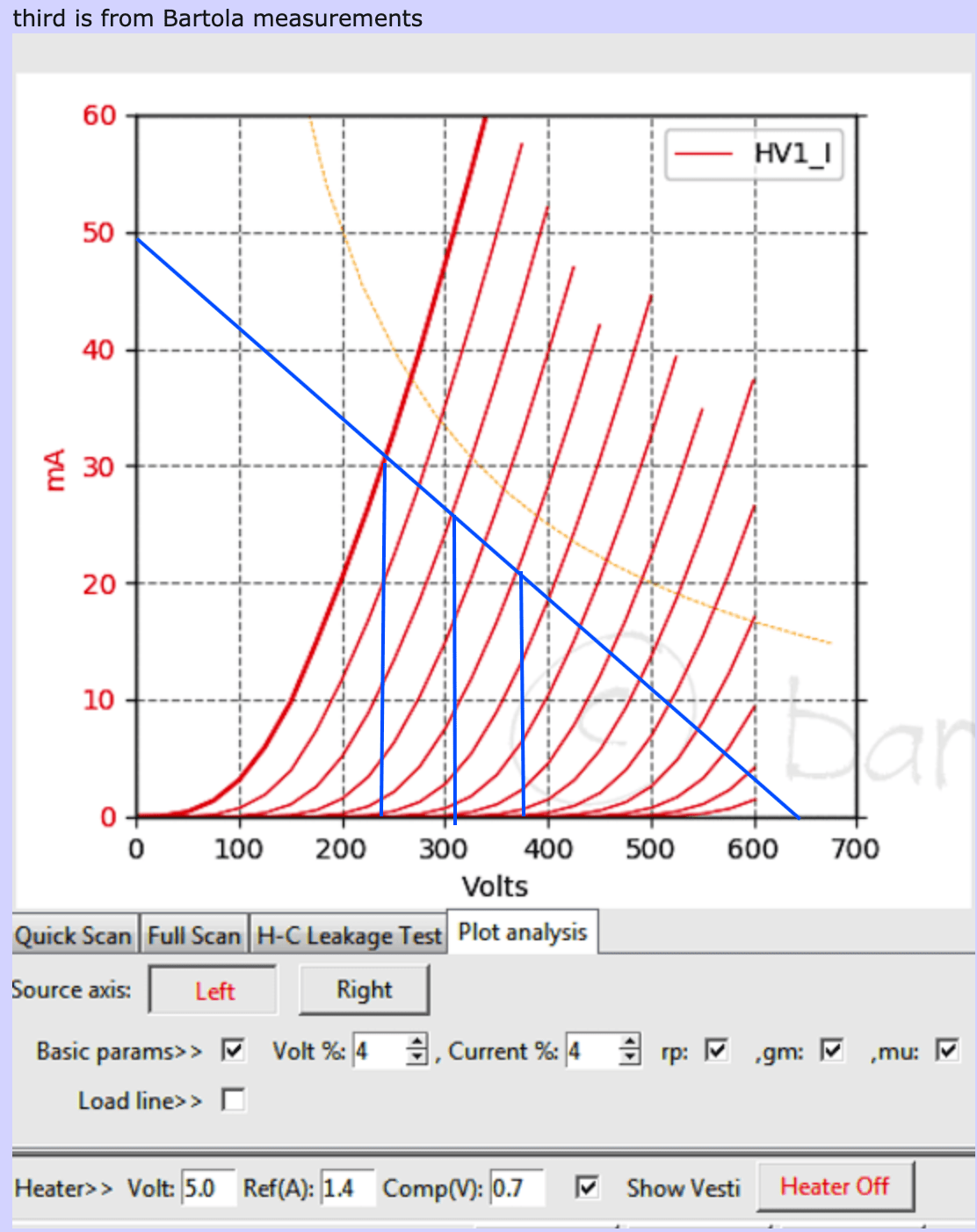

Done some photoshop scaling to compare 3 diferent anode chrs. for 20B Emission Labs tube.
The curves are from the same "family", slopes are similar, but there are major differences...
So it could imply to the poor constancy of specimens or something else.
Bare in mind that capacitances are missing...
These issues can not go with very expensive pair of tubes... 😳
Somebody try to think about the 20B tube origin?
It has larger ratio of Wf / Wa-max like some Telefunken DHT models?
Please see the compared anode chrs:
Note about -Vg it is not the same step and not starting from 0 in some graphs
(Why don't they sett the axes numbering in some round values;
50V, 100V etc... 10mA 20mA... -1V , -2V etc.
Like brands always did before? 👎)

Zoran, putting aside the tube curve variances, axis numbering, etc, and of couse the missing capacitances, I have used EML tubes in the past and they are very good. Built like a tank and also sound very transparent, low distortion. They need 100+ hours of break-in to show their stuff, but otherwise good. I am thinking of the following operating point on the curve below.
Assuming 2Vrms in, You should expect 2Vrms x 2.828=5.6568 Vpk-pk in, giving output 20 x 5.6568 = 113Vpk-pk output. Distortion will be low. Second harmonic below -60dB at 1 kHz .Here is a proposed operating point of -4Ug, 320V, 25mA. Gives a little headroom with a -2V input (no input transformer). Output would be approximately 160Vpp.
Thoughts?

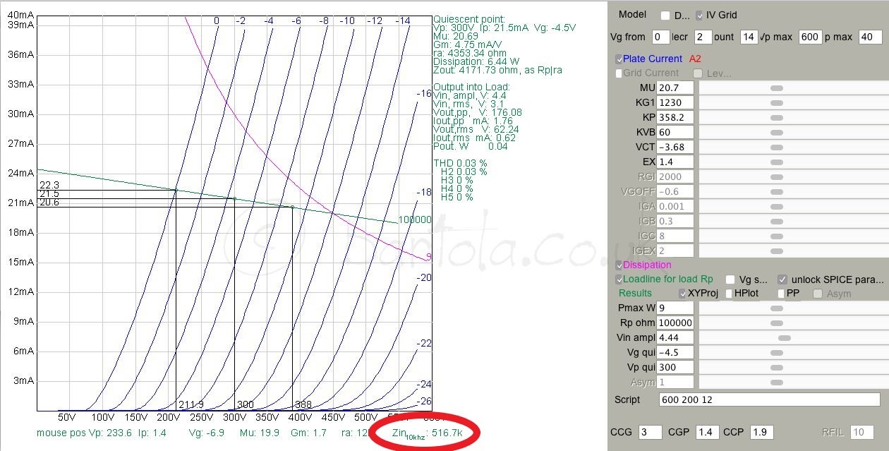

https://i0.wp.com/www.bartola.co.uk/valves/wp-content/uploads/2019/03/EML20A-driver.pngBut where is the transfer graph You refering to?
Sorry, I previously read the #45 data.
EML20a:
517k impedance at 10kHz results about 30.7pF input (Miller) capacitance.
So, it looks like the 20B will be a fine driver tube. I will go with it.

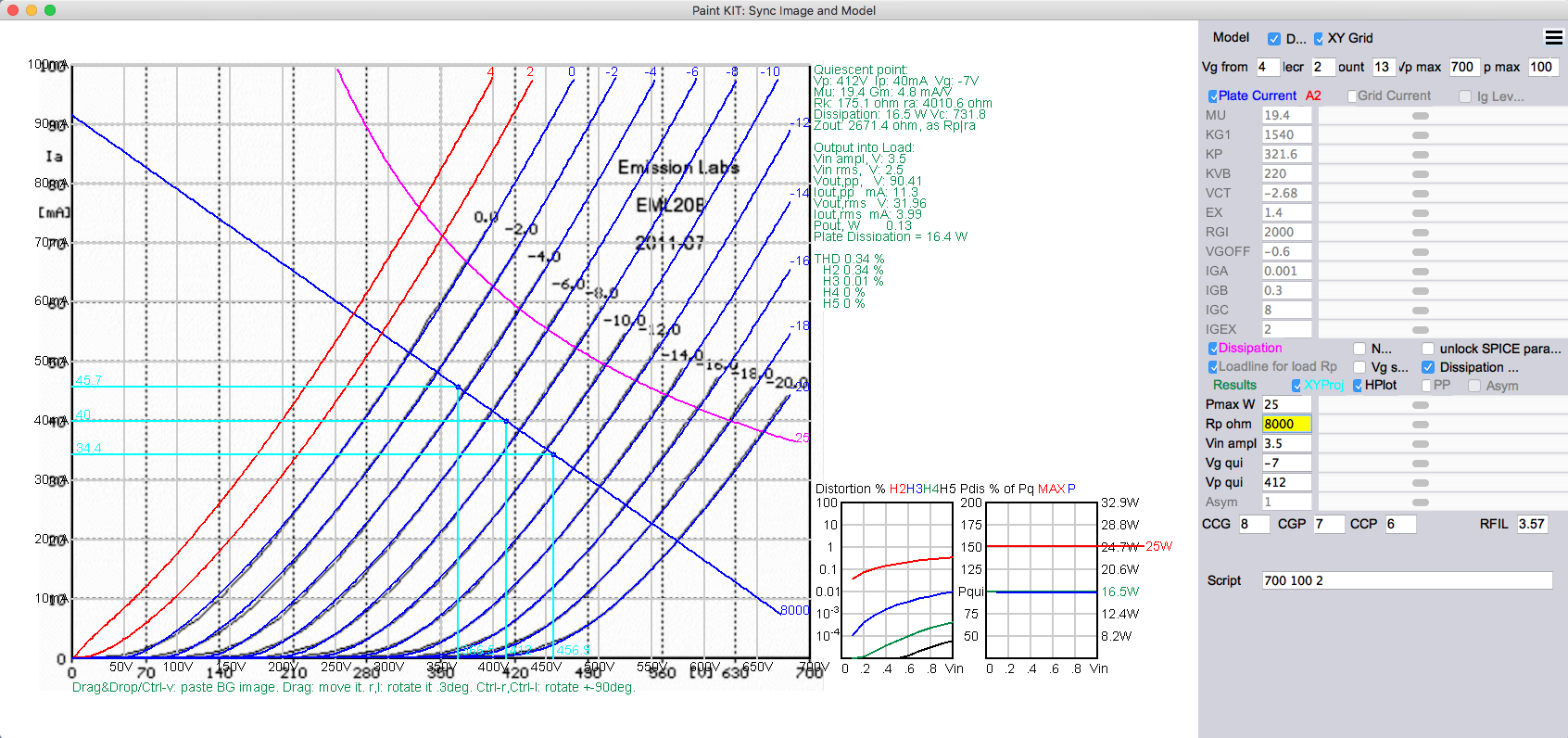

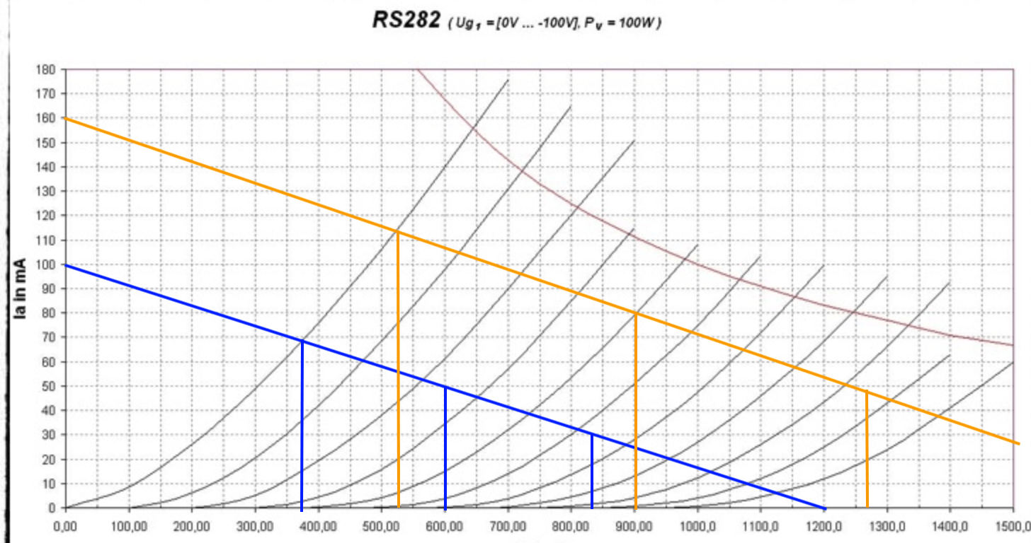

Here is one of my final questions: For the RS282 output tube. I would prefer to use 600v instead of 900v? Why, two reasons 1) my existing chassis supports the 600V transformer. If I were to use the 900V power transformer, then I would need to. modify the chassis and 2) If I use 600V on the RS282, then the same power transformer with less voltage drop would be used for the driver tube. So, assuming 600V @50mA Ug=-25V (see attached, blue lines), what would be the expected output watts? My math goes as follows:
480Vpp/1.41 = 340V
340V/sqrt(9.6K/8)= 9.82V
Pout = 9.82 * 9.82 / 8 = 12W
Does this look right?

Wrong.
Double wrong.
If you choose 600V (615...625V B++ depending of primary DCR), 50mA operating point at -about- -25V grid voltage, the "upper" swing peek will be at -50V, not -55V.
The anode swing will be about 420Vpp.
The RMS value of this voltage is 148V.
The secondary voltage will be 4.27V RMS, so power 2.28W.
The simulation is more pessimistic, only 1.94W (due to the OPT losses).

Well, 2W is not what I have in mind. So, the highest voltage I can achieve is 900V. @50mA Ug=-45V gives 870Vpp. RMS = 307V. 307V^2 / 9.6K = 9.8W

Sorry but no,https://i0.wp.com/www.bartola.co.uk/valves/wp-content/uploads/2019/03/EML20A-driver.png
EML20a:

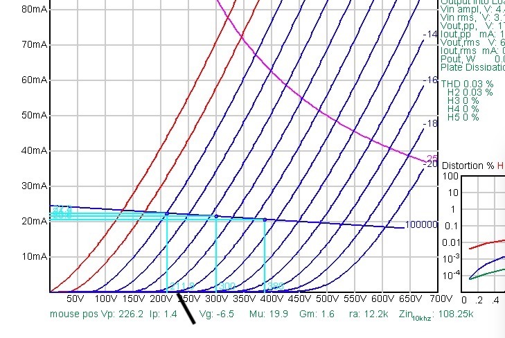

this is the position of cursor datas.
I just checked with same spice model on Tools software.
marked point close to the X axes in -6.5V refion.
With a same spice model
And not even in the working point of tube...
BUT
I changed values of capacitances with a different result.
Please take look
Batola most ligtly leave default values of initial capacitances in tools software on oppening.
CCG=3P CGP=1.4P CCP=1.9P
i put capacitances to more realistic values but very say "random"
CCG=8P CGP=7P CCP=6P
Found some datas based on Pa beause of the size of anode and similar heating values
but 20B has significantly higher mju factor, that implicates to more dense grid layers, closer to aeach other and more grid surface?
So the capacitnaces from grid to othet electrodes can be higher?
I dont know...

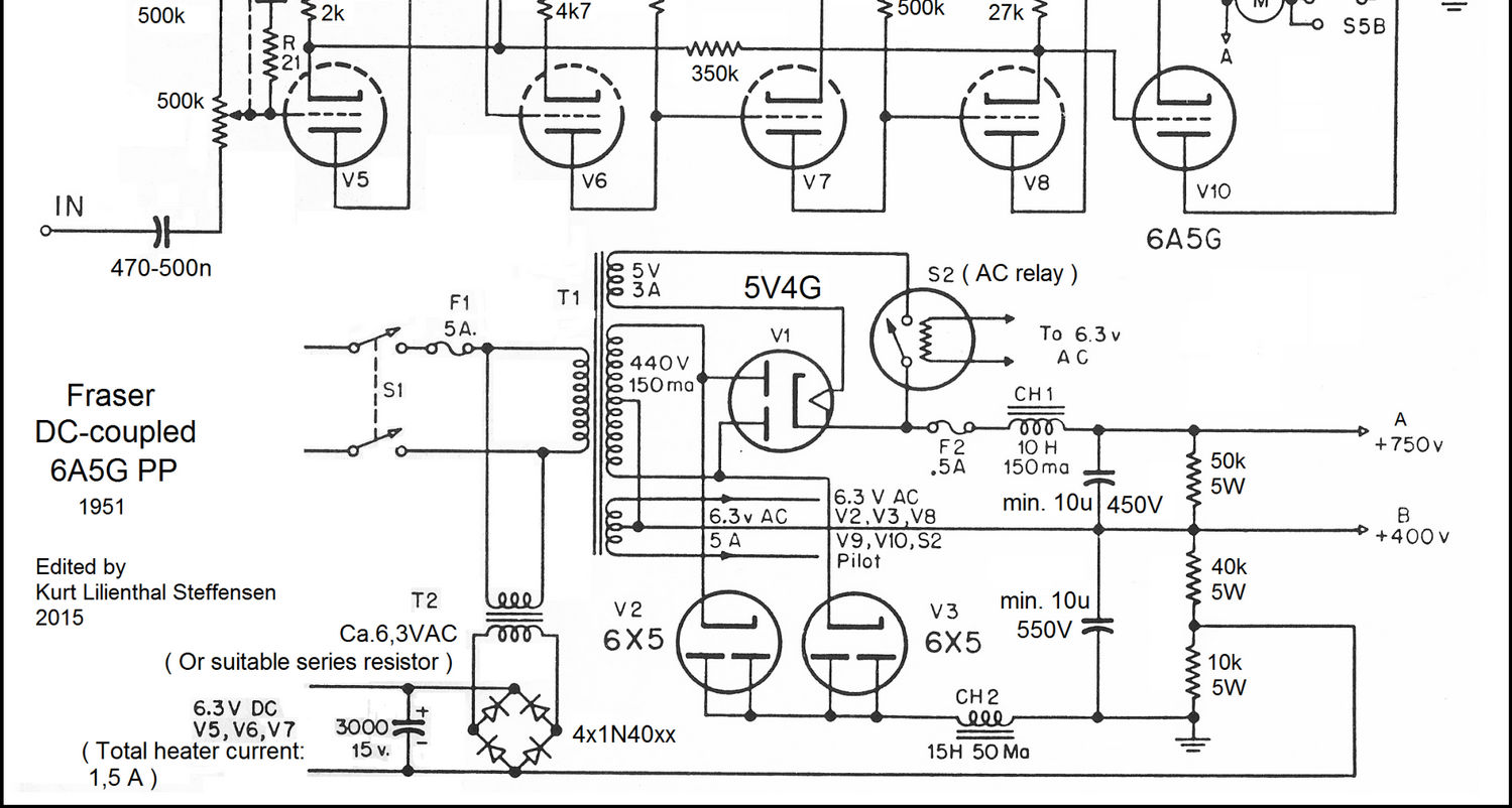

As I wrote in #7 post: voltage doubler.1) my existing chassis supports the 600V transformer. If I were to use the 900V power transformer, then I would need to. modify the chassis and 2) If I use 600V on the RS282, then the same power transformer with less voltage drop would be used
Read in this topic #35 post:
https://www.diyaudio.com/community/...led-300b-push-pull.311357/page-2#post-7677221
Voltage doubler from '51.
Use similar with existing PT.

This is how approh. RS282 will behave in Your available vorking power supply condition, with existing output transformer of 9.6K load.Well, 2W is not what I have in mind. So, the highest voltage I can achieve is 900V. @50mA Ug=-45V gives 870Vpp. RMS = 307V. 307V^2 / 9.6K = 9.8W
Static simulations are about 6.9W with old school THD=5.17%
These 900V limit implicate fixed bias opperation, and Vdc drop @ Rdc primary of OT...
So that is one additional negative power supply and pair of quality high voltage Capacitora at the very input of RS282
But this is staic only, without dynamic sims and without losses in the OT transformer.
This is also with abstract undistorted input, in real circuit, the input to the tube wil have some distortion, slight, but will have
and this will be significantly higher in conjuction with RS282.
I spot that even with very low ditortion of RE084 RS282 does not react good in THD way... Even if I put the Ri of the RE084 as source generator Ug... I will emulate with 20B...
