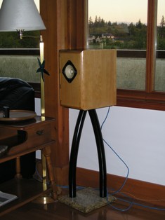

If a Fonken is built with a round-over instead of the champher, the port length needs to be adjusted. As well, to get the same diffraction benefit a 2" radius round-over is required.
Scott, did you get these things fixed up -- did you manage to repair them after the crack developed? It would be a shame to not keep these beauties playing on.

Hello David:
Yes, I did adjust the port length, good point to highlight. A round over of greater than 1 inch is a bit beyond most common shop machinery. I am not sure what the difference in ripple would be. I just like the presentation of the round over even if it is a bit of a compromise.
I have not been able to find the time to get back to the audio side of things for a long while. It seems the list of priorities and other stuff gets longer rather than shorter. I do intend to complete a few projects this spring. Maybe I can get the cracks worked out of these boxes.
