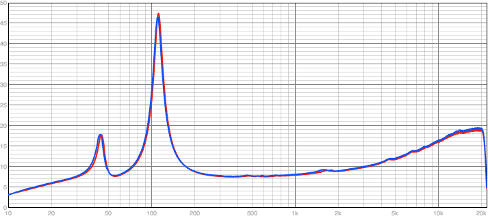

The holes in the holey brace are random... you just want to try for 35-45% holes and no big ones between the driver and the back wall. The driver cutout is left to the builder as any rebate on the front will affect where it needs to sit (driver wants to be tight up against the brace).
Bass on the Fonken is estimated to get to the low 60s (based on listening and the impedance curve)

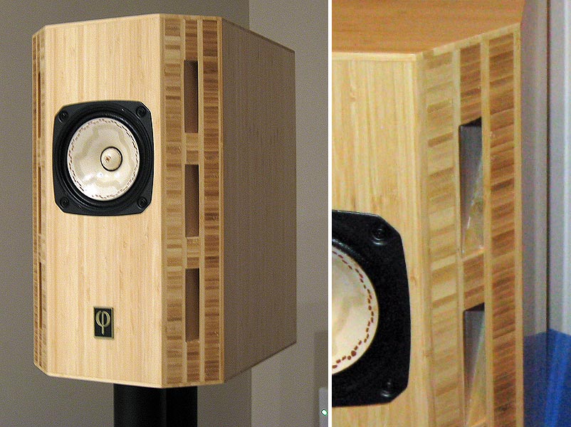

Scottmoose said:That thar be bamboo ply I see. 🙂
pictures don't really do them justice.
dave
I can imagine what they're like in the wood, as it were. The contrast between the face & edges is great.

serenechaos said:Wuz gonna ck emails & table saw up some Baltic birch.
Now I gotta try to find bamboo.
A sheet of Bamboo might put you into sticker shock. And it is not anywhere near as forgiving as BB during construction... this one was an effort to use up scraps after a couple sets of PAWOs.
