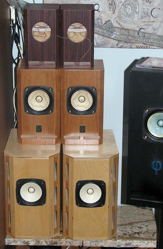

Dave will doubtless correct any of my mistakes here...
In descending order of size (leaving the bipole & floorstanding versions aside) we have
-GR Fonken
-Fonken (FE127E) and miniOnken (FR125)
-milliFonken (FE127E)
-uFonken (FF85K) -can't find the correct character, because I'm thick, so I used the 'u' character as a substitute)
Any more info on the µFonken?
A link, dimensions, FR?
I'm guessing the regular Fonken is closer to "full range," and the µFonken has more extended highs but needs a sub?

It's specifically for the FF85K. No links, dimensions etc. yet. The cabinet is being prototyped at this time I believe, or very soon. Dave & Chris are very careful -the lengthy development period of the milliFonken (still not officially released) is testament to their care.

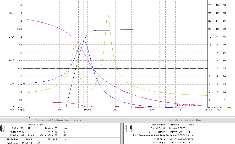

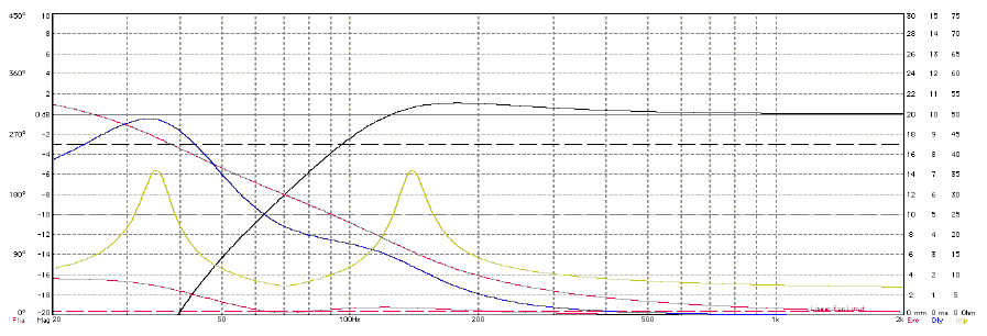

µFonken is about 2 litres net volume. Bass to 100 Hz but at levels limited by the xMax. To get to the same place with the FE83 or FE87 required an mFonken size box so why use one of those when yousqueeze an FE127 into that size box. mFonken is about the size of the LS3/5A (but better). Doesn't go much lower then micro but with more level,
mFonken is ~14x24x18 (wzhxd). µFonken 12x18x15
µFonken was originally targeted as a hiend computer speaker, but given its better than we had hoped for performance, we are going to be putting more effort into getting woofs to work with them. The biggest issue is likely to be XO. Something like active 2 or 3 order LP + a PLL 1st order might well end up working best.
We hope to make the SDX7 work with them as it is well suited in terms of box size & is relatively cheap. We'll likely also try others including some of the Fostex woofers.

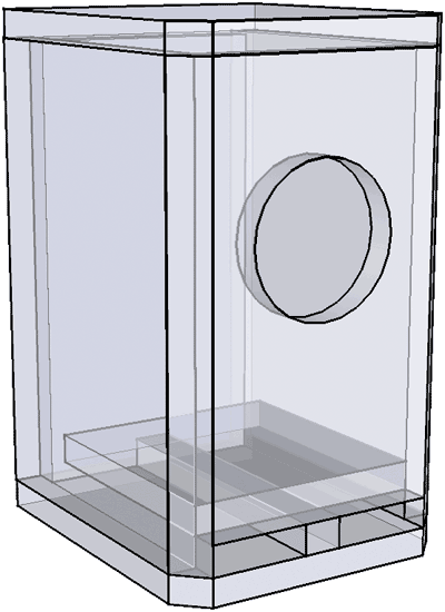

I've been trying to train Dave to use mm only ( it can certainly get confusing when dimensions are not fully notated) as the need for us to use metric in the first place is the European origin of the panel saw and CNC router sometimes used to cut or machine our parts. Regardless of the measurement convention on the shop drawings or AutoCad programs, all dimensions are translated through several layers of CADCAM software to each machine's native OS in millimeters only.
To clarify, when using 12mm (indeed slightly less than 1/2"*) Baltic Birch plywood, the external dimensions of the little microFonkens are 126mm W x 218mm H x 140mm D (add a mm or so for veneer on all sides, and you've still got a tiny enclosure. Installing the internal felt damping material is enough of a challenge before the box is together, unless you've got really tiny hands, don't even think forget about it trying afterwards - that driver hole is only 3" diameter.
As the above dimensions or those given on Dave's drawings are contingent on arriving at optimal internal volumes with the specified material thicknesses, recalculations need to be made for thicker stock.
For example the last 2 pairs of plywood Fonkens were made with 15mm BB ply, with 18mm front baffle. The bamboo pair were made with off-cuts of 3/4" material for all the external panels (the internal slot divider and driver brace remained 15mm BB), so the resulting enclosure is approx 6mm wider and taller, and 3mm deeper.
As aesthetics required the side bevel exposes the full thickness of the outside panels on the bamboo boxes, this also results in a wider chamfer than with 15mm. If you're using regular BB, and intended to paint or veneer the boxes, that latter step would probably not be necessary.
