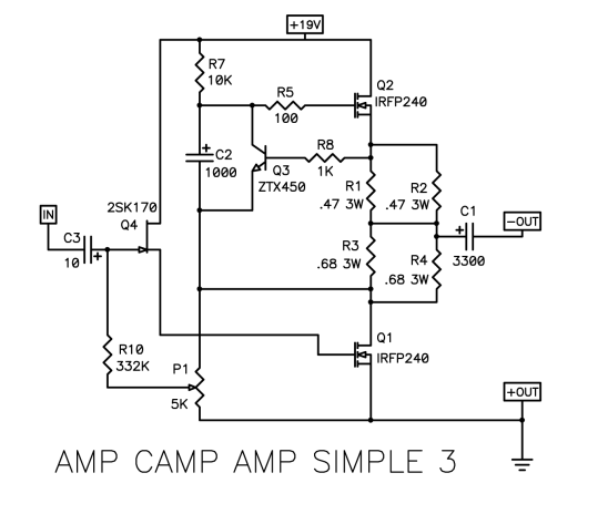

Yup, as ZM says, that looks like the baf 2015 amp without the trafo. Very cool indeed!
BAF 2015 had no output transformer, it's a common source mu follower, as is the Singing Bush.

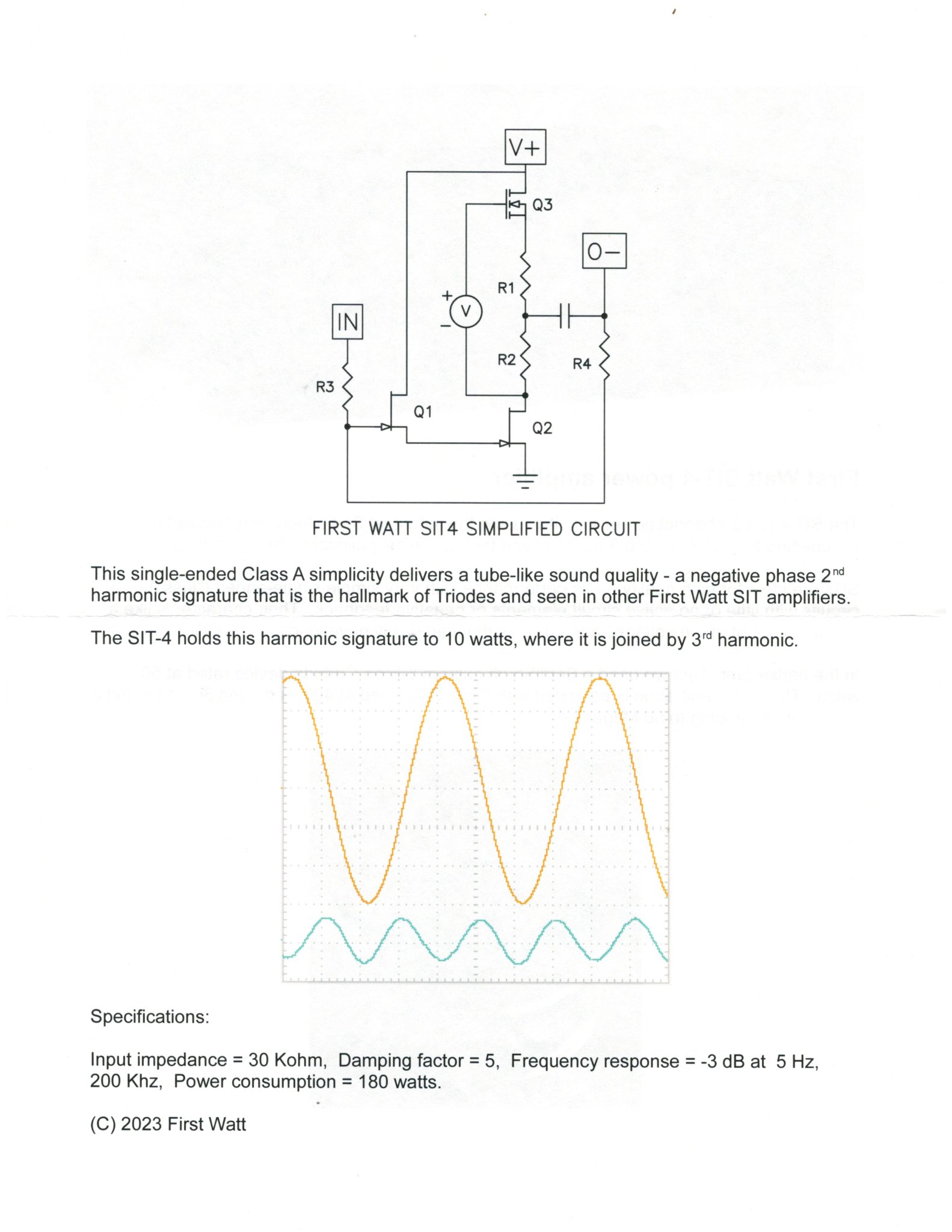

I'm confused about the source of Q1, presumably a N-channel JFET, ending up at the gate of Q2, presumably a power VFET/SIT. Does that require a gate current to work?
that's "simplified circuit"
see as example, ACA simplified circuit, Article page 4/10
https://www.firstwatt.com/pdf/art_amp_camp_1.pdf

and remember, SIT being depletion mode part ( gate needing to be lower than source, voltage level wise) there must be few funny quirks or two, in full schematic
somehow I have a feeling that quirks are already shown by Pa here
That simplified schematic looks like a ACA with a SIT and GNFB to me. Surely a good recipe. Maybe there are some new tricks in the control of the top FET?
besides fine tuning of ratio of resistors in Mu Follower, I see no reason for any "new tricks"
