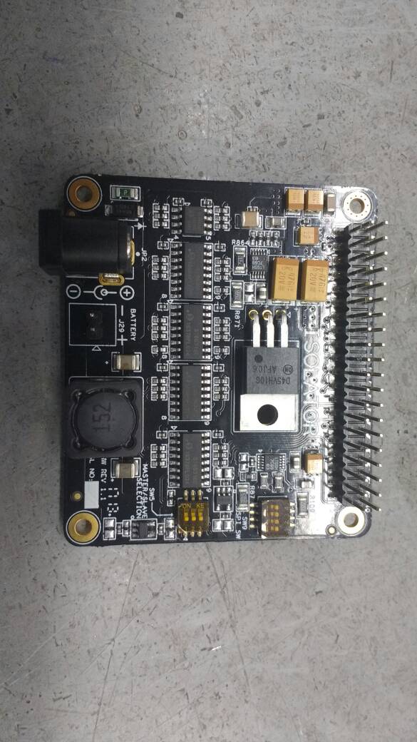

Do you already have more information about the isolator board, some details? When will it be available?
This week I will post some details.
That would be great!
