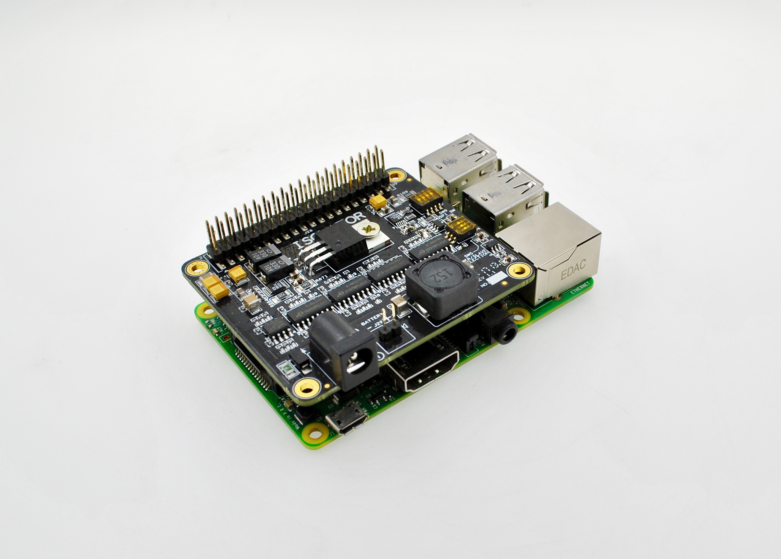

Pics of the testing unit
5.9V is on the high side. I have a diyinhk 0.8uV Ultralow noise DAC power supply regulator suppling a nice clean 5V using the same regulator. Can't I use this anymore? Or should I power the Kali direct and leave the power jumper of the Kali? This way only using the ground separation of the isolator board?
The isolator is meant to give the best power to above HATs. It needs to be powered (cannot take power from above hat). Of course you can power your Kali independantly or your dac as long as you dont feed power to HATs below
