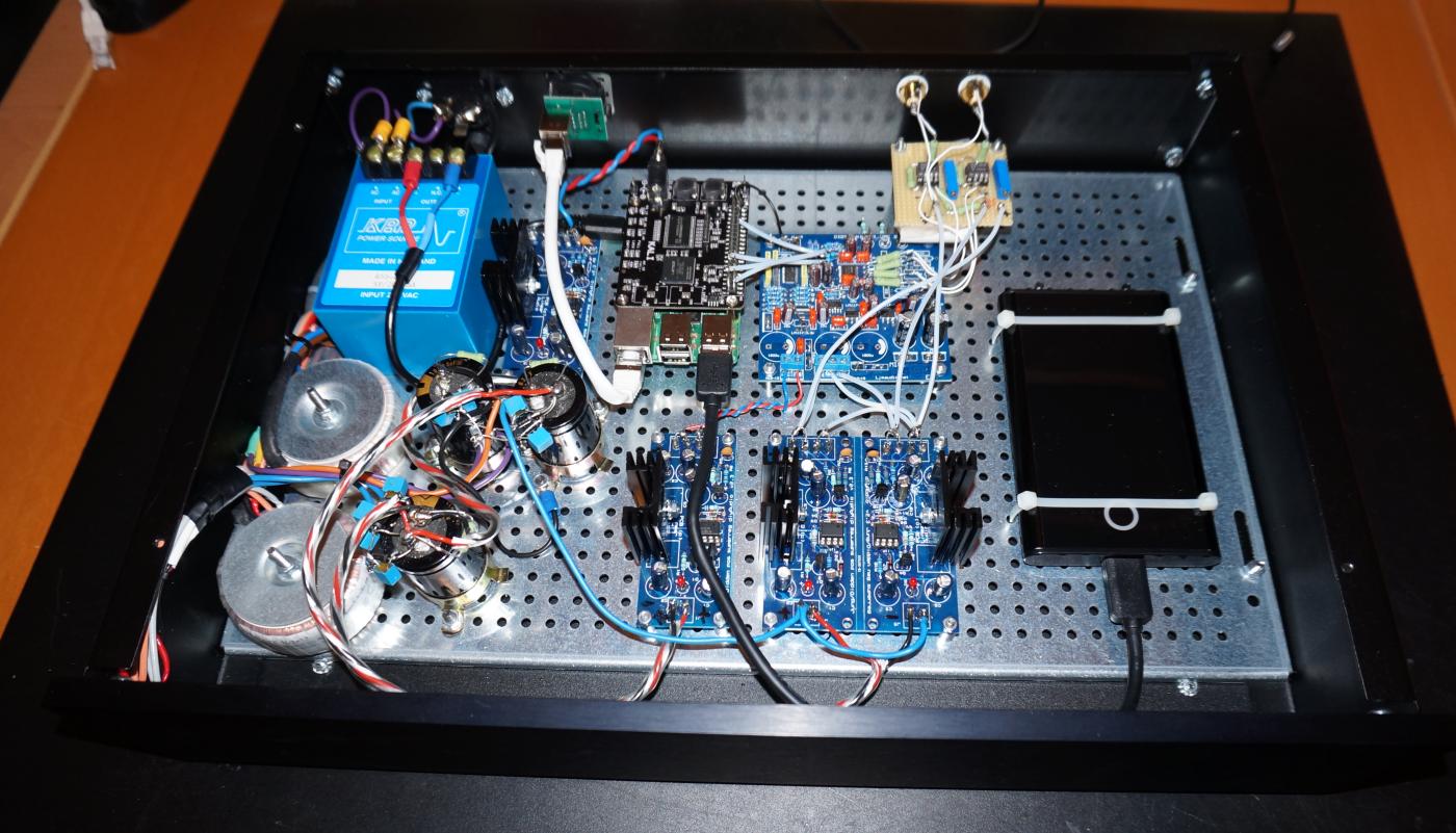

Is there a signal from the Kali reclocker board that I can use to connect to the mute pin of my dac chip in order to avoid cracks in between tracks/albums?
Thanks.
Ronald
I do not mute the DAC. As I said, I had cracks between everything (tracks, albums, stop-start, seek...) until I did 2 things :
- Squeezelite as the renderer in Moodeaudio
- Logitech Media Server Version : 7.9.0 on a linux debian machine as the music server
Oops, did not see your post. Glad you solve the issue.
