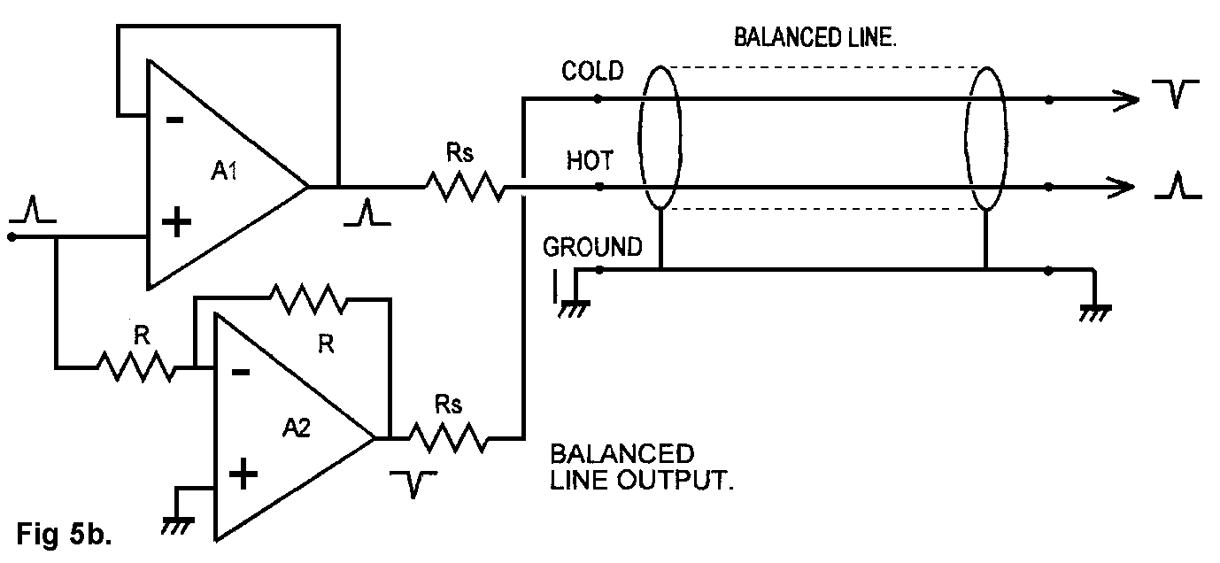

Maybe Mark can tell us if take RCA from the katna to preamp and XLR to amp would help?
You should take the unbalanced out and run it though a balancing circuit like the one in the schematic below. A dual opamp such as LME49720 can work well for that type of circuit. Don't forget power supply bypass caps.
