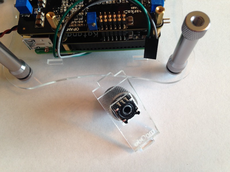

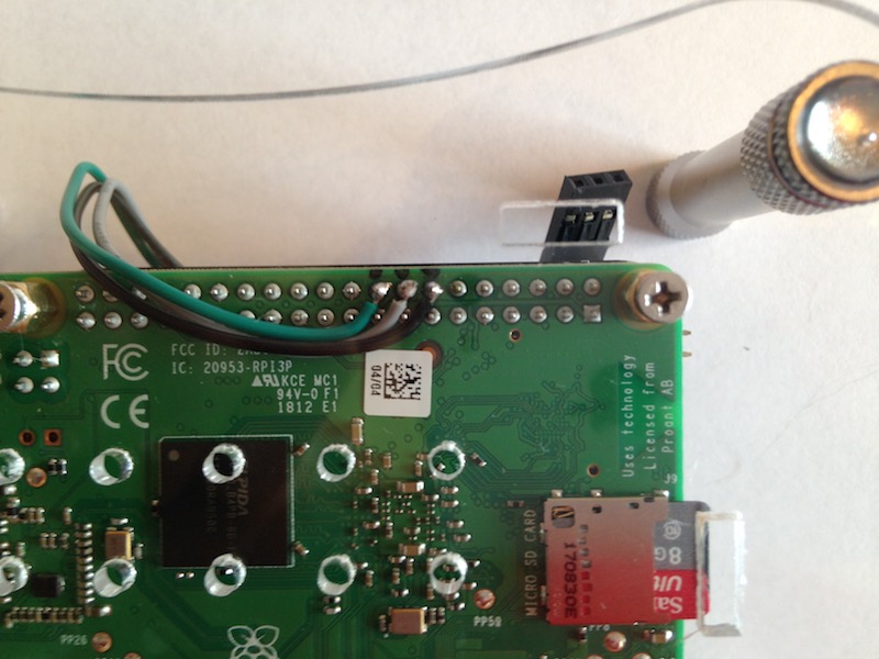

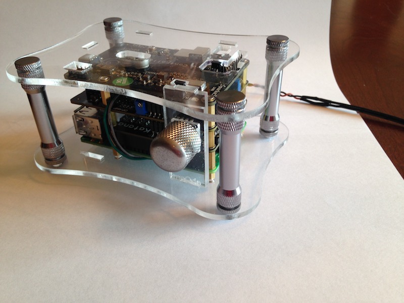

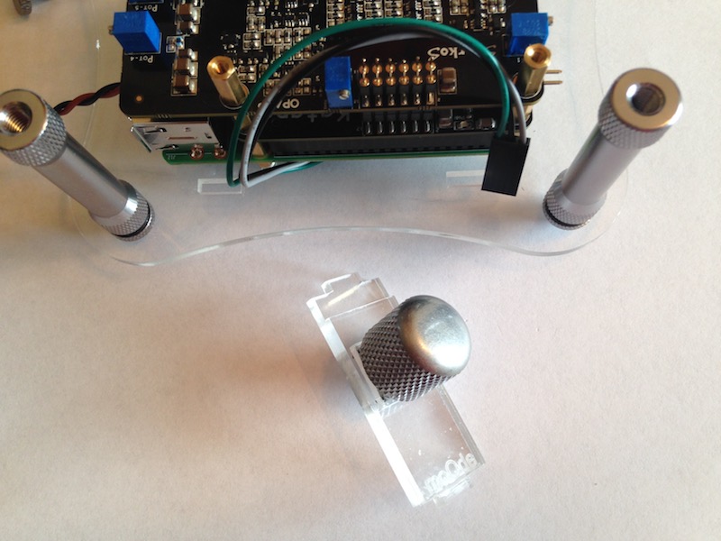

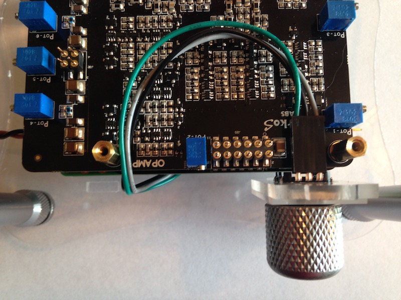

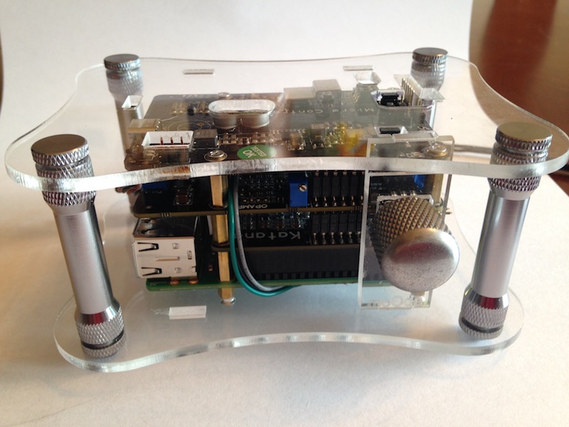

Rotary encoder integrated and making use of the very nice 32-bit hardware volume controller on ES9038 🙂
http://www.esstech.com/files/3014/4095/4308/digital-vs-analog-volume-control.pdf
The mount for the encoder was made out of a section of one of the side panels and a spare part moodeCase front cover that had a double D hole and locking slot for the encoder shaft.
The encoder is an ALPS 688-EC12E2430804 (Mouser) The knob is for a vintage Fender Telecaster.

Very nicely done Tim!
Yep. Looks like a piece of art.
And I really like the nicely bent antennas on the output stage.
These really push the Feng Shui conformity of the whole thing. 😀
And in a world where nobody wants knobs anymore, it's refreshing
to see that some people keep the tradition up. 😀
Enjoy. 😀

Oh dear, I'll twist the wires if it makes you feel better. Watch out for those delicate pins on the output board though, if they get bent they just break off :-0

I was planning to do something similar. I like the option of having a manual control as well - for quick adjustments and to keep the wife happy rather than having to bring up the tablet everytime. I notice that you have soldered to the GPIO on the back of the RPi board itself? I guess this is because there is no access to the GPIO once the Katana boards are in place.
I was wondering about using this...
GPIO Interceptor GPIO Breakout for 40-pin Raspberry Pi – 4tronix
Looks like it plugs in to the GPIO of the RPi but has a side board to allow access to the GPIO pins otherwise obscured by the Katana. I prsume the Katana board can then simply plug into this (with taller spacers). Obviously the whole stack will now be even taller...

Correct, no GPIO pins exposed on the stack but very easy to solder to the pins on bottom of Pi. Maybe in next rev of Katana, Allo will add a connector to one of the boards that exposes GPIO pins 22, 23, 24 and GND.
