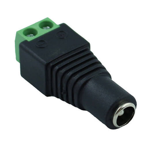

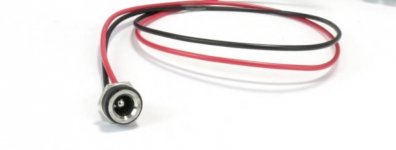

I have no idea how Im going to hook the 3rd PSU on the Katana? Can you recommend a commercial adaptor for the brown and black wire. My Katana is on the way and i cannot find any adptor in the internet. Can you have a picture of how did you guys power the Katana PCB as the 3rd power option.
I believe you can use a DC barrel with screw terminals. I plan to do that, but my boards haven't arrived yet.
