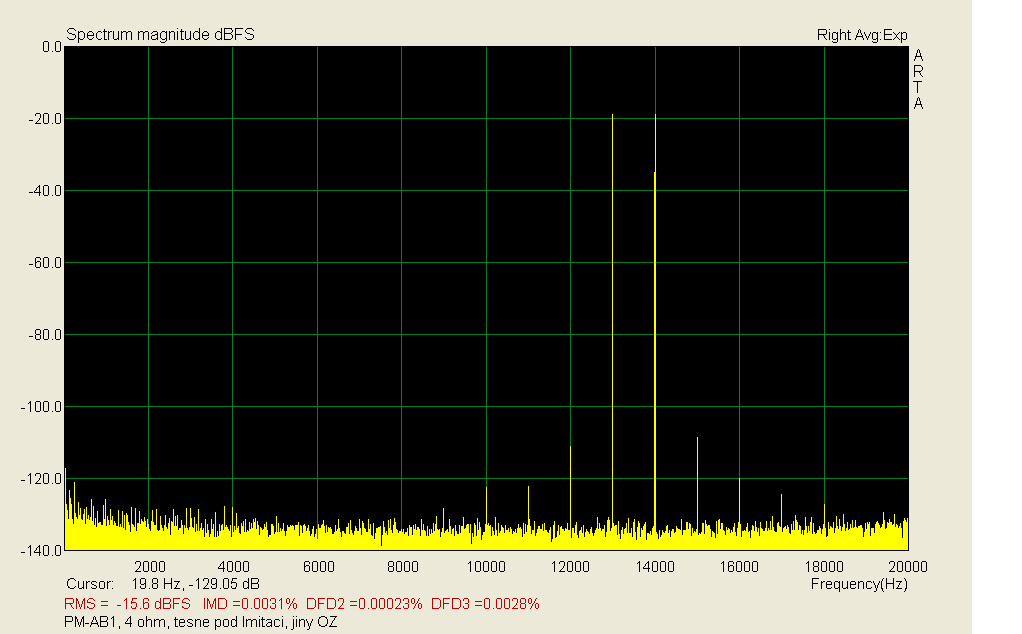

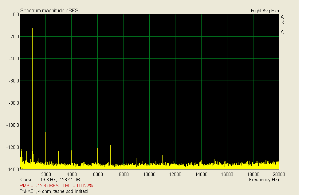

Here are some new measurement results of the 'revived' PM-AB1 amplifier. Distortion is measured close to clipping, at 25W/4ohm.

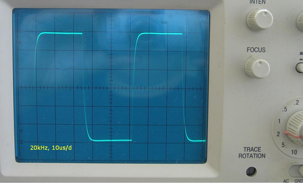

Inspired by NP in a "Hawksford" thread, I have developed a new error correction circuit. The schematic of working amp is attached. I have been testing it for more than a month (both measuring and listening) and results seem to be promising.
Are there commercial amps, where this kind of error correction is in use ?
