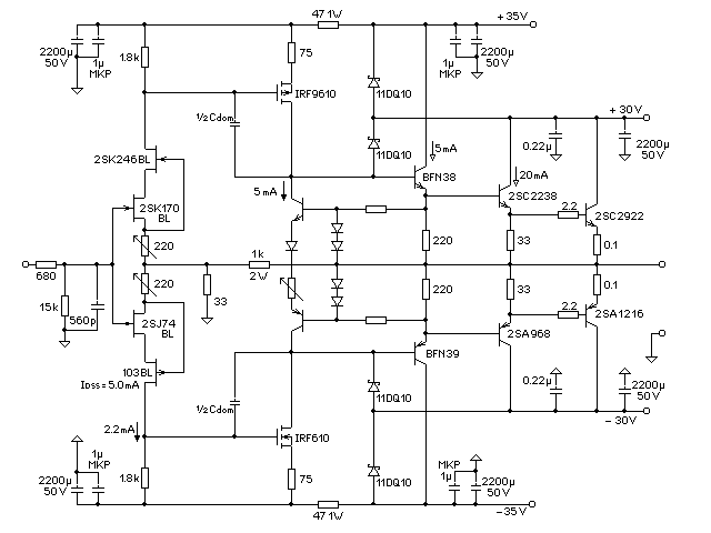

Most probably yes, provided change of resistor values, especially R7. These diodes play interesting role in maintaining thermal stability of the circuit (they are located on PCB, not heatsink).
Anyway - good idea 😉 (again 😉 ), as I have couple of spare PCB's and it is possible to make direct comparison.
A quick glance, maybe if you used a BCV61 and BCV62 dual transistors, you would get thermal matching thus allowing you to drop the diodes with no thermal stability penalty.
