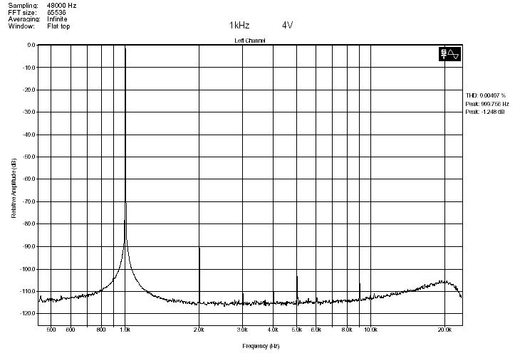

thanh said:PMA!How are 2nd,3rd of your circuit? 🙂
For the circuit without opamp (only output stage with error correction) the 2nd is 0.02% and 3rd is 0.01% (at 1kHz). Higher are negligible (in the order of 0.0001%). With the AD844 2nd and 3rd get to the order of 0.001%.
Hi PMA !
At which outputlevel/load are these ?
And it would be much more interesting to see the levels at 20khz,
as EC is said to be most valuable at high freqs.
Are these measured or from sim ?
The numbers sound good, with tripledarlington (12v into 4ohm,
1-20khz, V+/- = 24v) i get only down to 0.08% and 0.04% (2nd,3rd),
4th = 0.02%, bjts = bc546b/556b , mje15030/31, mjl3281a/1302a.
Values are sim'd, outputstage only.
Mike
Both simulated and measured. Unfortunately I only have images from measurements of the older version of the circuit. Anyway I am attaching one of them (for 8 Ohm load). The distortion did not depend much on amplitude. I plan to measure final tuned version of the circuit.

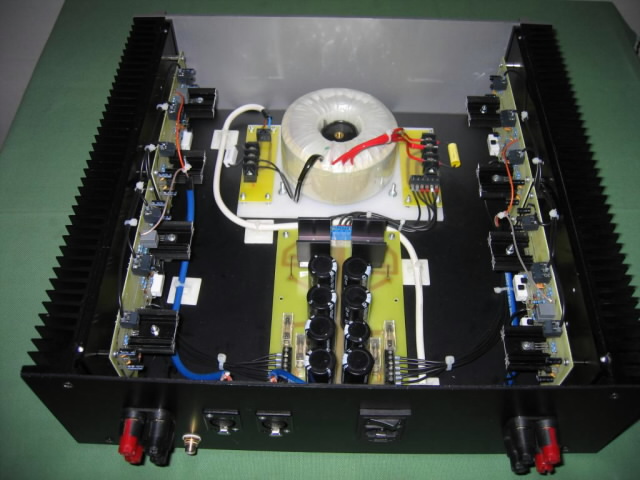

PMA said:Comming soon - fully balanced version of the amp (bridged).
Will be happy to see it!!
Thank you Andrew. I plan it at the end of January 2005.
PMA
I've sim'd your circuit and looked at it closely. It's brilliant! Where do find the time? I see I'm not the only one waiting....
Can be seen here:
- New error correction amp
