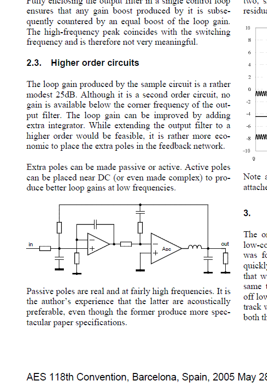

Now, after many changes and improvements (and making it different from UcD too), I'm getting better THD figures and lower output impedance [cut] In my modulator THD starts to rise above 2-3Khz due to loss of loop gain, though.
You mean you have implemented this schematic in attachment, provided by Bruno? 🙂
This schematic was the second thing that I tried to implement after the basic circuit with one passive pole, but any direct implementation just won't work. It does not provide adequate frequency response resulting in HF peaking, it does not provide reasonable phase margin resulting in instability when coming out of clipping (and terrible sticking to the rails due to integrator "memory"), and worst of all, it won't start oscillating easily on input signal zero crossing like the basic circuit (it may never start on itself).
I had to rearrange the existing components, and add more poles and zeros and gadgets, thus making it conceptually different from the figure shown on Bruno's paper, to make frequency response ruler flat and get over 45 degree phase margin at the highest crossover frequency possible, and prevent the integrator from integrating what it shouldn't, thus making it useable.
Bruno didn't like active poles for a reason or two 😉

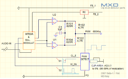

As promised in this thread, I will try to where possible, to introduce some new techniques developed for the MXD amplifier.
Today, the concept used in the show circuit "clips detectors" and part of the circuit that receives signals from the detector.
I think the pic is very clear and simple.
explanation:
detector circuit, Generates two basic signals: S1 (CL_EN), this is normally continuous high state (if level is not in the clip area). goes down for a period equal to the percentage of clips.
the other signal is W_EN. This is repeated always the same and contains two components.
CL_EN windowed and one pulse.
This circuit is not influenced by other factors eg. thermal drift, or when the amp works exhausted.
in the diagram: "Integration & Balanced modulator," I decided not to use old schol as simple pair of diodes in the op-amp fb.
This simple how old system has many flaws, not absolutely perfect for clamp signal, whereas the audio is not a continuous signal at a fixed frequency. Also, the knee of the curve of diode is highly variable with temperature, etc..
So I developed a system that is perfectly in line with the performance of this amp.
considered that an audio input signal (eg amplifier in class D) is under the cycles of the carrier frequency (or oscillation).
Considered that an audio input signal (eg. in amplifier in class D) is under the cycles of the carrier frequency (or oscillation), it makes no sense will continue to work a circuit interposed in the signal path, so I opted for a circuit type "samples & old. "at this point is simple, easy integration with CL_EN signal produces a voltage level proportional to the cycles that is kept in a small capacity (W_EN signal, is used to refresh). reset signal, disconnects this circuit.
benefits:
Absolutely repeatable, not unaffected by external factors.
Adds no distortion in the maintenance phase.
Perfect fast response, related to the transient (loses 30ns)
All performances of this new amplifier are the same as cold as when it is exhausted.
it is obvious that the development of MXD does not stop at two amplifier models. will soon be available for OM (I think within the year) a hybrid with a dissipating surface (vertical mounting with two screws 4MA-18 pin in line). 150 and 300w for high frequency driver. It needs only a simple torus filter and PCB and provides 104dB in range (10-60kHz) without PCB (assembled in a simple fiberglass pre-drilled). This circuit incorporates all the functions developed for the amplifier MXD.
The next, with other concepts used in MXD modulator.
Roberto P.
