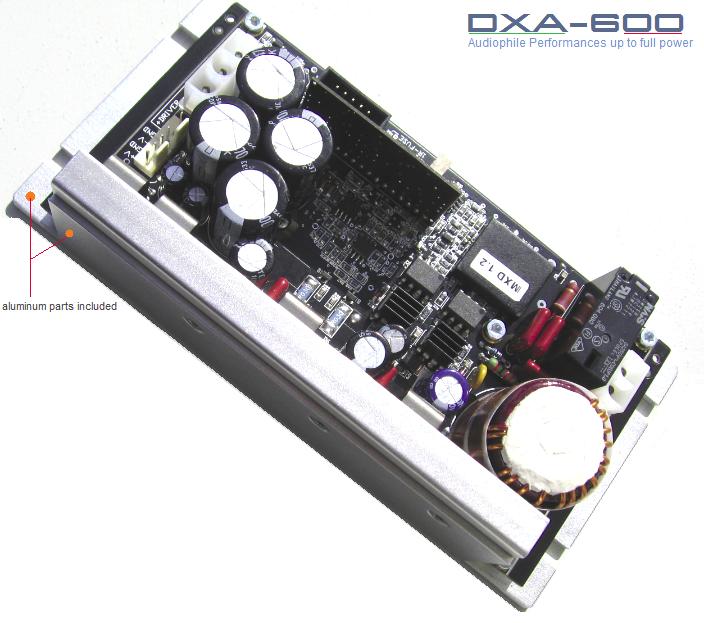

Pic-1-2 shows the behavior of MXD alone, all the control signals to the PRE are disabled.
PRE in original condition (see diagram post) has an ultra fast alc that lets VCA (clip) for only 2.5 ms after this time, hook the signal just below clip. (A variation of the signal re-init this action)
this gives the perception of maximum power output without listening thd.
all implementations are in good agreement with the speed of this amplifier. very fast, as you will see the curve of phase soon.
Regards

thd vs. frequency at 30w 4R
d2-d3 (second and third harmonic)
a short put complete IMD-Test and EMI (irradiation & conduction).
(at 5.5-7,5KHz previous measures are good)

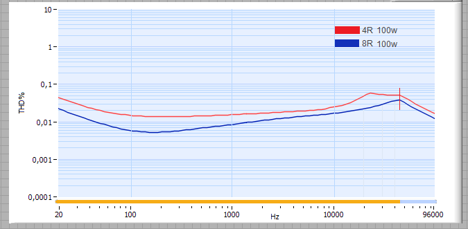

this is thd vs. frequency at 100w (4-8R). (two measures)
sorry but for now I have little time to put other measures and diagrams.
are available for questions.
Regards
N.B. considered that dxa-400 is measured with SMPS (DPS-500) +/-68V.

I see that you are not using AES17 filter which makes the measurement quite impressive. When you have time I would like to see the same measurement at even higher powers.
AP2
yes,this is direct measuremnts for see also at low frequency 10-100Hz.
as I said before, this amp has no peaks in frequency response,
risonance at particular frequencies. This configuration is obtained Thank MXD.
This works to clean up the signal as model (infinite response filter) without being disturbed by the output current (post classic filter Have).
Normally, this measure is obtained at 1 / 3 of maximum power. Whereas dxa-400 is 400W, this is almost right. (At 250w does not change the profile of the curve) only difference in the value thd as (thd vs. Power).
