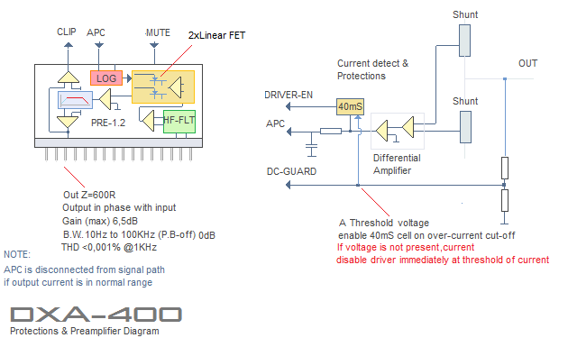

What is the gain of the preamp module? Can you describe the "optional USB2 input"? Thanks.
Hi GLT,
I decided to make a simple diagram for responding to others who have asked me "what has of innovative this amplifier?". I believe that protections are one of innovative and well researched.
Gain for the preamp, if you see the diagram in the first post, the gain loop closed at input MXD. For this reason, the PRE is better than having a low gain.
right to include certain features and adapt the impedance to MXD-INPUT.
(This is very low <600R).
respect to the optional module (DSP), this is essentially composed of three chips.
AD-AU1702, USB controller and external DAC AD1852. (One channel can be used as 2way from dsp).
The reason for this is tied to particular uses of this module and for compatibility with the Sigma Delta Studio software package.
function obtained with this module is that the PC can see the amp as an audio board out devices (USB2) directly up to 192KHz.
main reason for this module is also able to connect a wireless-usb directly to input for other uses.
basic option is (PC see amp as Out audio devices) (module includes drivers for window,xp,vista)

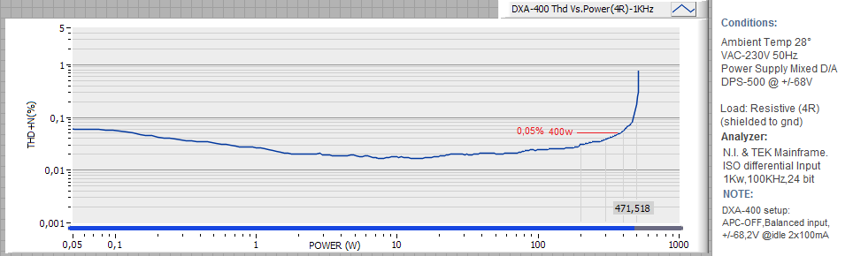

this is the curve of THD + N Vs Power DXA-400.
as required by ticksNLeeches, short put curve phase and output impedance.
also the curve vs. power especially in the stretch near the clip is clear that the drivers work and the modulator (enter a short delay), so can thd lowest when the percentage of modulation is greater than 90%.
This measure reflects the work that has been done to achieve the goal ... a very fast amplifier with excellent performance without the intrinsic defects of class D.
also have a good amplifier thd already increased to 10 KHz, this corresponds with the increase in phase delay. Higher speed = ( more high definition audio high frequency, low THD at high modulation percentage, the less delay.)🙂
