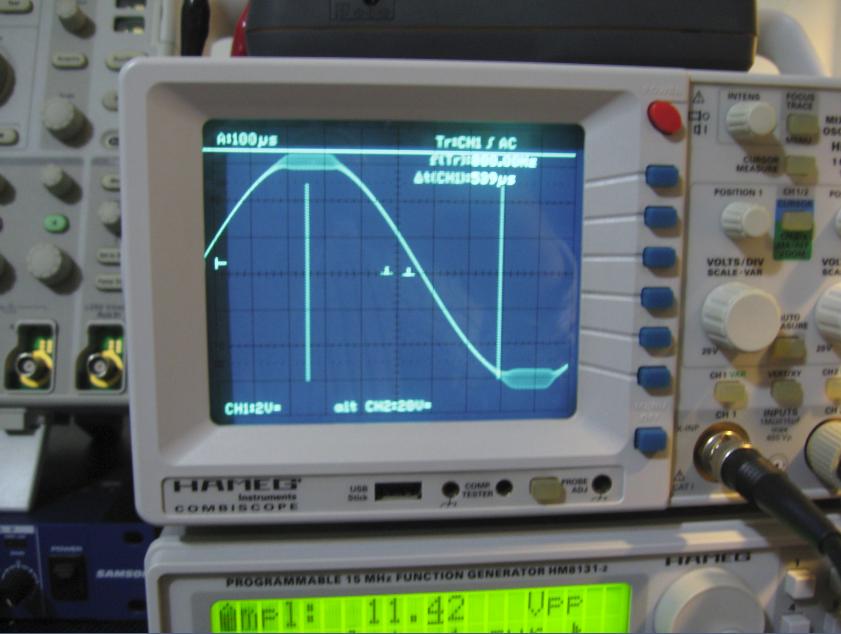

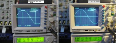

BTW, is it possible for you to show how it behaves when it clips without load? This is the most difficult state for any class d amp with feedback.
hi,
ok, short put the measure you asked me.🙂
Regards
I would also like to see this 😉
S
This is a measure of DXA-400 at CLIP (load / no load).
yes, 8R/Open change 60mV....Damping is good.🙂
what behavior you expect?
Smoking does not load at clips?
Instable at clips?
then what am I developed two years? amplifier equal to others?
Regards
Instable at clips?
Regards
I understand, without an explanation of the new MXD, this measure makes no sense.
FB2 (I call this Erroneous) It Is Necessary inform the MXD-on component audio output.
This Is Not intend as normal feedback, not patched on signal.
amplifier behaves very differently because it is different.
Regards
Regards
AP2
The amplifier is still switching when it is clipping. Of course this is a simple way to avoid frequency drop into sub harmonic oscillation but you loose a lot of efficiency and you also loose voltage head room which might require you to select higher voltage graded components. There are several makers on the market that limit the modulation depth to around 90% to keep the outer loop stable so this does not say much about your actual modulator. I would like to see the amplifier going into "real" clipping where it stops switching. Is this possible without too much hassle?
AP2
The problem is that you want to see what there is in this amp.
modulator has no limiter because it is a dirty solution, you can not keep the distance between rails and vcc treshold(it is variable), then would lose much efficiency.
I now have a probe connected to + Vcc, PSU is now + /-68V.
where is the loss? No-Load With APC disable, this is the maximum modulation. switching frequency not stopped. I can not explain what is in MXD.
remains the fact that DXA-400 has an incredible linearity (see thd vs.frequency and vs.power)
Also is indestructible. thd not at full power, 110dB SN with 60 KHz of bandswitch... is enough?
N.B. This condition is not normal because i have switch-off APC on modulator.
Regards
