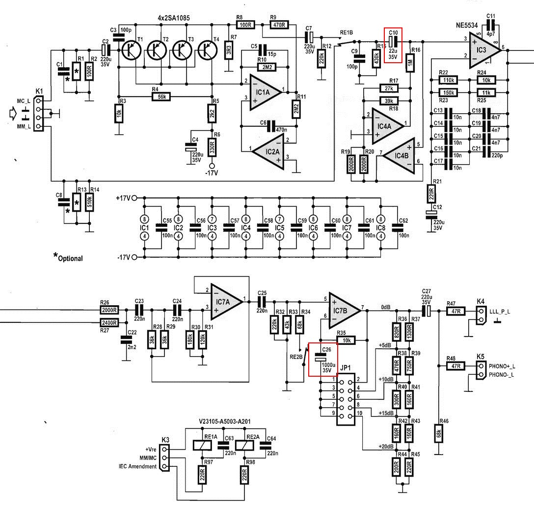

Hello everyone!
I want to make the party phono MM and I drew a circuit accordingly. I just have a little problem on the size that some capacitors (circled in red in the image).
My question: These two capacitors are 35V voltage isolation but with isolation voltage of 25V is suitable?
Thank you!
Yes, The power supply is only +/-17 V, so 25V capacitors are fine.
You might consider non-polarized electrolytics. They are thought to sound better,
and the polarity of voltage on those caps in your circuit can vary.
Also, have you considered using a ground plane?
for an audio coupling capacitor, it is important that it is able to tolerate both -ve and -ve bias during variations of the signal.
It is reported that distortion due to the electrolytic is reduced by using back to back electrolytics.
This applied to both back to back polarised electrolytics and to back to back bi-polar electrolytics.
In order of reducing distortion:
polar electro, bi-polar electro, back to back polar electro, back to back bi-polar electro, MKT film type, MKP film type.
The back to back bi-polar perform almost as good as MKT when used as a filter.
In audio coupling duty, the caps do not operate as a filter of the audio frequencies. The distortion reduces massively for this duty. I suspect that had the measurements been done where the RC was only filtering the sub-audio frequencies, that the author may not have been able to measure any audio distortions. His equipment had to be developed (extensively) just to present the higher "filtered" style distortions.

Consider using radial Nichicon NP electrolytics designed for loudspeaker crossovers. A good example is 10uF at 100V. Higher-voltage NP electrolytics tend to introduce less distortion. I discuss this in my book and show measurements.
Bob

I have also shown by measurement that a higher voltage rating on NP electrolyics decreases their distortion contribution. Nichicon NP electrolytics designed for loudspeaker crossovers perform quite well.
Bob
