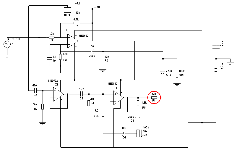

Has anybody simulated the Mr. Self's precision preamp linked by Mooly?
I need to build a preamp and Mr. Self's tone control with variable frequency seems almost ideal for my needs, so I've trying to test it by using Simetrix and I've found an error 😕 in the resistor which produces the attenuation that finally provides the maximun boost or cut (R8 in the following picture).
I guess I can upload the schematic used in the simulation, as it is just the HF tone control section and its frequency response:

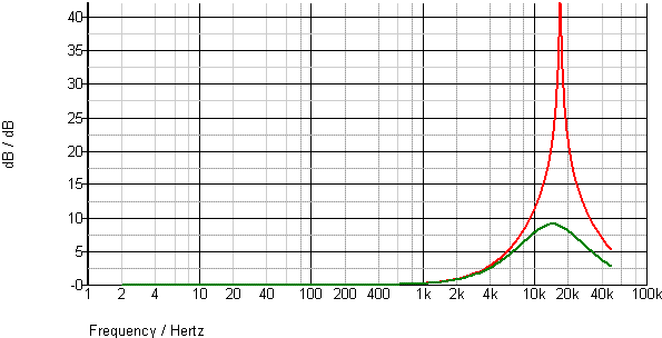

As can be seen in the pictures, when VR1 is set to maximun boost (or maximun cut... its the same thing) the frequency response gives a huge peak (the red curve) at the frequency selected by VR3. However, the behaviour of the tone control is as specified if VR1 wiper only moves between 20% and 80% of its full span.
The problem is related to the value of R8, which is set to 470R in the Small Signal Audio Design book, and that value doesn't build a 9 dB loss as Mr. Self specify. Just changing R8 to 1K we can get the green curve at a maximun boost of almost 10dB as it should be (and the loss will be -8.8dB)
Has anybody verified this error by using another simulator or a spectrum analyzer or something like that?

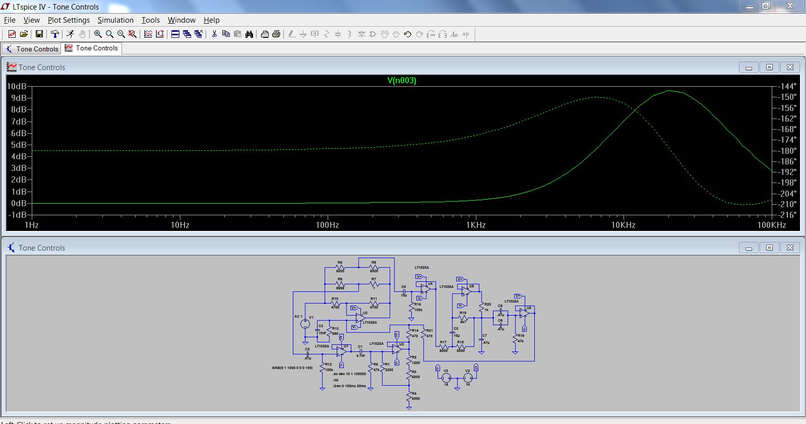

I simulated this design (precision pre-amp '96 from Self on Audio book) a long time ago, using Orcad pspice. I had both the bass and treble sections going. I do not recall that I saw the peaking that you are experiencing.
I have not simulated the design in ltspice(which is what i use mostly now due to popularity) nor your spice tool nor have i built/tested the ckt. I did do a layout but did not fab it. But it seems to be a really nice design and as close as you will get to a parametric(SVF) type design with a lot less op-amps.
Do you want the LTspice file ?
Yes please!!
Thx
Rick
Thx Mooly,
That's great, I tried the original ckt that you posted, using both treble boost/cut at max and it works fine, same as when I did it in pspice.
So must be something wrong with originators circuit or simulator. Don't have the S/W so I have no means to find a solution, have not thoroughly gone over the schematic however, but if he compares against your sch. then maybe he will be able to find the fault.
