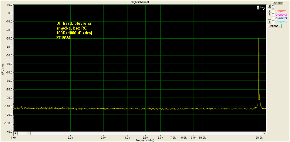

Above mentioned groupbuy of high quality powersupply is still possible. There is a wiki. Jan Didden is making the design even better at this moment.
Good, low noise power supply is highly recommended. I have made both measurements and listening tests with different power supplies, and it makes difference.

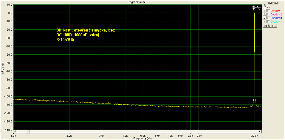

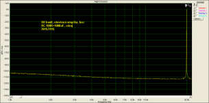

This is best seen in open-loop measurements. I would like to show a difference.
1st measurement, now attached, is Dispre2 openloop (i.e. gain 31.9dB approx) with conventional7815/7915 power supply. Also, 100R+1000uF filter for input stage has been removed, to see the difference clearly.
