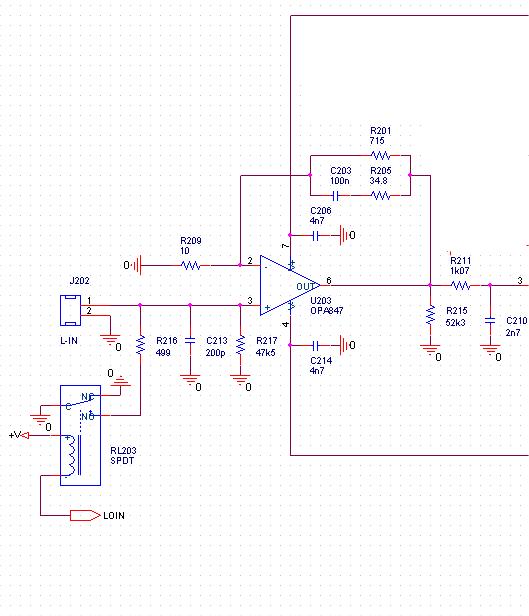

Not anytime soon, unfortunately. Beyond finishing the YAP construction (and the web site) I'm busy designing the layout for a RIAA preamp (with OPA827 and OPA211, to the horror of the discrete fanatics, the prototype beats hands down a pair of input 2SK170 in noise performance, except for very low frequencies). I have a bunch of old vinyls and I decided to get a turntable: a VPI HW-19 MK3 with the MK4 bearing and platter upgrade, an Audioquest PT-9 tonearm and a Benz Micro Silver cartridge. Sounds very good, but this needs a good preamp ASAP and I'm not crazy enough to pay a couple of thousands for a good commercial unit. What I've seen at affordable prices is very poor. I believe in very good opamps, not in a 5532 in a small metal case.
Otherwise, it is really amusing to see how people who claim to hear wires directionality are easily accepting preamps built in bipolar and FET technologies to sound the same.
Since the OPA827 specs at 4nV this will need some explaining??? If you JUST want to talk about noise optimized discrete will always win. .4nV is doable for MC without being too exotic. .12nV could be done with some extreme measures.
Well, you are right about the intrinsic device. But then I refuse to use in the input stage something raw like a common source stage with virtually no significant PSRR. A simple regulated power supply (which I did) adds enough noise to such a stage to make it a poor choice comparing to the OPA827. Of course, something like a Jung regulator (or perhaps batteries, although I'm not so sure about) will make the 2SK170 a clear winner, but i'm not sure I would go for that level of complexity? And adding PSRR to a 2SK170 input stage adds noise as well, or at least I was not able to find a way around. Any ideas how to combine the 2SK170 better noise performance with a decent PSRR?

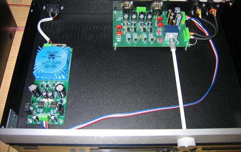

PMA;
Thank you for sharing the interesting listening comparison 😉
It tells me that I (and others) have been right about what really makes a big difference, and what's not. To me this result shows that you get very a long way using common sense, good components (BTJs/Fets/Caps etc.) and good layout.
I have always been able to tell a discrete design from a opamp based one, but has always only noticed very small "maybe" differences between two similar diskrete design with same topologi 😉
This clearly shows that you CAN make a audiophile preamp (like PMAs DisPre II which is my main preamp at this moment) at small costs.
Congratulation, Pavel 😉

PMA said:So, we listened to Halo JC-2 and Dispre II today. It was a very pleasant day with very good components 🙂, good sound and good music.
Taking into account that JC-2 and Dispre II use very different transistors (JFET, MOSFET vs. BJT), have different input and output impedance, the results are MORE than interesting.
Both preamps sounded very similar. There were no bigger differences in their sound. Maybe, maybe Parasound had a little bit more "air", and Dispre was a little bit cleaner. We were very pleased with listening to both, and there was no winner, just music 🙂.

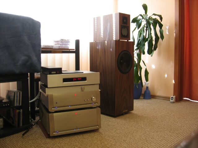

courage said:
Pavel, no offense, but this is not really a detailed description of how listening comparison did take place, what other components/cables were used and is of course heavily biased isn't it?
Franklin, no problem.
CD: LINDEMANN CD1 SE
Link Cable: Andrew Heliax + WBT connectors, 50cm
Preamps: Parasound Halo JC-2, Macura Instruments Dispre II
XLR link cable: NEOTECH NEI-1002 silver, 50cm
Power Amplifier: Parasound Halo A21
Speakers: Nobble Audio Lucid (bass ScanSpeak as in W.A. Sophia, middle and high Thiel & Partner as in Avalon, Mundorf coils and capacitors)
Sigurd Ruschkow said:
When I find that two piece of equipment sound too similar, I start to suspect that there are limitations to my stereo system.
First, not my system in this case. Second, other preamps do not sound similar in this setup.

I got so intrigued, that I have started my own RIAA design. For MC cartridges only, and I plan to use some form of diskcrete input low noise stage. I do not worry about PSRR.
Do you have a link to your RIAA design?
Wow, some really expensive stuff your are dealing with...
You'd better worry about the PSRR if you really care about noise and overall performance.
The RIAA project is in the early stages. I usually don't publish designs until they are not finished and tested, so for the moment here's the OA input stage. It may change significantly during the project lifecycle.
