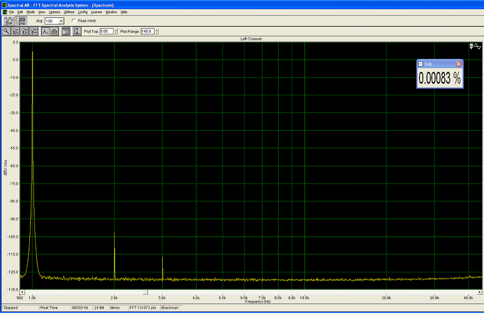

PMA said:As John has already said, power supply is a very important part of the preamplifier.
But Sir, where is the PS? Outboard? Surely the shown PS is just sufficient to power the front panel LED...
PMA said:Prejudice. The preamp excels in solid bass.
