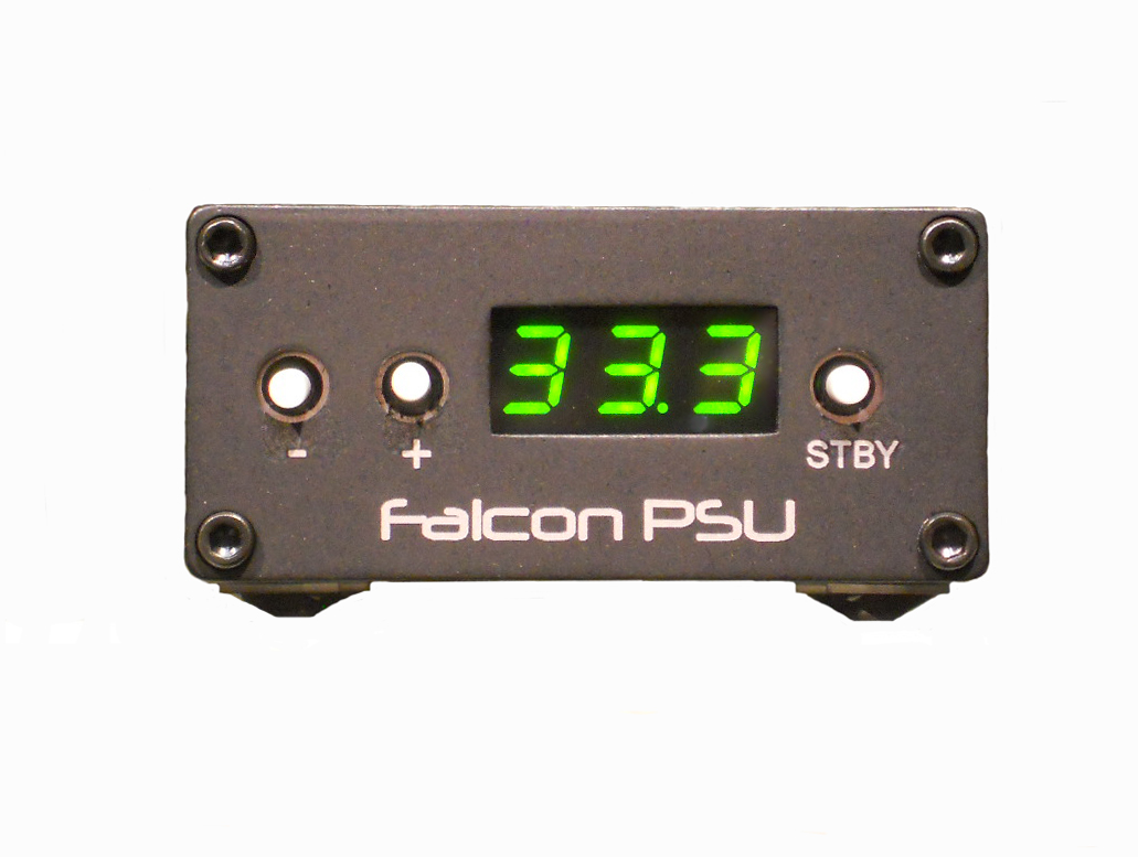

All of the accuracy and resolution in my AC supply comes from the fact that I'm using DDS to generate the AC waveform instead of PWM as Music Hall and Pro-Ject have. DDS has been around since the late 80's but back then, a chip with the same capabilities of the one I'm using would have been ~$80 and housed in a 68 pin package the size of a silver dollar. The AD9833 is $9 and in a µMax10 package, it fits on the eraser of a #2 pencil. Not sure why anyone wouldn't use DDS for an AC supply?
The other thing that sets my supply apart (besides some nice software features) is the power supply and output stage, the latter which doesn't use any xfmrs or coupling caps which is why I can fit it in an extrusion the size of a pack of cigarettes. I believe my supply is the only one capable of connection to a tach as well.
For those of you who expressed an interest when it was available, the PCBs went to the assembly house and I hope to have them back by month's end. I received the metal work for the front panels last week, which I think look much better than the acrylic face plates on the prototypes.
