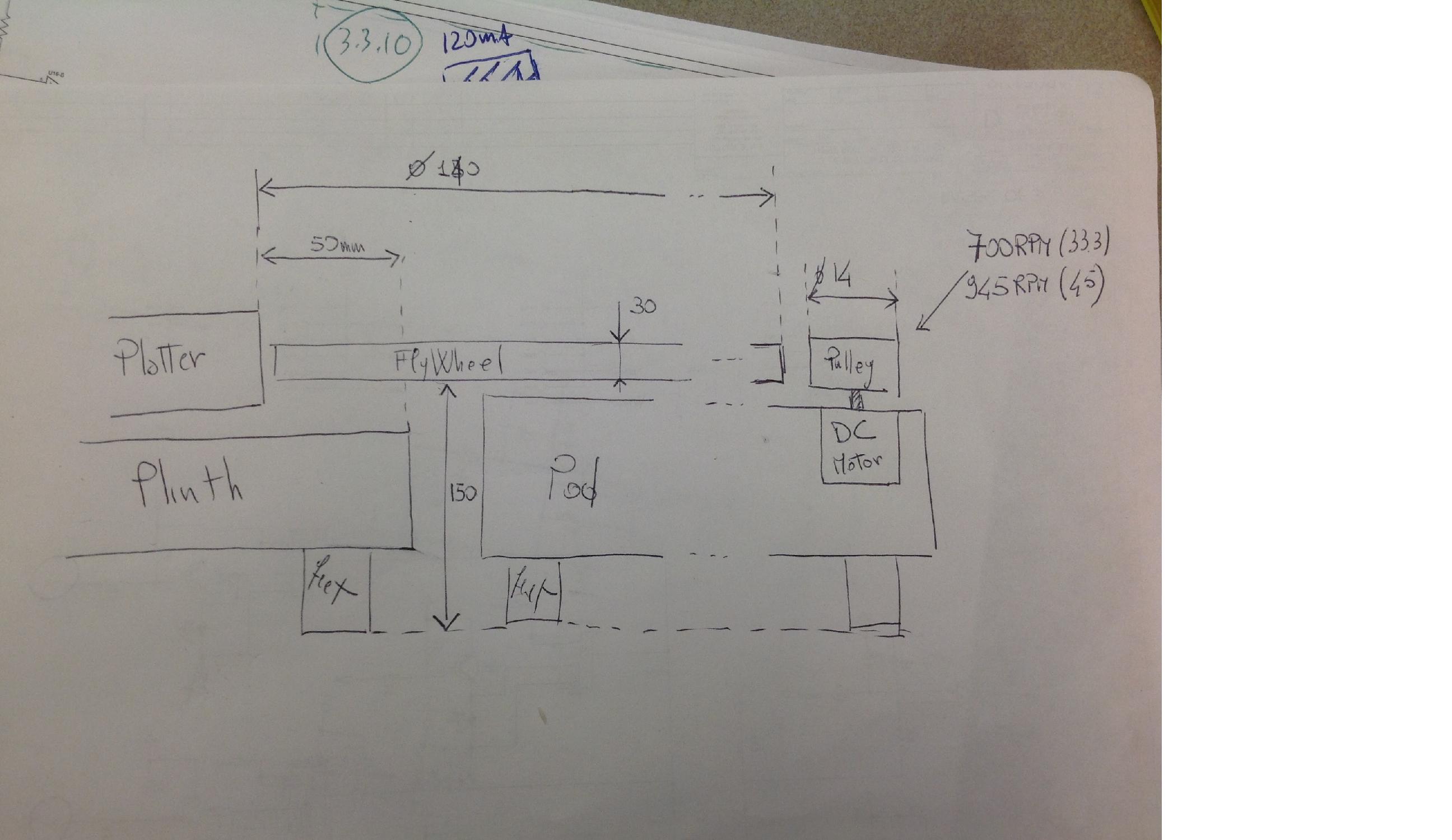

Stefano,
Just reviewing some of the specs for the Maxon motor.
The shaft of the DCX22L is only 3mm and the shaft is 10 mm long. This is a very small diameter shaft. I am sure we can make a pulley, but this is a much smaller shaft than typical motors. Typically the pulleys are secured to the shaft by a simple set screw. I think as the shaft gets smaller this is less effectve and the set screw might even bend the small diameter shaft, ever so slightly. Also, the set screw will tend to push the pulley away from being concentric with the shaft.
The 10 mm shaft is also short. The shaft must extend past the enclosure flange and into the pulley. Ideally the load on the motor shaft should be close to the motor bushings and not suspended on the end of shaft. We may need to extend the shaft with the pulley etc.
Also, the DXC22L is about 47mm long, not including the rear shaft clearance etc. This is a bit longer than most motors and may use up valuable height required for the enclosure, pulleys and flywheels.
After the motor is put into an enclosure, the enclosure has some feet, and then pulleys are added, the height of the pulley drive could be higher than ideal. The motor must also drive the flywheel BELOW the flywheel rim drive and the rim drive should not be higher than the CG of the platter. Even just 10mm in extra height of the motor could make things difficult.

Attached is a more finalized design concept for new drive idea. This should give us all the mechanical basic information to start our discussion.
I considered a 50mm overlap for flywheel to reach out the platter. For example on my classic it is 42mm, so I am giving some more margin to accommodate more tables. I consider therefore 55mm to be what the flywheel will hang off by the pod (55 mm of clearance between motor pod and TT frame).
The assigned diameter for the wheel will be 140mm and calculated pulley diameter is 14mm. This allows us to run the selected motor at 700RPM at 33.333RPM and 945RPM at 45RPM. This values sets the rotation of the motor under 1K as sq recommended.
With 37.3RPM/nNm offers a good figure of 18.7mNm of torque at 33RPM and 25.3mNm of torque at 45RPM.
The low factors of RPM/V allows us plenty of headroom to control the motor.
Please let’s comment on this and see if we need to major adjustments or only minors to this mechanical concept.
Meanwhile, Pyramid and I have been entertaining some discussion on RPM’s optimization in order to maximize the resolution on the DAC control and feedback loop. Therefore perhaps, these figures might need to change slightly but I don’t expect any major change at least in order to run the controller properly.
My concern is to balance the pod and flywheel considering good part of the flywheel is hanging off the pod.
Anyhow, this is my thought: if we make the pod heavy enough to be stable and not being affected by the momentum of the heavy flywheel , we can extend dimension after the motor to keep the center of gravity in a safe spot, so I see possibilities to make these mechanical design fully stable.
I defer all the more specific comments to the mechanical guys and everybody else who wants to share their idea. No idea is stupid, if you have a though please throw it in as even if it doesn’t apply right in the second, might be applicable for other things we will need to get done.
My philosophy is, the more the ideas the better!

Ok, I see your good points. Please take a look at my sketch and point out if there is any gross impediment. I used the height of my TT for reference, which is the very general purpose. Anyhow, the problem I see is to adjust it to different TTs. The feet should be adjustable, or even better feet can come in different sizes for instance, that could be a possible solution.
If this motor is really a problem we can try to find something else. I don’t know, but maxon offers for this motor different options as far as shaft and flange are concerned. I haven’t checked, but I am wondering if they offer a larger diameter. I will chek into that right now.
Please take a look at my sketch and give me some feedback. Thanks Jamie for your contribution, I feel we are doing a very good job so far.
checked. Unfortunately the diameter is fixed and we can only control the length.
I also checked the other motors maxon uses and shaft is even thinner. The "famous" A-Max that many high end manufacturer use is only 2mm diameter.
That said, we have to find a good way to make it work with 3mm.
I am thinking if the hole on the pulley is precise and fits like a glow, then 3 small screws will work just fine, I don't think much
