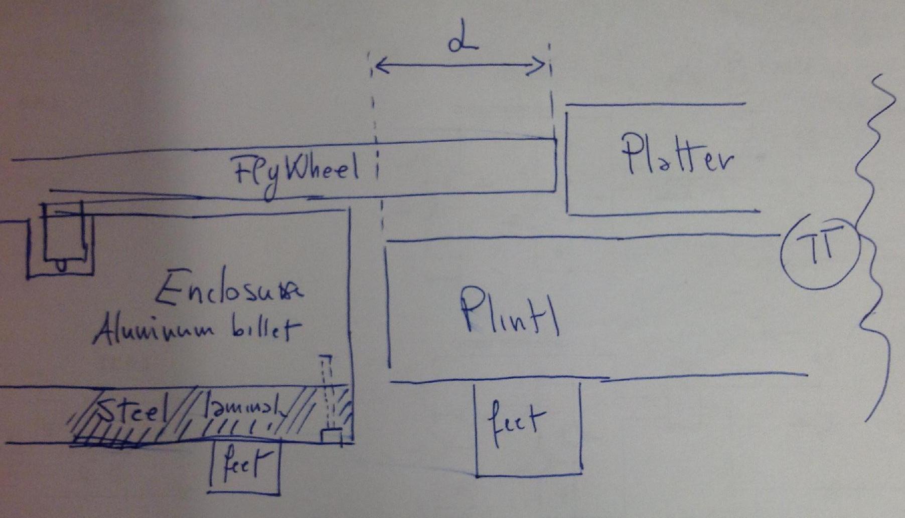

Stefano,
I first want to make some calculations about pulley sizes based on rpm's. I would also like to see the motor shaft size. I'm really not sure the best approach for precision machining pulleys and how the belts or rim driving is best done without first seeing how the diameters interact.
There is no problem to make the enclosure from Aluminum, but Aluminum has no real advantage other than being easy and cheap. It has little mass and no vibration dampening. It does have good stiffness though.
For my personal equipment, I would use cast iron. But, I am not sure it is right for this.
I think we can start with the assumption that we'll use solid aluminum billet material, but maybe there is something better for mass.
Again, I'd like to see the dimensions of the motor shaft, the size of pulleys, etc.
Depending on the idler flywheel mass and the mass of the motor, we may have a problem getting the enclosure to have more mass. Consider that the flywheel will have a large amount of rotational inertia, the enclosure might be light as a feather in aluminum compared to the flywheel. Consider the flywheel will just jerk the enclosure around.
If the idea is that the enclosure has mass to resist vibration from the flywheel, etc. it might need to be heavy to really do that job, depending on flywheel mass.

Can you start with a preliminary sketch of the mechanical design? Even hand sketched to begin with, that way we can make sure we are all set on the same page and we can have a community discussion on it.
Regarding the housing, I see, you have a very valid point and I have a possible solution to it. What if we have like we said machine Aluminum billet and at the bottom we attach with flush screws an heavy steel plate perhaps with an intermediate absorbing material (Teflon?!) so that it is perfectly damped and heavy at the same time? That way the mass of the pod will be high enough to maintain the inertia of the flywheel under control.
Now, what the minimum mass needs to be based on the momentum of the wheel and factored in with the counteracting force exert by the platter, I don’t know, this goes beyond my skill but I am assuming that as long as we can make it heavy enough, this shouldn’t be a problem.

Stefano,
I think making drawings of things without knowing the rpm's, diameters, etc. is really not a good use of time. The design comes out of these basic engineering criteria.
I'm not very excited about a steel plate. It's not that easy for people to get their own. If the plate is attached with intermediate material then it's mass does not dampen the enclosure. We end up with two mass with a spring between them. This would keep the steel plate from seeing resonance from the enclosure, and the enclosure from seeing resonance from the steel plate. I don't think the steel plate cares about the resonance and I don't think the steel plate will add resonance.
We'll want the entire enclosure to act as one large mass. We may want to isolate the motor from the flywheel and we may want to isolate the enclosure from the supporting surface, but there is no advantage to adding sprung mass in the enclosure.
Let's first see how the parts shape up and how we decide the working dimensions. The mass and shape of the enclosure is just then following all of the constraints provided.

Then ok, let's not use the steel plate, I like also the idea of filling with sand compartments on the block of aluminum, but keep in mind that sand on that little quantity won't add up much mass unfortunately and that is why I was thinking about steel plate.
Perhaps, I would say to not use an intermediate material, you have a good point, but steel plate still seems to be the material with highest density that will allow the pod to increase in weight yet keeping dimension controlled. If you have a different solution to get to the same result, I have no problem and no real saying on the mechanical design either way 😛
I think that having a steel plate cut and drill few holes is available to anybody, but we can see how to shape it up, like you said, once we have dimension shaped out.
So calendar for the day:
1) select motor for the system
1a) get diameter of motor and shaft and lenght of shaft
2) Determine target speed at 33 1/3 RPM
3) Determine "d" dimension from my sketch
I can get you these information by today, would that be enough for you to calculate the diameter of the pulley, wheel needed and draft an approximate dimension for the enclosure and start a mechanical drawing?
If you let me know what else you need I can try to get these info to you as quick as possible.

Thanks for the link, you are the second one here who thinks we have a round pad, so I am going to comment on this.
As you can see from all our drawings, our enclosure is not going to be cylindrical bur rather rectangular and completely custom made to accommodate our design.
Anyhow, Jamie is going to take care of all the mechanical enclosure, pulley, flywheel aspects. He is got the machines the skill and everything needed to get the job done precisely and efficiently.
We will rely on him and on Ted for manufacturing parts.
We said the Box will be machined from aluminum Billet and we will define how we are going to achieve the necessary weight and yet maintaining a reasonable size and easy for shipment to other users as we move forward with this project.
