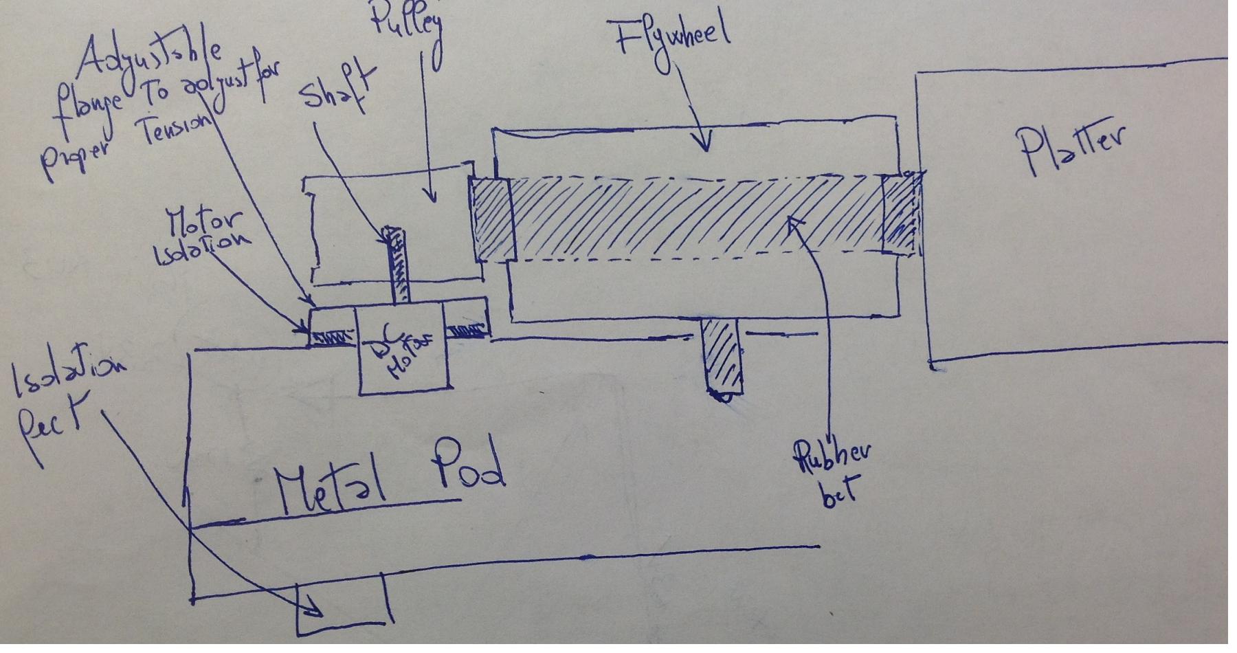

I am not thinking very much yet about the mechanical design as I was waiting to see what RPM you were thinking for the motor, which then might suggest motor pulley size and flywheel size. I am also curious about the motor dimensions.
I am thinking the "Pod" might need adjustable height. For it to work with the most TT's it should be short as possible with the ability to be adjusted for more height. Or, owners will need to add support for the Pod to raise it to the rim.
Jamie
Sounds good.

If the drive pulley is a bit larger it allows easier placement to reach the platter over the plinth, but then the motor needs to run slower.
Do you have a "typical" platter TT height, platter distance from plinth edge we should build to? Maybe your VPI is a good reference. It's about typical height, some TT's with thicker platters might be taller, and only a few TT's shorter, which might not be good candidates for Rim drive since they might have thin plinths and too light.

Yes I was thinking the same. VPI is a standard design also probably one of the most diffused table around the world. Tonight I will take all the measurements and try to create a quoted design and maybe we can tweak it if there can be made even more universal .
Remember I am not ME so my drawing won't be the best you ever seen in your life eheheh!!!
Anyway, here is my detailed idea.
The motor will be mounted on a flange which will have the possibility to be adjusted longitudinally on the main enclosure to set for proper tension between pulley and flywheel.
I choose a square flat belt to have more surface area therefore more grip but if somebody thinks otherwise please let me know.
Both pulley and flywheel will have grooves to perfectly fit the rubber belt; this will allow for a more precise/vibration free installation and the pulley can be easily set up to the right height and distance.
The rubber belt should be properly sanded/milled for max smoothness on a lathe so that minimum vibration will be transmitted to the platter due to the irregularities of the ring.
Please feel free to comment on this.
The main key points here are that the motor position can be adjusted and secured on the metal pod and sits on some sort rubber or whatever material thus isolating it further from the pod. The rubber square rubber belt belt will increase grip on both pulley and platter and be less prone to slippage. Flywheel will also absorb along with the mass of the flywheel any residual vibration coming from the motor therefore any vibration should be ideally drained away from the platter resulting in a quieter reproduction.
If this idea is ok with folks here, we can proceed to create a mechanical model work how spindle and flywheel can be created as well as metal pod (very important to kill vibrations and it has to be reasonably heavy). While mechanical design is being created Pyramid and I, will start doing the preliminary design work.

The flywheel is there to have more mass, although not much compared to the platter, it will still add some extra flywheel effect, but mostly, it will help in lowering vibration going to the stylus which is the main problem.
Considering the average platter will be around 15-20lbs adding a 5lbs for example is almost adding more than 25% of mass to the entire system.
Bul like I said the most use will be to lower vibration. On RIM drive it is very critical. The lower the noise the better the overall results.
The flywheel is not powered up directly by the motor but it will spin on a low noise/friction reversed (?!?) spindle and this is what goes in contact with the platter.
There is a big difference from having the platter powered directly by the pulley or by the passive flywheel.
