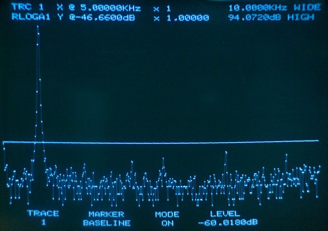

Received a pair of nos ceramic PCM53 today from forum member Ruach who kindly bought them for me in Singapore.
My lucky day, one of those is very good: Worst harmonic -64 dB.
The horizontal line is where the noise floor would be without averaging.

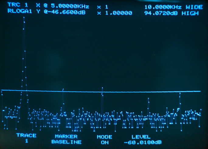

The other one is average: Worst harmonic -55 dB.
Others are as bad as -40dB...
Huge variations that call for test equipment if somebody seriously want to build a DAC with multibit chips-
Not only with this old but sometimes excellent chip.
Bitstream excluded...

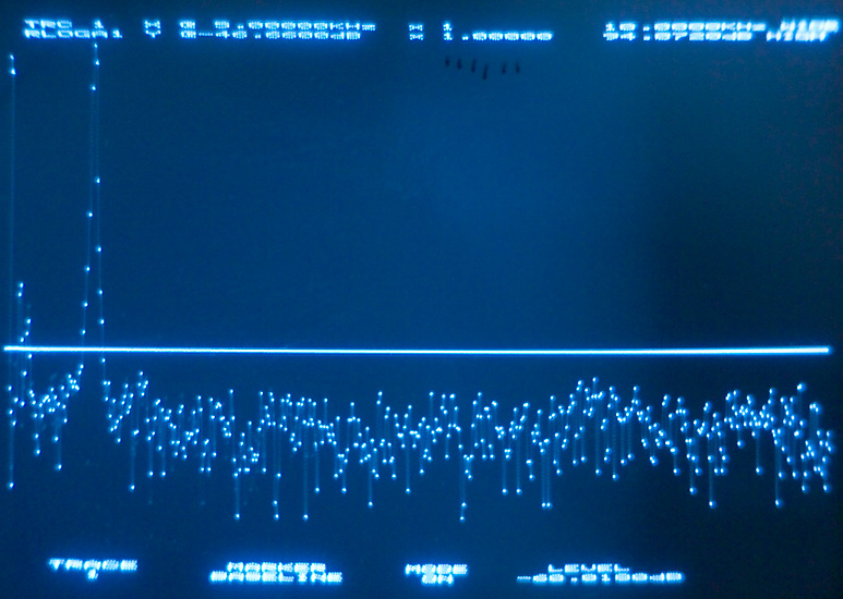

Today I took the time to measure PCM1704 no K in a CAL CL2500.
Better channel @ -60 dB:

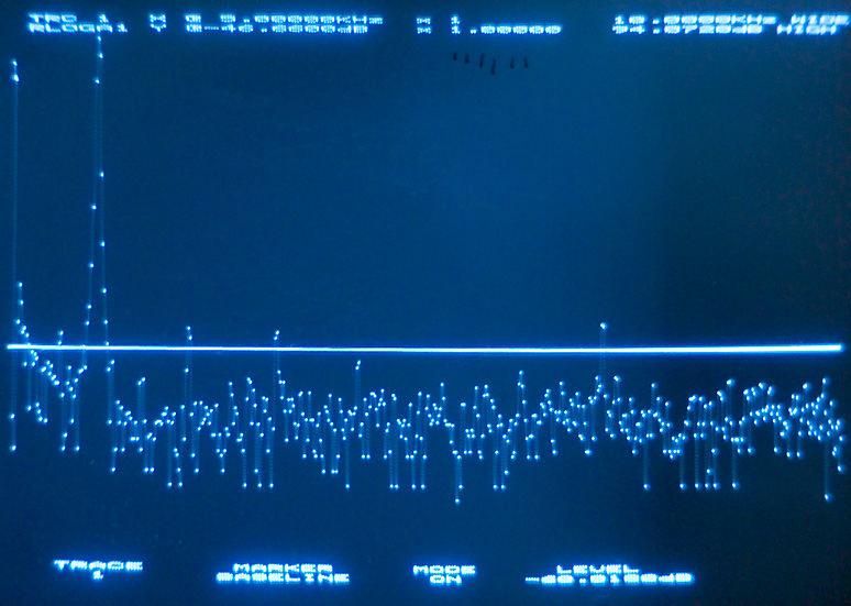

Much worse channel:

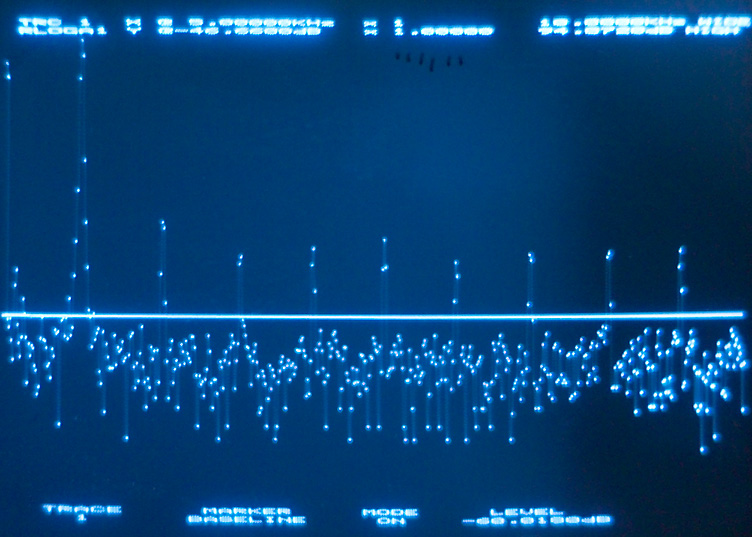

The Yamaha CDX-1110 with MSB adjust, I also used that as transport for the CAL:

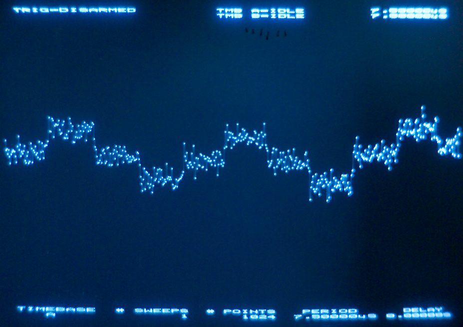

LSB test disc track 15 PCM1704 better channel:
LSB test disc track 15 PCM56 better channel:
Nothing beats a properly adjusted good PCM56...
