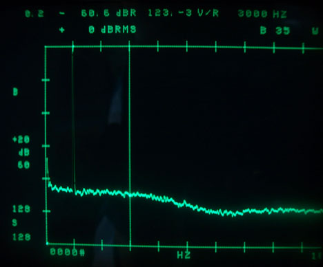

That means, scaled to how I measure ( -60dB signal is set to 0 dB reference in the analyzer) , you have left channel K3 -40,5 and K5 -45,6. Right channel K3 -44,8 and K5 -55,6.
This is not very good, do you have measurement after distortion adjustment ?
My best PCM56 chips have all harmonics below -62 dB which means -122 dB in your scaling.
Your DAC is non os ? I do not know your chips but i know TDA1541 is getting worse in non os.
Those harmonics will give your DAC a specific sound, only question is if you like it 😀
I prefer the cleanest I can get and I don`t care where it comes from, os or non os. Cleanest I get from os![]()
My references are absolute.
It means, that on the -60 dB diagram, K2 is -116 dB from full scale and K3 is -100dB. The harmonic distortion at -60 dB is about 1%
This is before adjust, but I have to wire the two resistors and the trimmer on each dac to adjust...
On the 0Db diagram, the K2 is at -73dB and K at -92 on one chanel and -112 on the other.
I put also a -80dB diagram, where I have 10% distortion.
My tests signals are on a CD. Odb is a full scale signal (-32767/+32767)
-60db is a full scale/1000 and 80 dB is a full scale/10000.
I think that my results are quite good!!! No ?
On your measurements (if vertical scale is 10 dB/ div and top ref -60 dB), I see the noise floor at approx -110 dB absolute , then it is not very far from what I see on mines.
On this one for example,
I think that the peak is - 100 dB on these harmonics.
Or I don't read correctly the vertical scale.

Your references are absolute to 0dB signal.
-60dB signal with -116dB K2
My references are relative to the measured signal.
If I would measure your DAC I would get -60dB signal = 0dB with K2 = -56dB
To be able to measure the harmonics with my stand alone analyzer, I need to move the cursor to the frequency I wish to have as reference, here 1 kHz, and then set the amplitude at that point to either 1V or 0dB. I set 0dB. When I move the cursor, it always shows amplitude relative to the before set reference.
Back to performance...
As mentioned, I have all harmonics below -62dB that means -122dB in your scale. Also there are no harmonics visible, I assume if they are hidden under noise visually, they will also be hidden sonically.
My noise floor is not flat, it varies between -62dB and -68dB, it is a signal one forum member made for me. In your scale my noise floor is between -122 and -128dB.
Why ? My scale is 10dB/div and display gain is set to 20dB ( vertically shifted up 20dB ), you can see on the left side of the pictures, that means the 1 kHz signal is cut on the top end of the scale, I can only set to 60dB or 120 dB vertical scale and I choose 60dB. That does not affect measurement, just the visible area is a 60dB window.
Another signal from another forum member gives me -61dB noisefloor which is also flat like yours.
On the picture of my measurement, you quoted, the cursor is on K3, the enlightened point shows the peak and you can read on the top left that amplitude here is -54,0 dB which is -114 dB in your scale.
Do you use averaging ? Your noise looks nervous...
I would be really interested to see your measurements after adjustment, get 10-turn pots, it is impossible to adjust with standard pots.
Now it is not very good but I would not expect something else.
You should be able to make all harmonics disappear under noise.
But to achieve that probably you need to select chips, don`t trust K-stamps, this is selected without adjustment.
A totally clean spectrum like you see above is far from K-stamps.
Also it may not be possible to get there without os.
I could not get as good results with other chips like PCM58 and PCM63 and those are 18 bit and 20bit. Poor 16bit PCM56 is better
I have understood!!!
Ok, I understand better now how to read your measures!!!
10dB/div AND 20dB vertical shift
I have to wire the trim pots around the ad1865. I will post the curves before and after trimming.
The noise floor is quite high, perhaps because of my setting (no ground plane on the board) as you can see on this photo :
Philippe

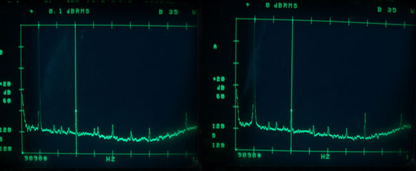

PCM53 in a Teac ZD700, only one DAC for both channels.
Noise @ 6000Hz is -66dB, @ 2000Hz -60dB
Tested 3 chips, all look the same.
No adjustments made for distortion, the player has 3 pots, all for noise.
So far the best chip IMHO.

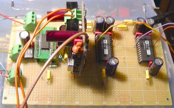

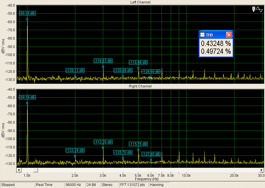

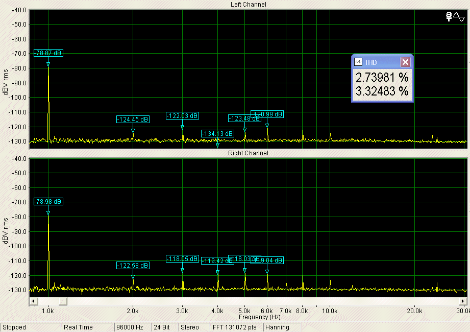

Hello
It's me again!!!
see here for previous measurements :
http://www.diyaudio.com/forums/showthread.php?postid=600972#post600972
I made some improvements :
1st : I finished my second D1 I/V, then I am full balanced (two dacs on each chanel).
2nd : I measure with the same audigy card, but I placed a ina2134 between the balanced xlr output of my dac and the RCA unbalanced inputs of the card.
3rd : I installed and trimmed the trimmers around the MSB and trim dac pins.
And here is the result :
At -60dB fs
Philippe
It's me again!!!
At -60dB fs
Philippe
