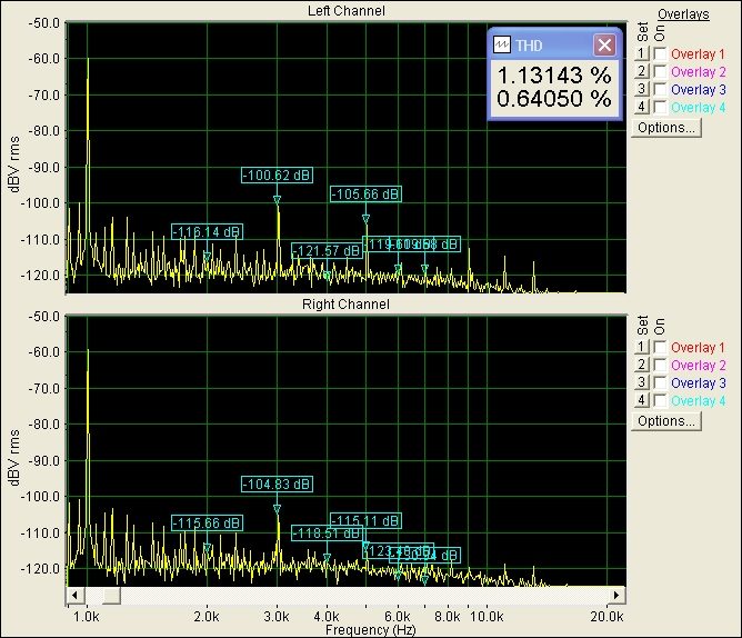

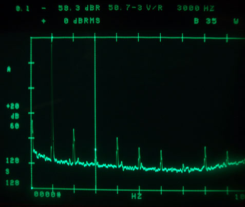

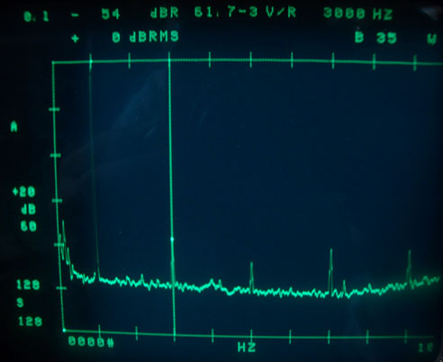

A very good TDA1541A S1 with oversampling filter SAA7220B in a Philips CD960, no averaging = original noise floor.
The horizontal line marks -60dB relative to the input signal.

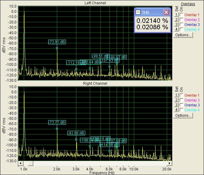

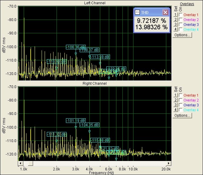

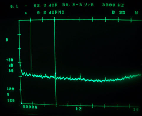

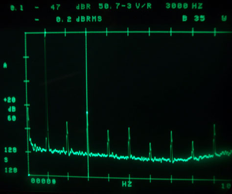

Now the SAA7220B bypassed, no oversampling.
There is K2, K4, K6, K8, K10, each 10dB above noisefloor.
You hear it...
You hear it...

hifi, I have a problem with my email program...
No, there are two different things.
One is that a CD960 with os compared to a CD304mkII or a CD880 with os has slightly higher distortion using the exactly same SAA and TDA chips in sockets.
The other is that TDA in non os has higher distortion compared to os in any Philips player.
The first op amp and the most critical is the I/V stage and that has to deal with 176khz when in os, but only 44 khz when non os !!!
Still, the slew rate of the stepped unfiltered signal from step to step is always the same regardless if os or non os.
Also the slew rate is limited by a parallel cap in all philips players.
So that op amp or op amps in the filter stage has nothing to do with it.
Also in my external DAC with PCM56, even completely passive it is worse ( but still beats any TDA in os 😀 ) than in a 8x os player with same chips.

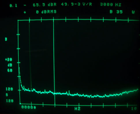

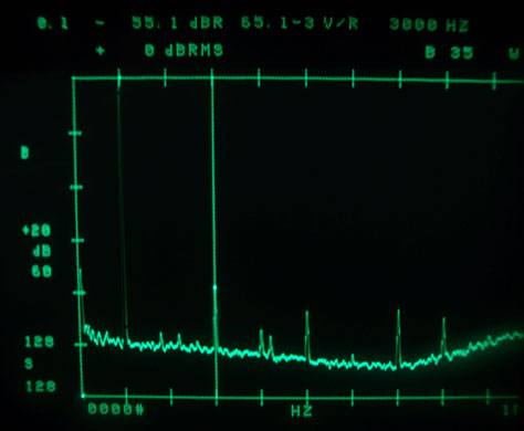

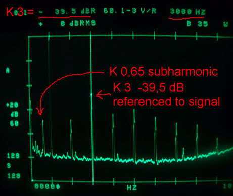

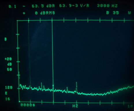

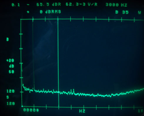

Received a pair of nos ceramic PCM53 today from forum member Ruach who kindly bought them for me in Singapore.
My lucky day, one of those is very good: Worst harmonic -64 dB.
The horizontal line is where the noise floor would be without averaging.
The other one is average: Worst harmonic -55 dB.
Others are as bad as -40dB...
Huge variations that call for test equipment if somebody seriously want to build a DAC with multibit chips-
Not only with this old but sometimes excellent chip.
Bitstream excluded...

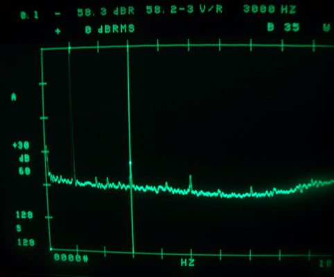

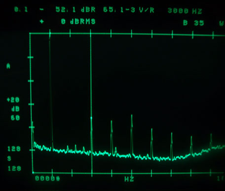

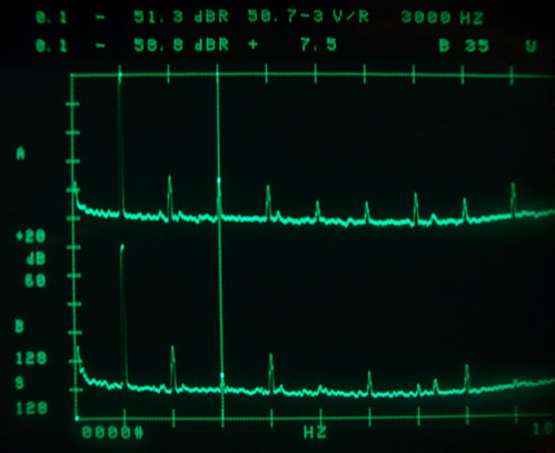

Today I took the time to measure PCM1704 no K in a CAL CL2500.
Better channel @ -60 dB:
Much worse channel:
The Yamaha CDX-1110 with MSB adjust, I also used that as transport for the CAL:
LSB test disc track 15 PCM1704 better channel:
LSB test disc track 15 PCM56 better channel:
Nothing beats a properly adjusted good PCM56...
Much worse channel:
