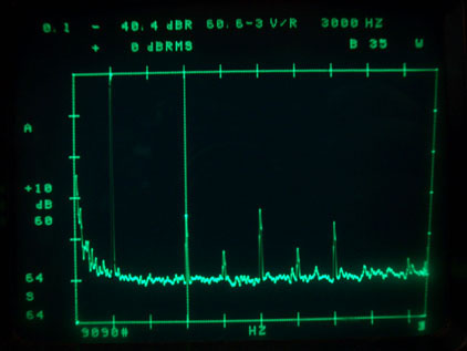

Sony Playstation SCPH1002
Noise floor -55dB
K3 -40,4dB
All very bad, but sounds sweet, soft & lazy 😀
Noise floor -55dB
K3 -40,4dB

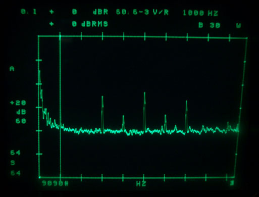

Above Picture, whole graph was only shifted 10dB , for direct comparison again correct 20dB and with cursor on 1kHz:
