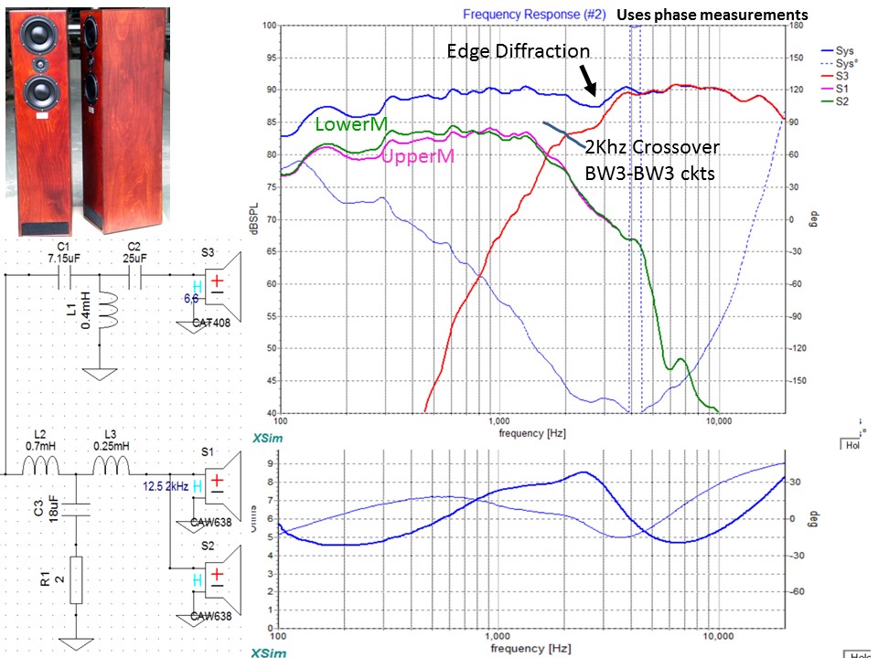

While it's on my mind, I was looking at the Group Delay traces from the files you set me and one item stood out.
See this ;
650665d1513005154-crossover-current-speakers-morel-cat-408-tweeter-png

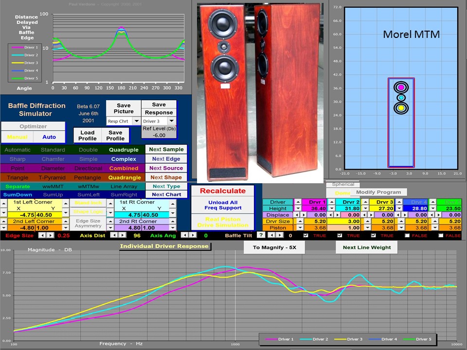

This drawing shows a possible correlation between the 5K response suck-out and some excess group delay.
I'm thinking its a diffraction artifact ( either caused by the sharp edges of your cabinet ) or a reflection coming back from the nearby woofer frames .
Either way ( if it concerns you & you want to pursue a remedy at some point ) read-up on ( Google ) about using felt treatments around the tweeter to mitigate the effect .
A really good place to start is David Ralphs Speaker Pages
Specifically ; Read his articles on ameliorating the effects of diffraction by using felt near the tweeter.

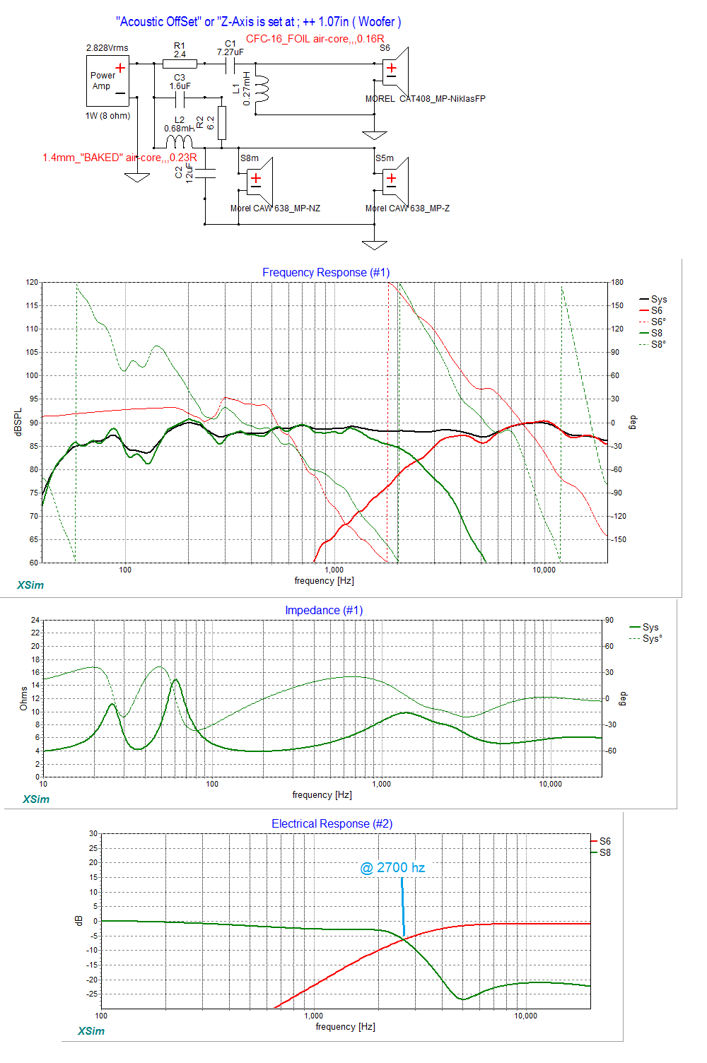

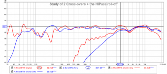

Hi Niklas,
Here's what I've done ( using your measurements > made in place ).
- A large Thanks! to Dissi for having previously provided some real world .zma files for these drivers. :D
- I ended up with a woofer offset of just over 1 inch ( 25mm ) using the curve-fitting method on two different files .

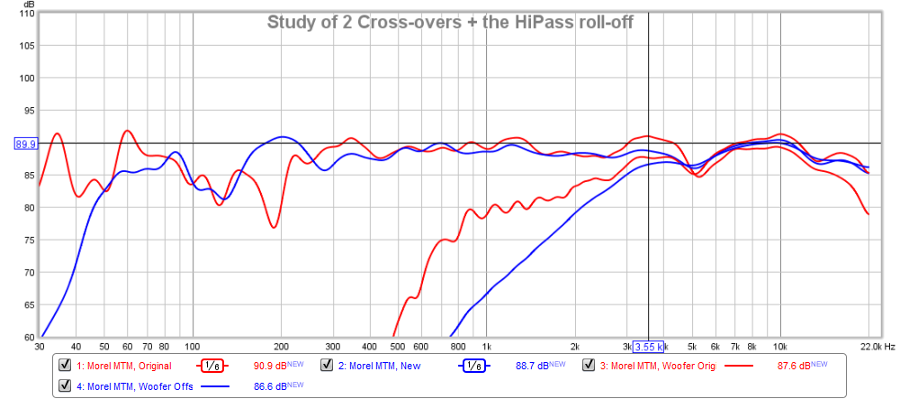

Let's start with a quick comparison of your original network and this effort .
(a) It's worth looking at how much more protection the tweeter gets ( from the newer network ) below 1K.
> The original is @ 10db down
> The newer would be @ 24db down ( at 1K )
(b) The "bumps" at 1,25K & 3.5K are reduced
(c) The trough at 5.2K has been filled a bit ( though to really fill it right in, you'll need to identify & fix the likely diffraction issue I previously brought-up ).
(d) I endevoured to maintain a similar overall sensitivity to what you currently enjoy > though this being somewhat smoother, it likely won't sound quite as loud.
(e) There's hardly any BSC in this network ( using your subs would fillin a lot of what might be missing ).
(f) If the tweeter level needs increasing ( especially if you start cranking the sub level ) > reduce the value of R1.
- start with going 1.5R and then go smaller if you still need more HF.
attachment.php
Here's the network ( with a study of it's different responses );
( it's a pretty large pic )

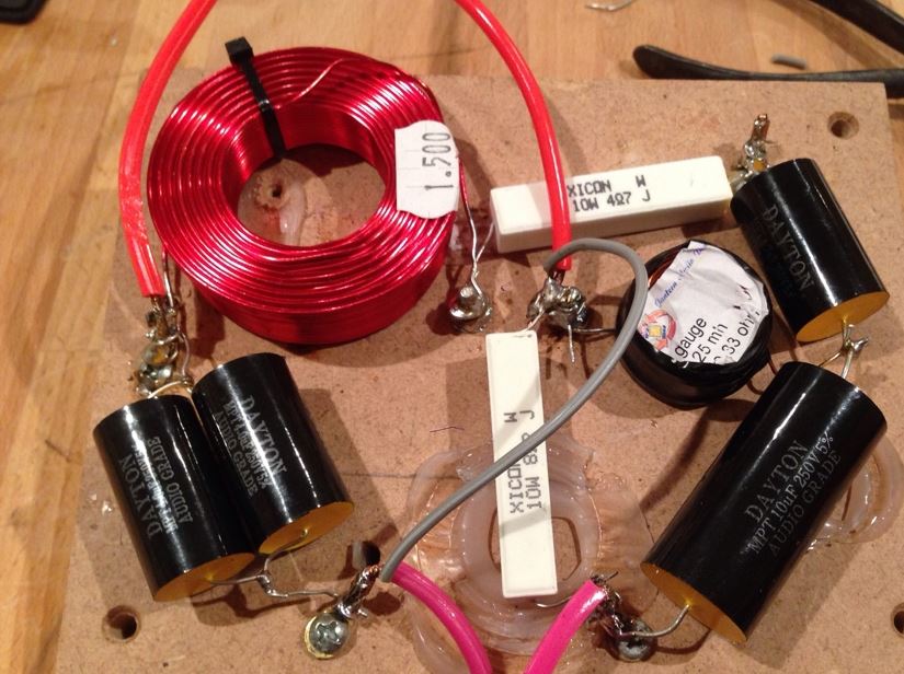

- it incorporates your existing parts into the new HiPass section.
- The LowPass section will require buying all new parts.
- L2 - the coil recommendation is in the pic ( as a Mundorf "Baked" wire-type air-core ).
- C2 at this point would be fine with a Mundorf, NP electrolytic
- C3 could easily be a Metallized Mylar type cap at that position ( & small size ).

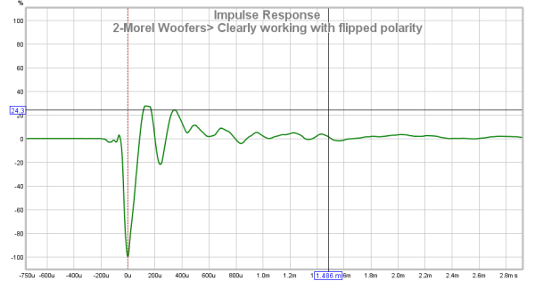

- Pay strict attention to the driver polarities here > they both need to be the same ( say positive for the sake of argument ) .
- Driver polarity can be determined by using REW and then looking at the IR of each driver.
For instance, this is what you sent me previously ( for the 2 woofers );
attachment.php

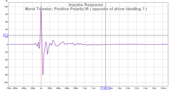

And here's the IR for a tweeter ( flipped according to the labelling on the driver > if I remember correctly )
attachment.php

Hi Niklas,
650702d1513030750-crossover-current-speakers-morel-woofers-impulse-negative-png
650703d1513030948-crossover-current-speakers-morel-tweeter-impulse-positive-png

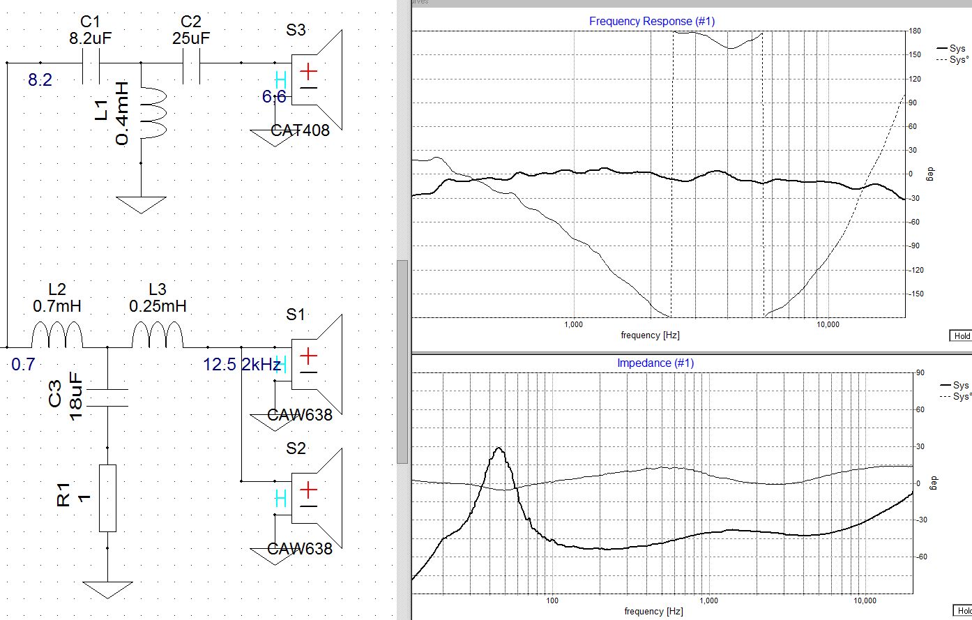

I simulated a 2Khz BW3-BW3 crossover using the measured phase data instead of the S/W generated phase data. The CAD tools predict a sharper -dip around 2.7Khz from edge diffraction than the series of shallow -dips around 2kHz in your measurements. Early D'Appolito discussions favor BW3 because the main lobe was larger and had less tilt.
Have you simulated BW3-BW3 for this Morel MTM?
Hi LineSource,
I've simmed many a 3x2, 3x3, 2x2 parallel, 2x2 series, ie; many different combos actually.
Vernacular check: ( 3x2 = 3-pole HF over 2-pole LF ) for instance
I'm using .frd files derived from Niklas actual ( in box, in room measurements ).
ie; The bumps and suck-outs seen within my sims won't be going away, no matter how well the crossover region gets stitched together .
Here are the Fr's for three contenders ( from amongst dozens made ).
To recap, these use actual Fr's made by Niklas out in the middle of his living room ( once he places the speakers against their permanent wall location there is a measurable increase in bass response ).
Zma files were provided by Dissi ( Thanks ! )
I've displayed these sims using the WinPCD software so that the respective power responses could be compared ( XSim doesn't have that feature ).
Two of these are 3x3 networks, with the third being a 2x2.
Two of them sport them mild notching on the woofer.
All three have inline resistors in the HF section for level matching.
One of these designs is from LineSource ( Thanks ! )
