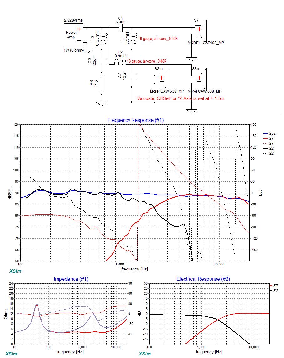

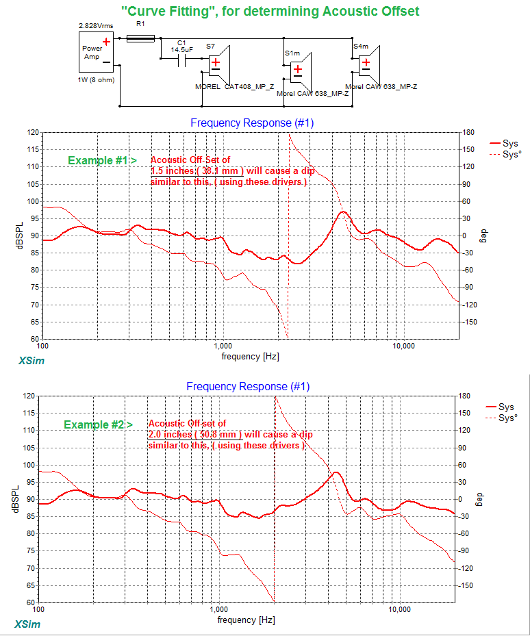

Allen, I am currently working with estimates ( for the offset ) using anywhere from 1.5" to 2.5" (with the woofers acoustic center set behind that of the tweeter ) .
A few of my mock-ups use 2" as the default offset ( which IME does seem like a lot for such tiny drivers > though the included closeup of the driver offers maybe a different perspective ).
Given Niklas's ( youngish ) age, I'm trying to keep the electrical crossover point right around the 2K mark ( so that he can contemplate having these components for a long long time ) .
attachment.php

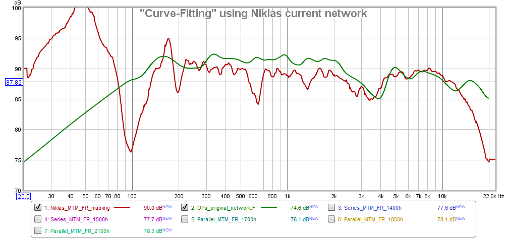

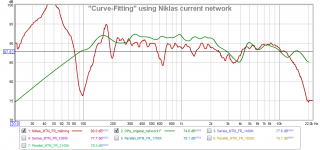

I have already done some "curve-fitting" to roughly guesstimate an offset .

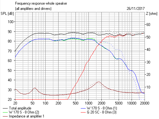

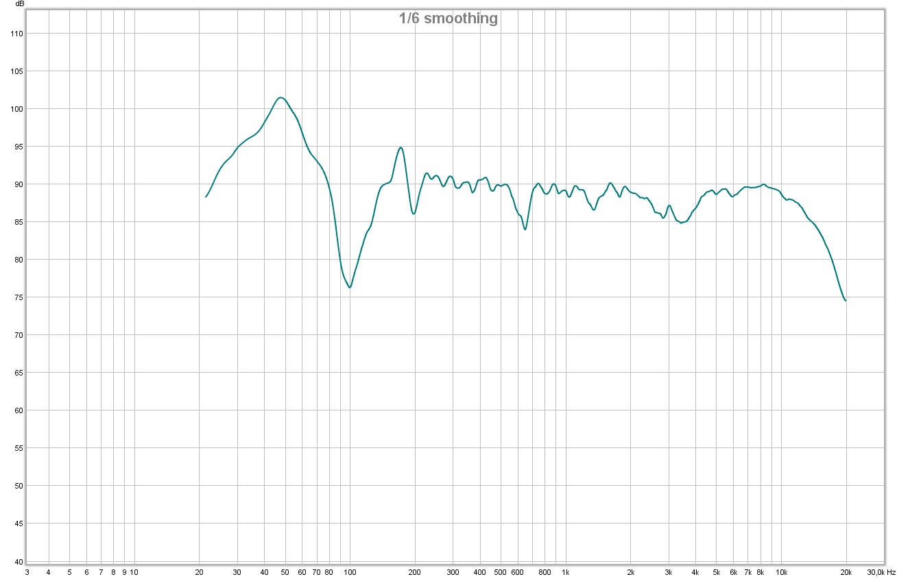

Here's an FR that belongs to Niklas ( taken from his blog ) that shows his twin subs added to the Morel MTMs .
attachment.php
Specifically, I hope ( for my own edification ) to get to the bottom of some of the discrepancies seen in the following pic.
attachment.php
One can see there is good general agreement in the shape of the 2K to 4.5K notch ( but not so much, the notch depth ).
- The real problem here is, the displayed notch ( of my working files ) has something like a 4K bottom while in real life, the bottom of the notch ( from Niklas's actual measurements ) is @ 3500hz.
- If I add distance to the woofers offset to get my notch to move over to 3500 hz, then the general shape really goes to hell ( which then leads me to believe I have some errors baked into my files ) .

PS; Here's a teaser for Niklas ( this is a few days old using a shallower offset > and is not a finished design )

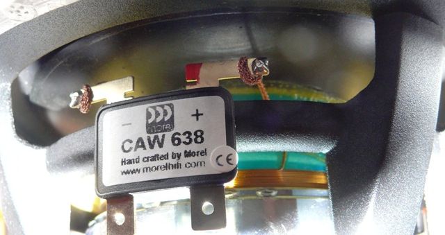

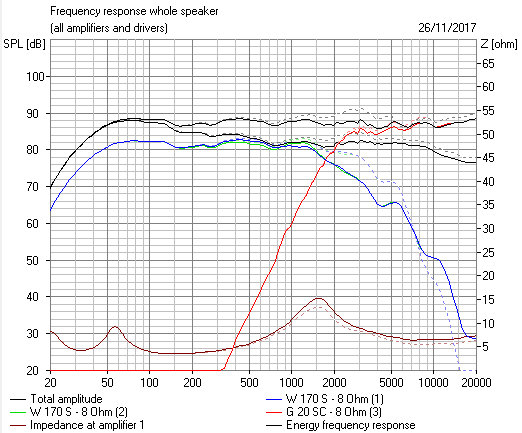

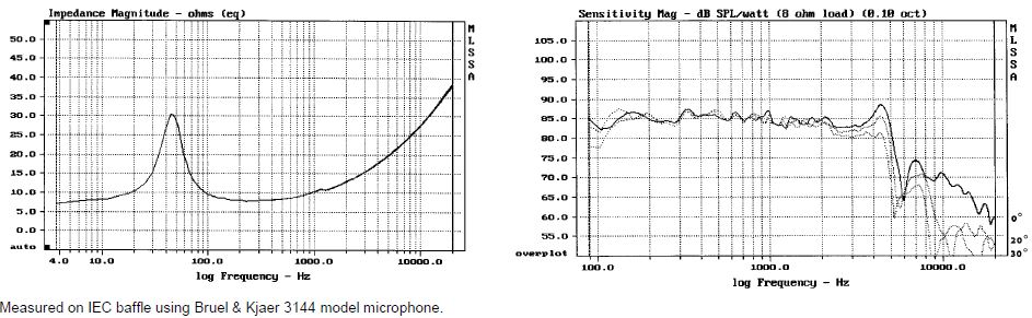

EarlK, I'm delighted you're having a serious go at "the speaker from hell", AKA the 6" bass. Especially since Lojzek has deserted us for his Peerless PPB 830874 project. :D
I do hate this one. I never get it sounding quite how I like, and it always seems to force me to a lower crossover than I really like. :confused:
I'd take a chance and go for 2" or 5cms acoustic offset here. I have seen some evidence that lively cone material brings the acoustic centre forward, but here we at the damped end with polycone Morel.

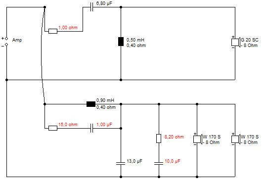

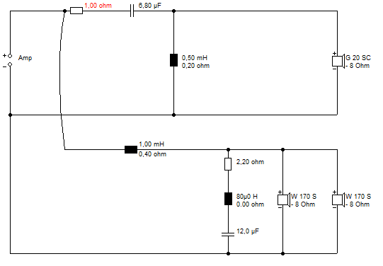

I took your idea and ran with it. 1.8mH and 6.8uF per driver is a regular sort of solution with a lot of 8 ohm drivers. I thought that rather than 0.9mH and 13uF, 1mH and 12uF is going to be very similar and easier to get hold of.
647589d1511524555-crossover-current-speakers-morel_caw-638-jpg
My modelling is with different drivers, but gives a qualitative taste of what a 5kHz notch (if in doubt, notch higher and shallower...) might do to that troublesome 4.5kHz bump. You can do it two ways, can't you? Because it takes down the midrange a little, the tweeter might need taming a little too. Phase alignment improves for sure. Here's what I got for some second order solutions. But you crack on! :D
I think your modelling will be far better and more specific than mine.

Thanks for the encouragement Steve ( and thanks for the link to the older backgrounding thread > I likely wouldn't have participated here if I hadn't read it ).
I'm hoping to learn a few things out of this exercise ( such as the pitfalls of creating and using Minimum Phase files from what are essentially 2D file sources ).
Early on I had tried a 4.5K notch ( though I only tried a series type across the driver with no impedance correction > anyways, it didn't work very well > actually, not at all ).
The parallel notch has worked much better & seems to be an option that Niklas might employ ( or not ) as his discretion .
- My added notch takes 4.5Khz down a good 10db, getting 4.5Khz close to 20db below the pass-band ( a figure that's somewhat an arbitrary & personal threshhold when looking to hide nastiness below the fundamental ).

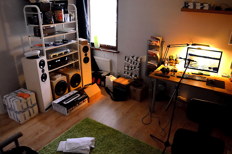

Here's an older pic of your setup;
648246d1511825636-crossover-current-speakers-dsc_0114_01_hme_setup_sml-png
SPEAKER Preparations :
(1) Remove both crossovers from the speakers ( we need all 4 capacitors to obtain a largish value, and we certainly don't want those inductors involved here ).
(2) Make sure the woofer wires are paralleled together ( and are marked as such ) and hanging out the bottom port ( extend if necessary with some 2-conductor wire ). Clearly mark on the wires which wire is connected to the positive terminal of the woofers .
(3) Do exactly the same for the tweeter
(4) Wire together ( Parallel ) all 4 of your existing caps and attach one end to the wire that's connected to the positive terminal of the tweeter.

MEASUREMENT Location & Orientation ( within your room )
(1)If you still have that nice ( cube like ) white cardboard box ( to the left of the left-most speaker ) , place it within corner of that green carpet ( assuming the box will hold the weight of 1 speaker, if not, use a stool ) .
(2) Place the speaker ( previously ) prepared for testing on top of the box facing at the camera ( that took this pic ) .
(3) Shuffle about both pieces ( speaker & box-plinth ) a bit so that they are a good meter away from any hard objects ( to their immediate left or right ) .
(4) Point your test mic on-axis ( not 90deg pointed upwards ), centered on the tweeter, from 1 meter away.
- Distance from center of each woofer's dustcap, to the tip of the test mic should be the same distance.
- FWIW, make sure you load the 0deg calibration file into REW.
- Make sure that there's a good meter to meter & 1/2 of space behind the mic ( to minimize reflections )
(5) Connect a test amp to the speaker, then connect your computer ( that runs REW ) to the amp ( either directly or through a pre-amp of sorts ).
(6) Open up REW and power up the amp and run some REW pink noise into the system. See if you can with-stand a 90db level ( it's pretty loud, so 80db is also acceptable ).
