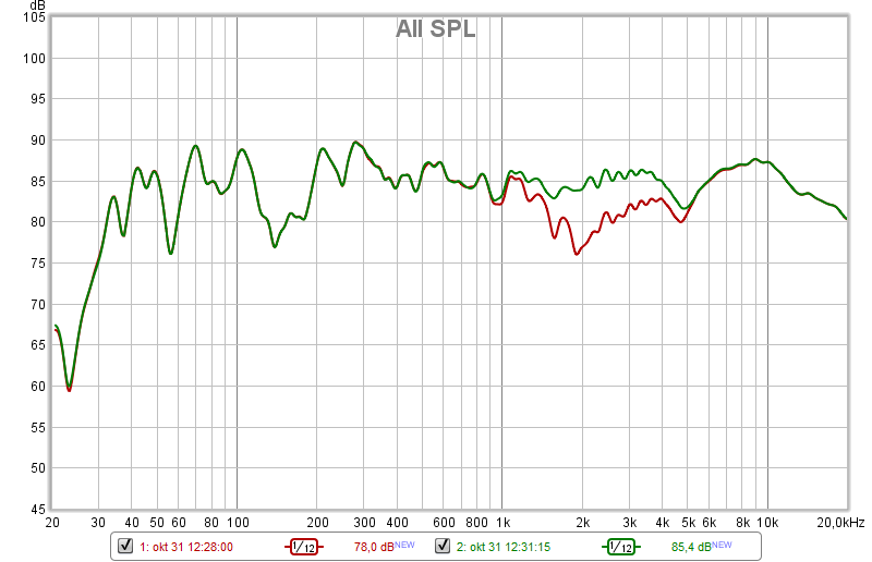

Flipped the cables at the crossover and there was a clear audible difference. Red line is after I flipped the cables. Weird that everything is now right when connecting according to the marking on the drivers 😕
Measurement was done ~1m in front of the left speaker at their current position, so not in the middle of the room.
Thanks Niklas,
Go with ( quite obviously ) the driver polarities that correspond to the green trace.
To treat the "suckout" of the frequency range between 100 and 200hz you would need to treat the walls behind the speakers ( if you desired ) with absorbers.
- That looks to be "wall bounce" and is known as SBIR.
I've previously mentioned that the symmetrical 5K notch ( is most likely a diffraction issue from the enclosure & the nearby woofers ) and would be somewhat treatable with a felt cowling around each tweeter.
- BTW, reclaiming those frequencies will give you the impression of a louder tweeter.
All-in-all, the result is as expected, with quite good low frequency extension.
Niklas said:Red line is after I flipped the cables.
Niklas said:Weird that everything is now right when connecting according to the marking on the drivers.

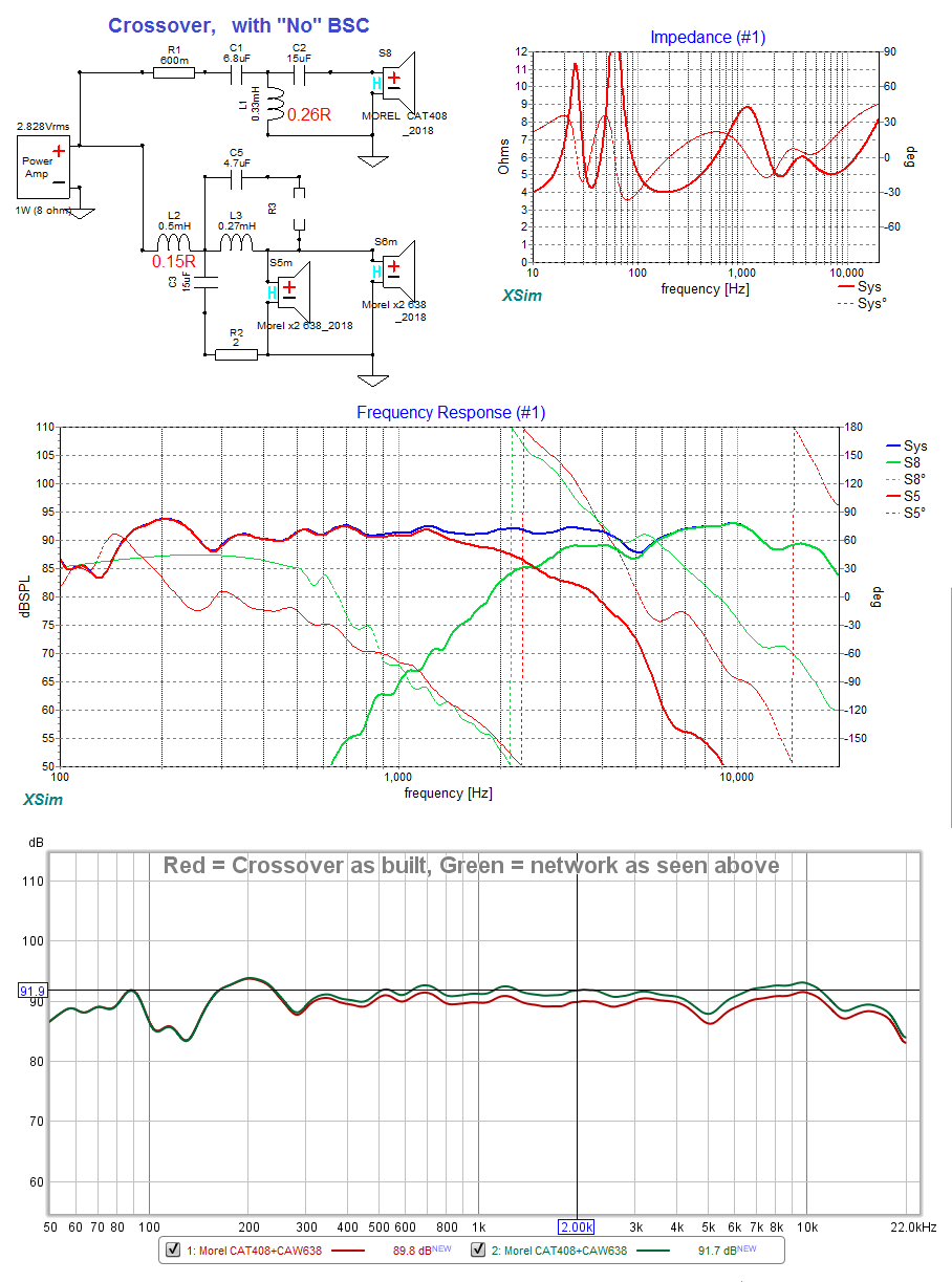

Niklas,
Here's a variation on your new crossover.
I've removed all the BSC ( Baffle Step Compensation ) .
It increases the component levels ( above 1K ) by close to 1.5 - 2db .
This version would definitely be "more forward sounding".
It's possible ( given your lively room acoustics ) that you may like it more ( if the current one is found to be "too polite") .

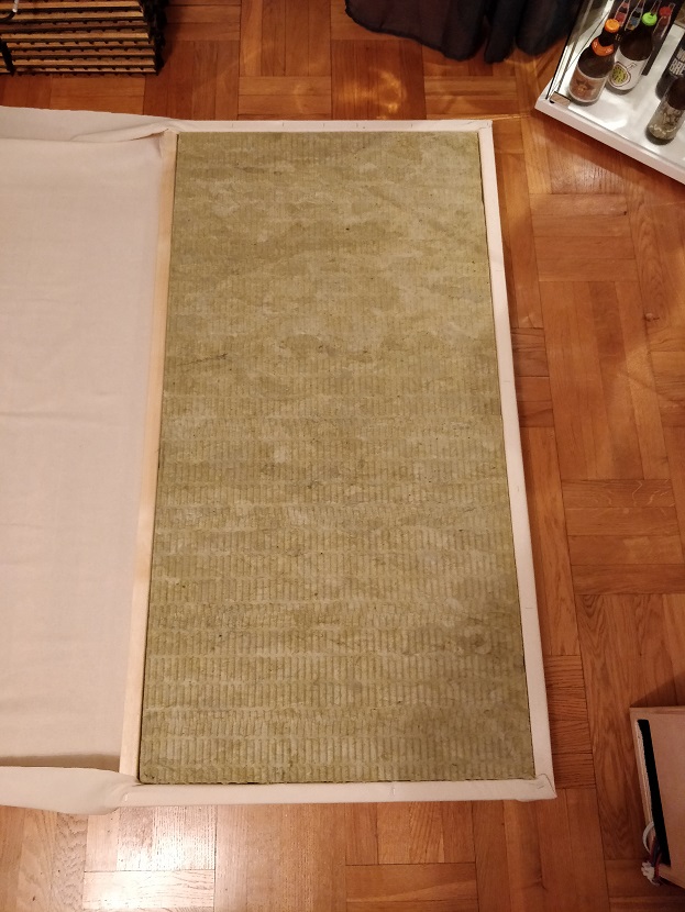

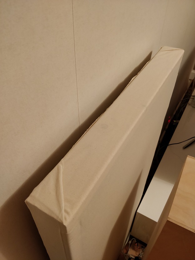

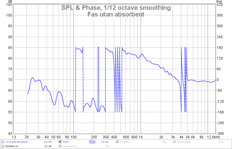

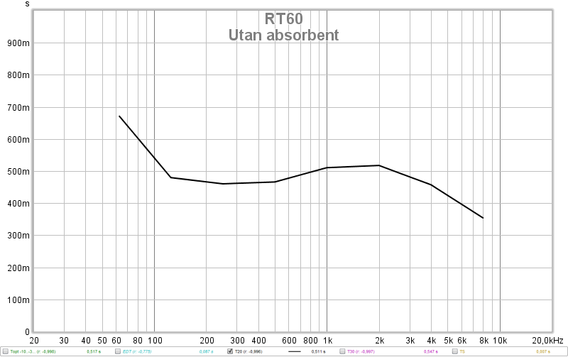

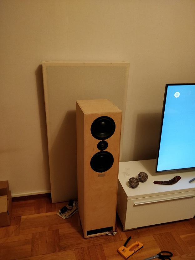

A couple of months ago I bought some 70mm 60x120cm ground insulation material. A couple of weeks after that I bought some 28x70mm wood. A couple of weeks after that I cut them to size and the day after that I assembled two 60x120cm frames. A little over a week after that (today) I went to Ikea and bought some cloth to wrap the frames with. Only bought enough for one layer for one frame since I have no idea how to get the corners nice and tidy so I figured I'd do a test run on one frame first. Turned out pretty okay, at least for the part you can see. The back side is not so pretty though. Also, it turns out that the cheapest cloth at Ikea matches the colour of my walls really well.

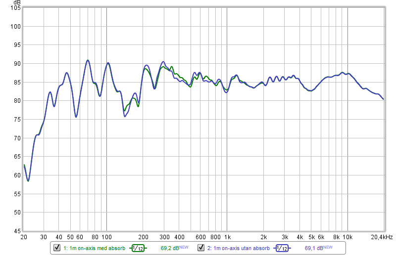

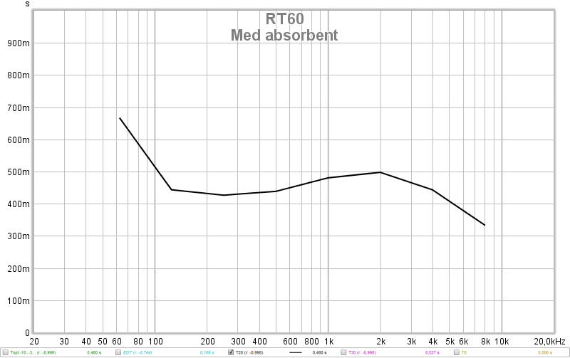

Did some measurements with and without the frame behind the left speaker. Mic was at ~1m on-axis and only left speaker was used for the measurement. Not a big difference in SPL but phase seems a little more tidy and RT60 is a little lower too.
I will wait with listening tests until I get both frames done. I will wrap this one with another layer of cloth to prevent particles from the insulation from becoming airborne and also to not have the frame "shine through" the cloth.
I will have one slab of insulation left (bought a pack of three) and I don't know what to do with it. I could build another frame but I have no idea where to put it. It would be too heavy I think for hanging it on a wall but I guess I could maybe make some space right behind the TV although I'm not sure how much it would help if placed there.

- New crossover for my current speakers
