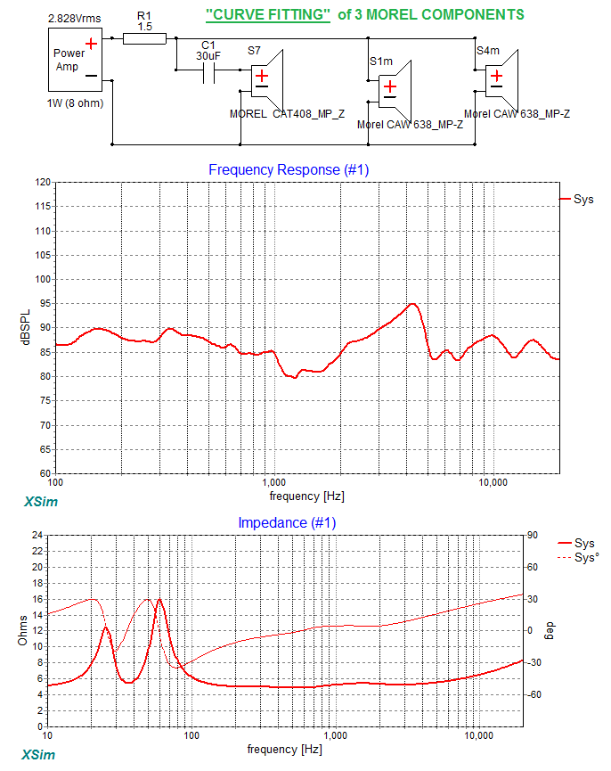

Also ( after looking at the combined responses > it looks like your tweeter is still flipped to negative polarity ) .
All drivers need to be working in the same ( + ) polarity.
See this image ( of the necessary test setup > this is what the combined-component curve looks like if the woofer offset is 2.5" ) ;

I just did the measurements (although I forgot the single woofer one, will do that after this post). By looking at the frequency response (and phase) I can see why you think there is something wrong, and I totally agree with you. I took out the drivers, double checked how the wires were connected to the drivers and how I had connected them outside of the speaker. Everything is correct, but still the tweeter is actually out of phase. I flipped the polarity of the tweeter and it looks much better now. Frequency response adds up as it should and the phase graph is much "calmer". I'll do the single woofer measurement now and post some pictures and email you the data file.
This makes me wonder if they accidentaly wired the tweeter (or the woofers) wrong. My bet is on the tweeter. I'll take the tweeter from the other speaker and see if it's the same with that one. It's always good to know, wouldn't want to have all drivers in phase except for one of the tweeters being out of phase because it is wired wrong from the factory.

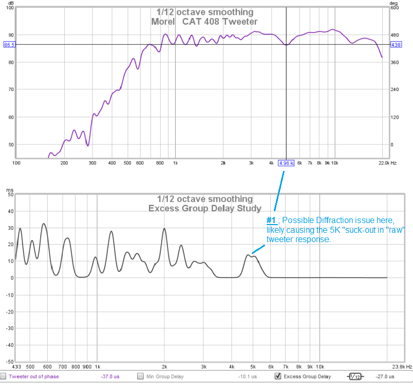

While it's on my mind, I was looking at the Group Delay traces from the files you set me and one item stood out.
See this ;
attachment.php
This drawing shows a possible correlation between the 5K response suck-out and some excess group delay.
I'm thinking its a diffraction artifact ( either caused by the sharp edges of your cabinet ) or a reflection coming back from the nearby woofer frames .
Either way ( if it concerns you & you want to pursue a remedy at some point ) read-up on ( Google ) about using felt treatments around the tweeter to mitigate the effect .
A really good place to start is David Ralphs Speaker Pages
Specifically ; Read his articles on ameliorating the effects of diffraction by using felt near the tweeter.
