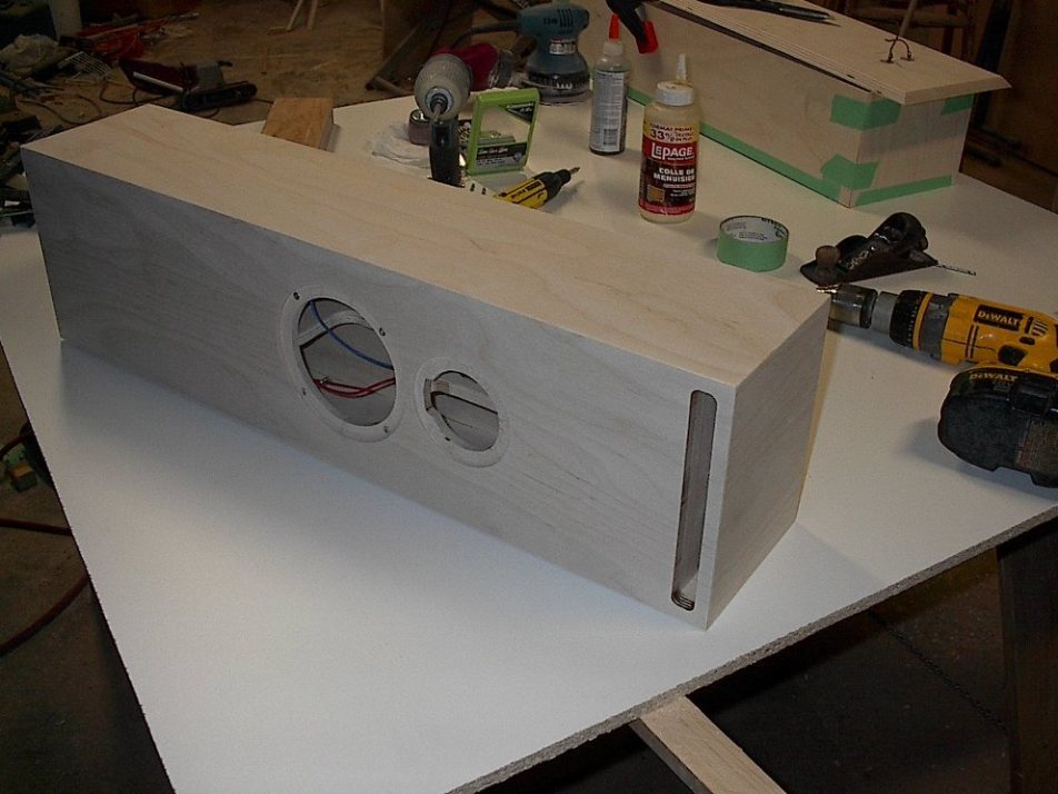

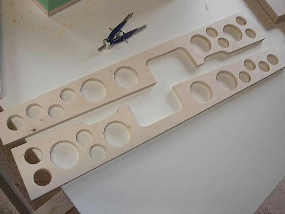

Construction details: 100% baltic birch plywood. Full mitered corners. This picture shows the box without it's back:
Disabled Account
Joined 2007

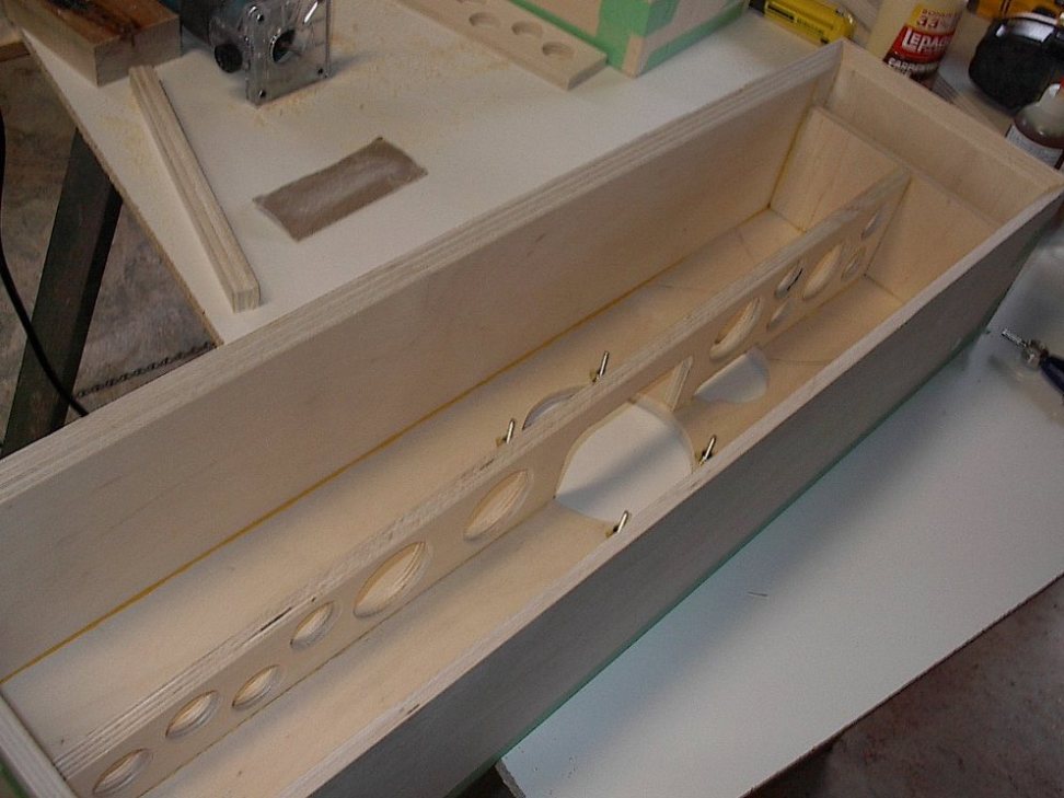

planet10 said:
Did you put those braces dead centre? Looks like it, but i hope not cause it is too late to fix it.
Nice to see the holey brace propagating -- blessed by a bishop you know :)
dave
Whats wrong with dead centre? I eye-balled it, pretty close to centre. ;)

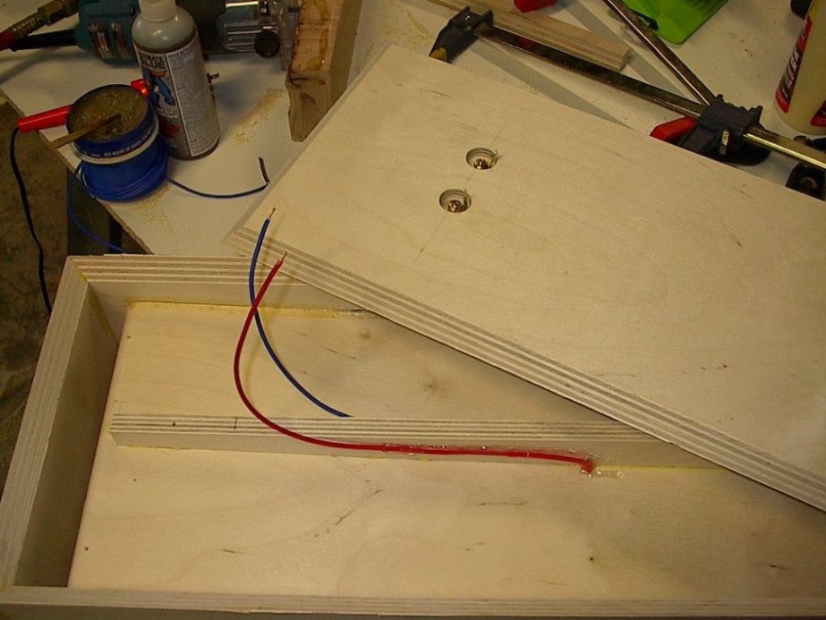

Here's the back, wires are glued to brace with hot melt. The two holes are the posts.

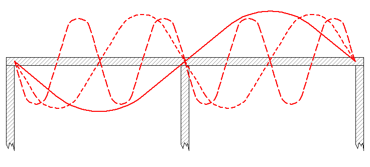

The centre of a panel is the worst possible place to put a brace. It clamps the panel such that the 1st (and most serious) vibrational mode (and harmonics) of the panel is more or less unaffected, and energy from other modes are shunted into it.
dave
Disabled Account
Joined 2007
Shifting it more to one side will fix it? I'll keep that for future reference. The panel is only 7" wide, with that brace, the span is a little more than 3". When I knock on this box it allmost sounds like it's made from 1" MDF. It's solid. I'm looking forward to a listen

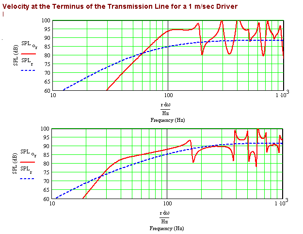

To satisfy my curiosity, I simulated the original with Martin King's model to see the difference. The old one is on the top, the new on is on the bottom. I think this is a difference that you can hear. Both charts are for unstuffed lines.
