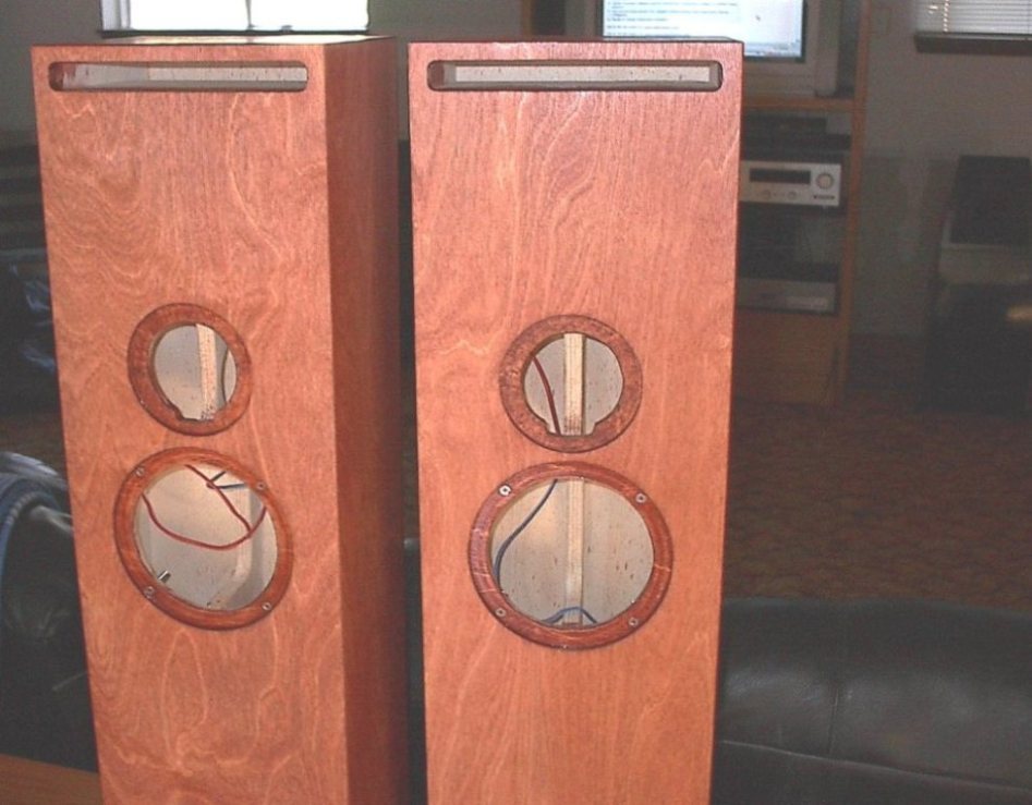

I'm back. Before leaving last week I applied the first coat of stain( my own recipe). Yesterday I gave it a 2nd coat and today the third and final coat. Colour is uniform and the plywood finished nicely, although in some areas there are fine cracks in the veneer. You have to be looking very closely to see these though.
For final finish I'll use satin Varathane Diamond polyurethane - water based.
Working on the crossover tonight. I've decided to go the series route again, crossing at ~4000Hz. Given the range of these drivers, that should be ok.
Anyhow, here's how they look stained. Image quality is not great(my camera is a POS):

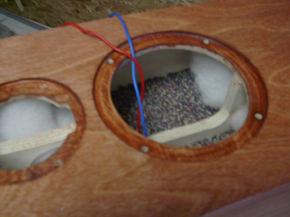

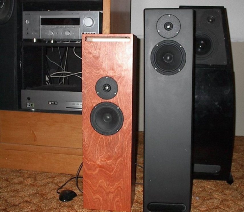

After 2 coats of finish today I could wait no longer, I had to hear it. Some stuffing( mostly at the start), the drivers with just a 2.4uF cap on the tweeter. I am listening to it now with one of my main speakers, as I only have one ready. I can say it's a success beyond my expectations. There is smooth bass with authority, not forced. The midrange is crystall clear and the highs are sweet. Good imaging, even with it stuck out in the middle of the room, and paired with an unlike speaker.
I hooked up the old one and can say there is a hugh improvement in both bass response and dynamics.
A few more days listening and I'll have a better idea if I need to do anything different, as in more or less stuffing, crossover work.

Ok. After not much listening I decided that the midrange was a little to over-powering, and the tweeter is not playing enough of a part. I added commercial rubber back carpet directly behind the woofer, as I think this will stop the backwaves from boucing off the plywood and straight out through the cone. I also put in some more stuffing.
I then changed the cap for a higher value(6.2uF), which put the cutoff below 4K, in stead of the 10K of the 2.4uF.
Both of these proved to be very good improvements. The midrange is toned down enough to better match the bass, and the tweeters output doesn't sound isolated anymore. I was tempted to put a choke on the woofer, for a proper 1st order rolloff a 4K, but I really don't think it's needed. The sound is very clean and natural.
When I put the drivers in the other box, I'll get a better idea of how they sound.

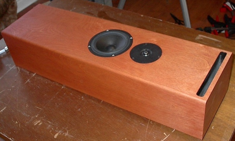

Pleased to say that this project is finished. Just finished mounting them back up where the old ones were.
After extensive listening last night and today, I can say the results are well worth the effort. When I turned on my subwoofer to fill in the bottom end, they really sounded good.
Came up with a new mount for them that's in two pieces - one part screwed to the back of the speaker, the other part on the wall. With two per speaker, it works well. Anyone interested in this mounting system, I'd be glad to share the details, as it is very simple.
When the weather warms up enough, I'll take one down a test it outdoors. It's been fun.

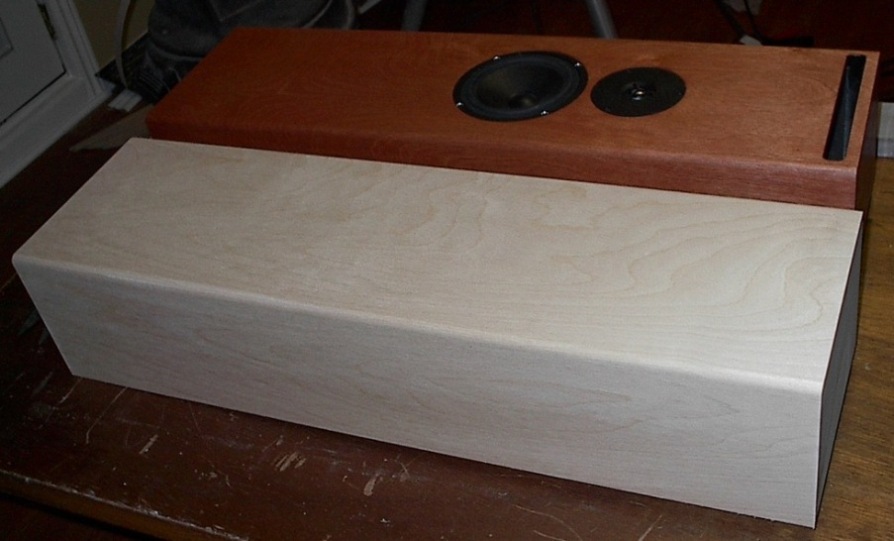

Time for a change...
These speakers have been in service for about 10 months as the rear surrounds in my "home theater". They sound very good, and I'm (almost) satisfied on that front, but I've never been thrilled about the way the Baltic Birch plywood turned out finished.
I found there were tiny cracks in the face veneer that were magnified when I applied the stain. The grain pattern was not the best either and certainly not a match for the maple of the main speakers.

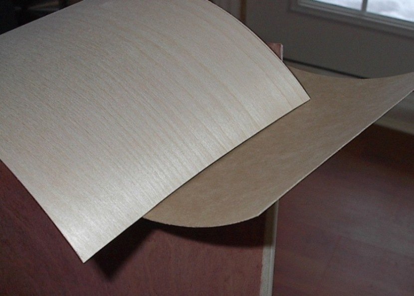

I decided a while back (about 3 days after I finished them :) ) that I would take the time to veneer these. This would fix the mediocre appearance and allow me to make another improvement: round the edges, at least along the sides.
When I do a veneered project (not often anymore), I use paper backed veneer from Cedan. This veneer is fairly thick (almost as thick as raw veneer) and has consistent grain and few, if any, defects.

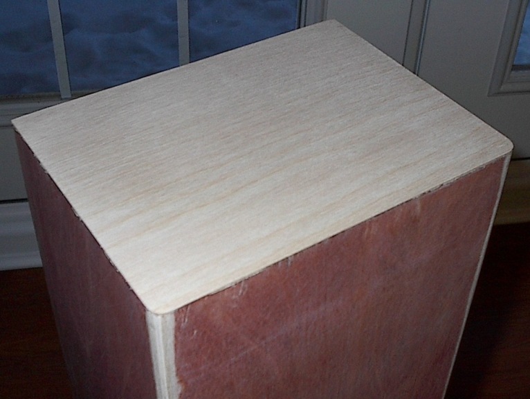

I start by taking out the drivers, stuffing and crossover.
I want to round the edges, but there isn't enough "meat" in the corners for a big one, so I settle on a 1/4" radius. This will improve the "boxy" appearance and make it possible to wrap the enclosure on three sides with one continuous piece of veneer, with only the ends applied separately. I will leave the back as is.
Here's a shot of the veneer sitting on top of the box, These have been cut for the ends and will be glued on first. Notice the box has the raw edge where I cut the 1/4" radius.

I got tangled up in a "discussion" about veneer and, more to the point, what to glue veneer on with in this thread.
My experience with contact cement for veneer has always been positive. I have never had a problem with bubbling, or delaminating. The veneer has never moved or shown any signs of the glue loosing adhesion. Generally speaking, if something works for me, I continue to use it. So it goes without saying that I used contact cement here.
I use the glue straight from the can, without thinning it and use a small foam roller to spread it. Keeping the roller wet and not rolling excessively will prevent the glue from clumping up as you spread it. I do one quick coat on the veneer and one on the first end of the box, wait 10 minutes, then stick it on.
I have a hard rubber J-roller for putting pressure on the piece to ensure complete adhesion. After the piece is attached, I trim the excess off with a laminate trimmer bit in my trim router.
Here's how it looks with one end done. At this point, the entire box has been sanded with 320 grit disk in the random orbit sander. This isn't necessary for adhesion, but will provide a smoother base for the veneer.

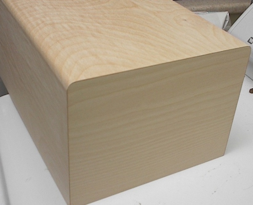

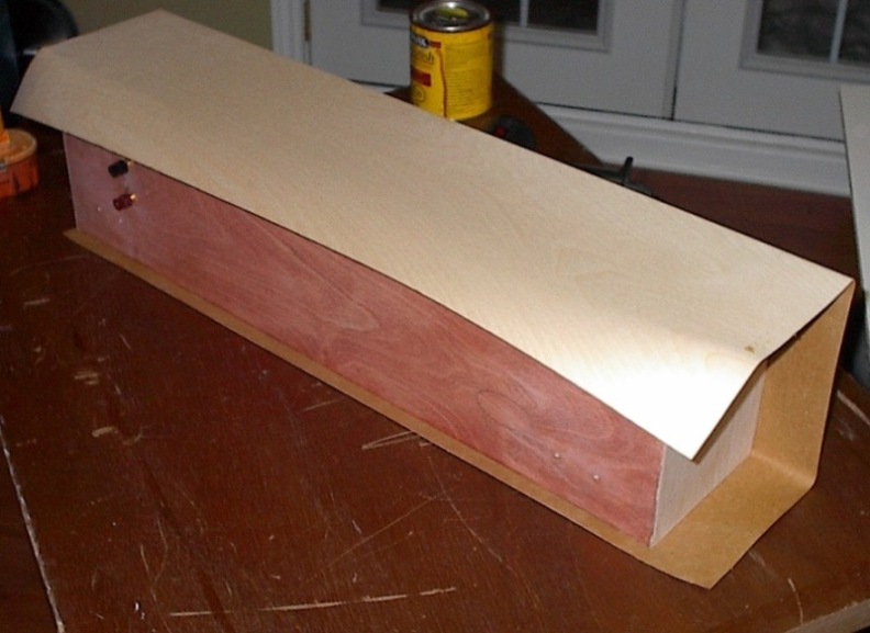

With both ends capped, it's time for the tricky part: wrapping the veneer around three sides.
I cut the veneer big enough to cover the sides and front with some extra to spare. Spread the glue on the veneer and the box and let it dry for 15 minutes.
I figured the best way was to adhere the front first, then ease the veneer around the radius and cover the sides. Laying the sheet of veneer on the table with it's back up, I position the box above it and set it down on the veneer in the right place. Turn it over and use the J-roller to smooth it on. Rolling out to and on the rounded corners starts the veneer around the sides.
I find patience and a heat gun are effective tools here. Once the veneer is attached, I use the heat gun to warm it up and the roll it out again.
Here it is before I trimmed the excess off.

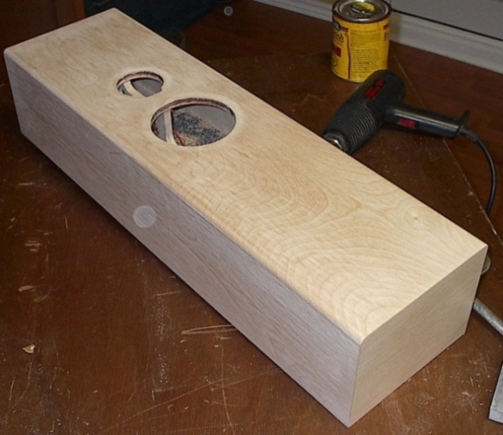

I have sanded the first box and put the first coat of stain on. It took the stain very evenly and the colour is very consistent throughout. I will let this dry overnight and apply a second coat tomorrow. Two coats should be sufficient for good colour.
I have prepared the other speaker for veneer - removed the drivers etc. Hopefully, it goes as well as the first.

Here's the first speaker, stained with the driver put in place (though not hooked up). Camera is not showing it, but there is a HUGE improvement in colour and grain consistency.
Also, no cracks. :)

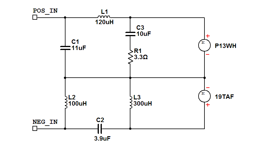

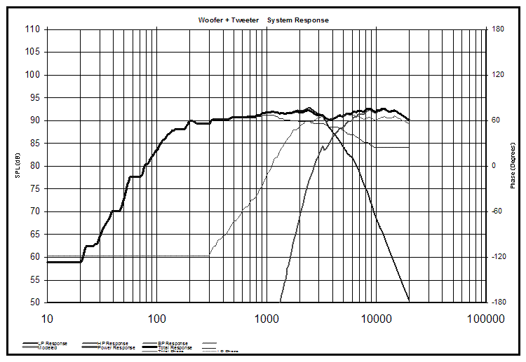

Working with the Pasive Crossover Designer, I've come up with what I hope will be a good design.
In order to us this utility, I need to have the frequency response plots in the .frd format and the impedance response in the .zma format. I downloaded the SPL tracer that allows me to convert the graphic image of these plots (from the spec sheet) and convert it to usable plots.
This is a little tedious, but it does the job fine.
With this data in the designer spreadsheet, I played around until I had what looks like a good alignment.
Earlier today, I calculated the baffle step for these with The Edge, but I will leave this out of the final crossover, as I don't know where these speakers will finally end up.
The crossover is a series type with a Zobel on the woofer. It uses a 2nd order slope on the woofer and a 3rd order on the tweeter, crossed at 4500Hz.
Here is the projected overall response:

Getting back to the crossover: Circuit has been designed and simulated electrically with SPICE. It works as designed, with the xover at the 4.5K point. Time will tell if it sounds as good as it looks.
I will start to construct these crossovers today. The components are already in my stock, just need to unwind a few inductors from larger ones.
Here is the circuit:
