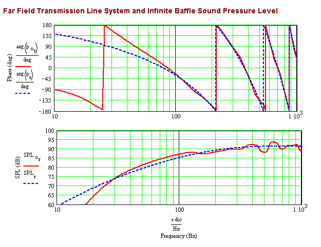

I have re-ran the simulation over and over trying different lengths, taper ratios. 65 is pretty much ideal for this driver. A steeper taper can result in high velocity at the mouth. However, I did increase the taper to a little over 9:1 and came up with good results. velocity at the mouth is still acceptable, and bass response is improved:
To me, your results suggest that the line is still too long, and it is heavily overdamped.
Try setting the damping to 1lb/cu ft, but only for the firat half of the line (from the driver end). Leave the second half of the line (port end) empty.
I used this approach on a Jordan JX92S TL recently, which is similarly sized to your driver, and got very good results.

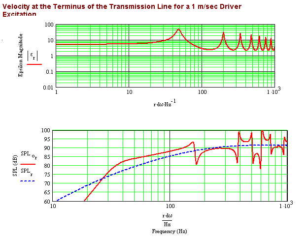

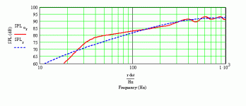

Here it is with no stuffing at all:
OK, I think this verifies that the line is tuned far too low in frequency, as even with the reinforcement from the line at the low-end, there is still a pronounced overall slope to the response.
A line length in the range 45 to 55" would be better. Also, if you put the stuffing back - but only in the first half of the line, you will find that the low-end reinforcement is maintained, but the high frequency fluctuations are greatly reduced.

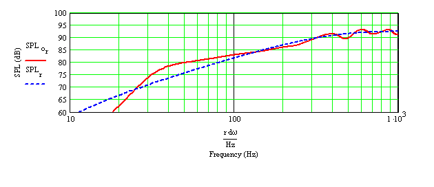

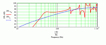

Here it is with the line length reduced to 45" unstuffed:
MJL21193 said:
CS: To your credit, you were right. In my haste, I forgot to change the stuffing amount through the line.
Am I wrong in thinking it looks good?
Yes that's much better 🙂
With the line 'half-stuffed' as before, it will probably be the best you can do with that drive unit.

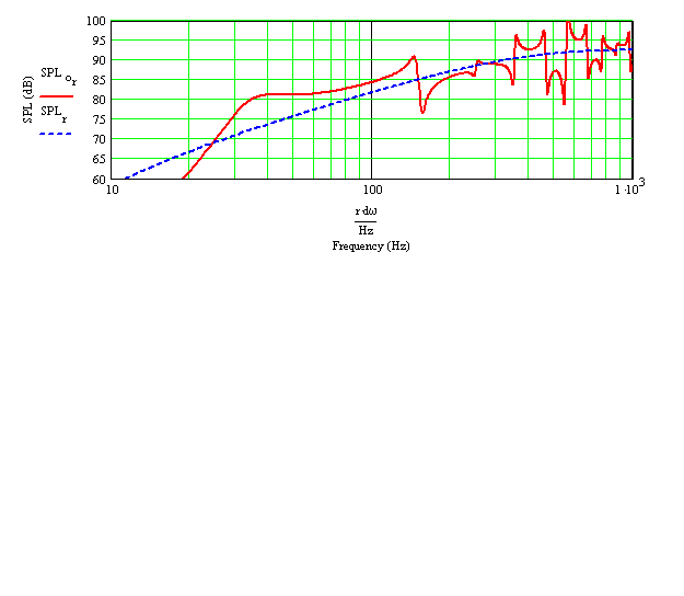

Further tinkering with the simulation gives me the results I think I'm looking for. Offset the driver 12" from the start of the line, increase taper ratio to ~6:1 while maintaining the same cross sectional area at the start. With minimum stuffing I have the following result:

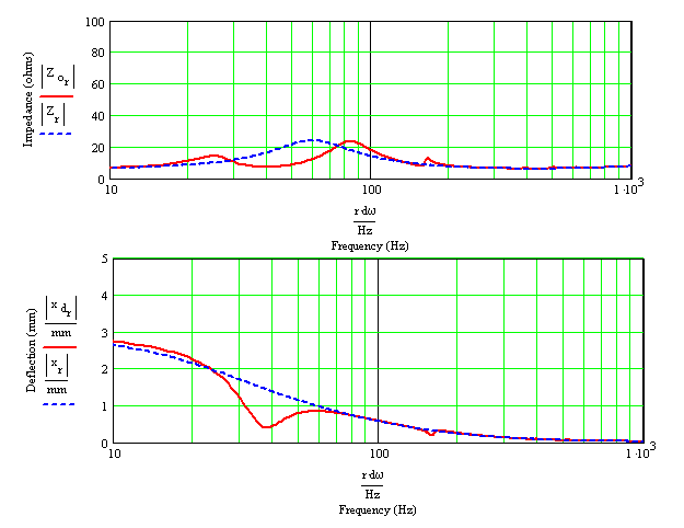

Can you post the impedance & excursion plots to go along with this one please.

When I say the dotted line is infinite baffle, I'm only reading what it says above the chart:
Could be my mistake, but i've seen the blue line change around with the same driver in different size boxes, so i made the leap that Martin is using the term -- common before acoustic suspension -- of calling a sealed box that is relatively large an infinite baffle.

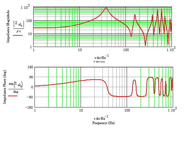

Patience! Here they are. You didn't say if you want acoustic or electrical impedance, electrical first:
We were posting simultaneously... impedance is unstuffed? The 3rd peak is indicative of significant ripple that should go away with some stuffing.
The shape of the saddle indicates you are getting some bass reiinforcement... with appropriate room placement to about 40 Hz.
