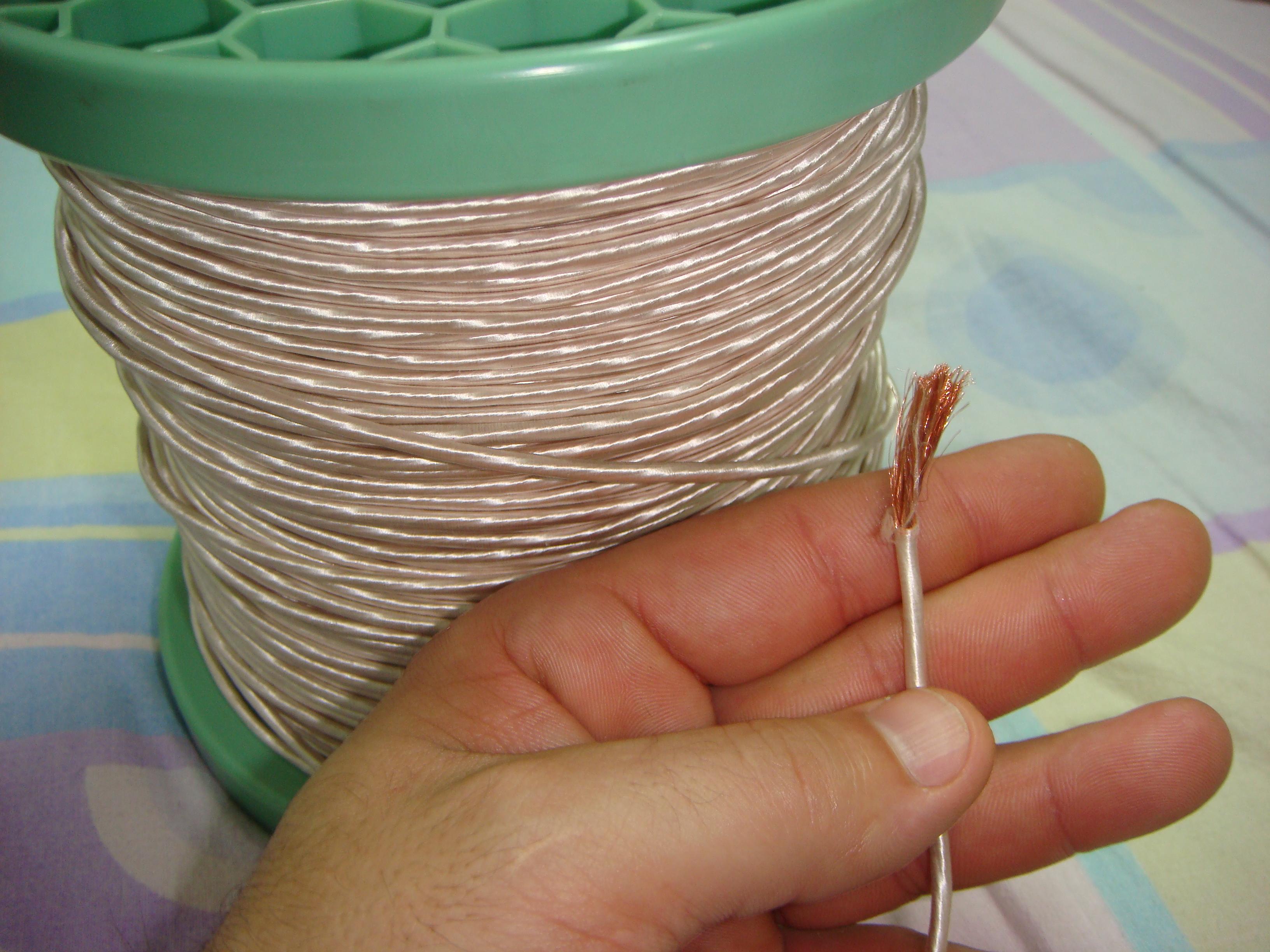

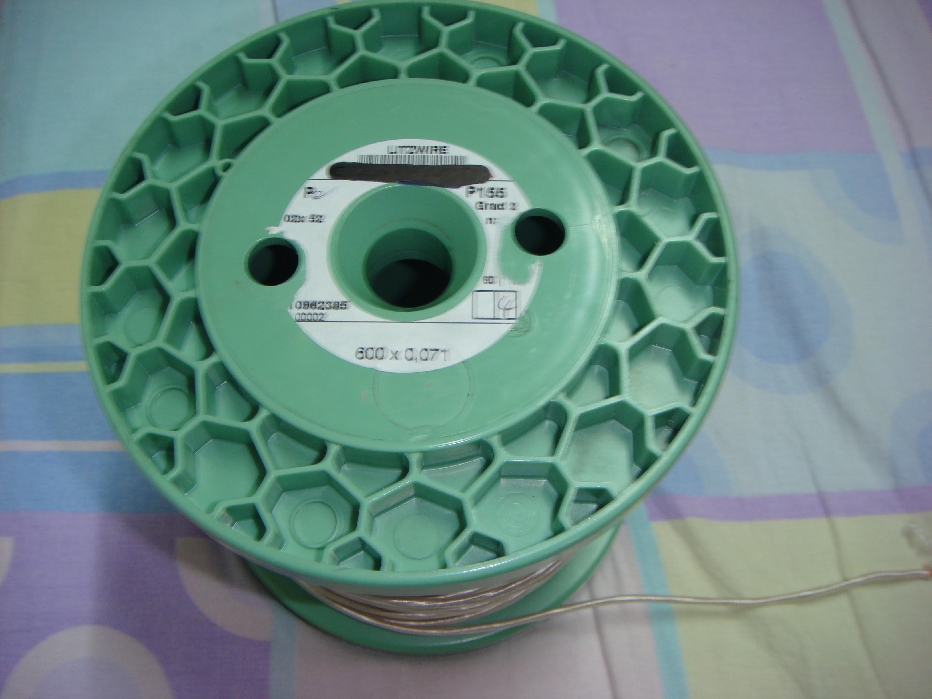

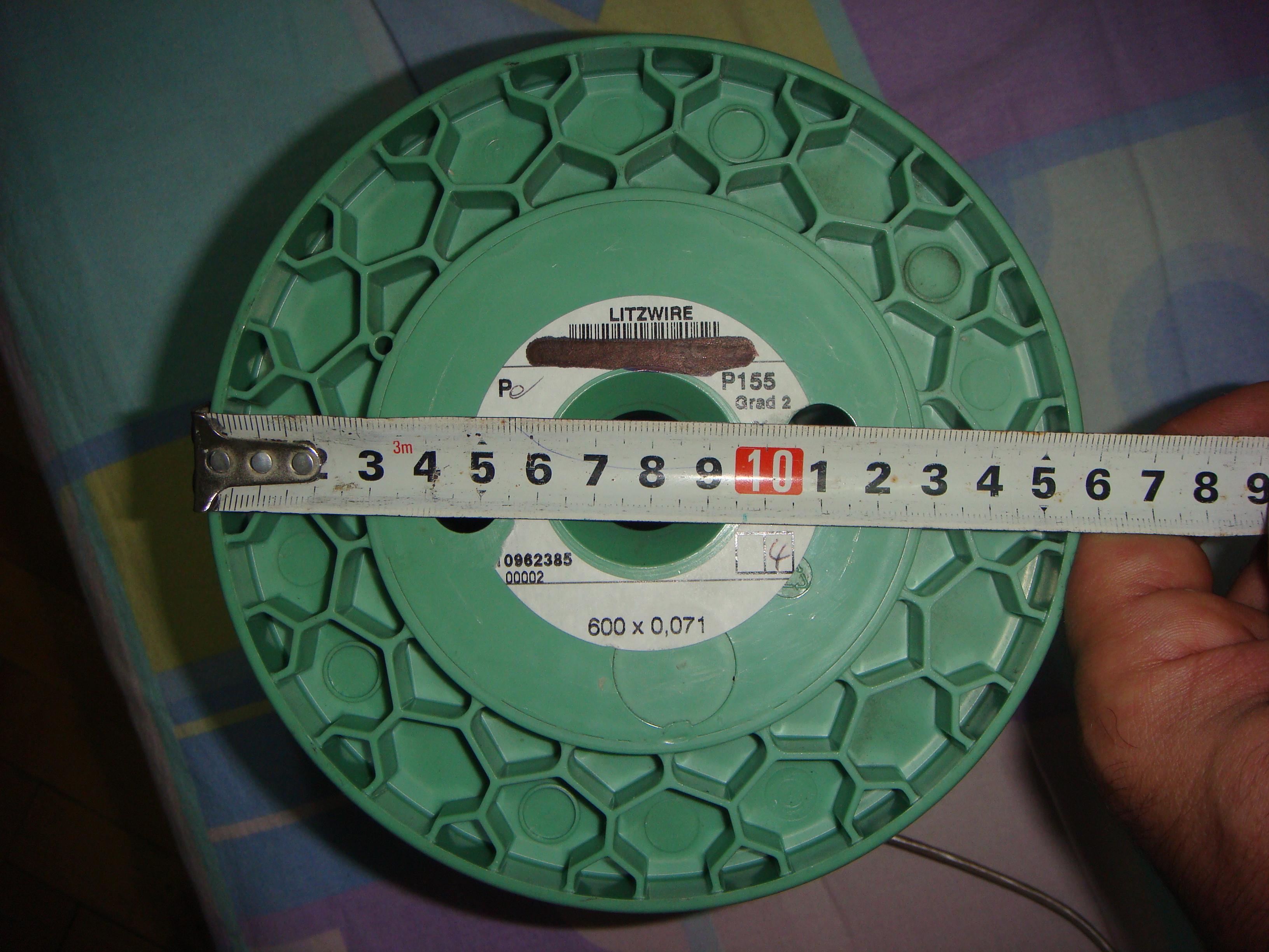

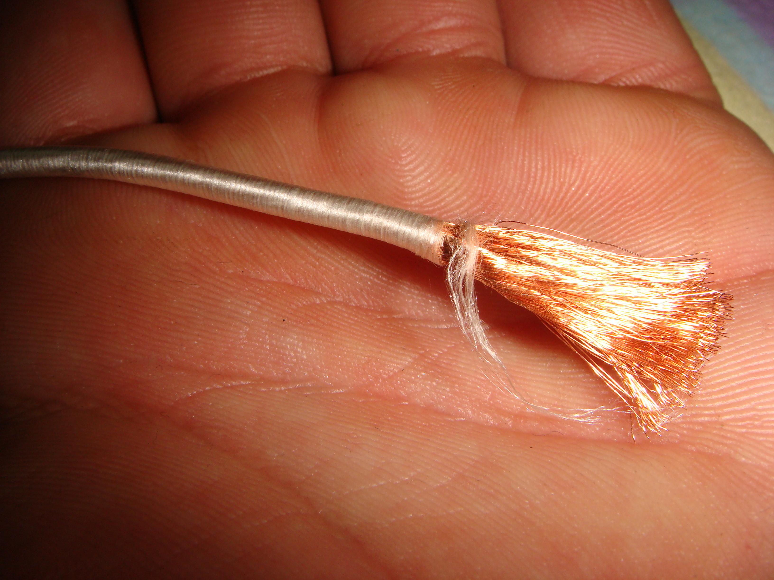

The monster is in MY HANDS
Also the litzwire is in my hands.:spin:
3 kilos of 600x0,071 litz Cu-Em (insulated between them) and textil external winding.
I just wait a little free time, and go further with the project.
Opinions about litz?:bulb:

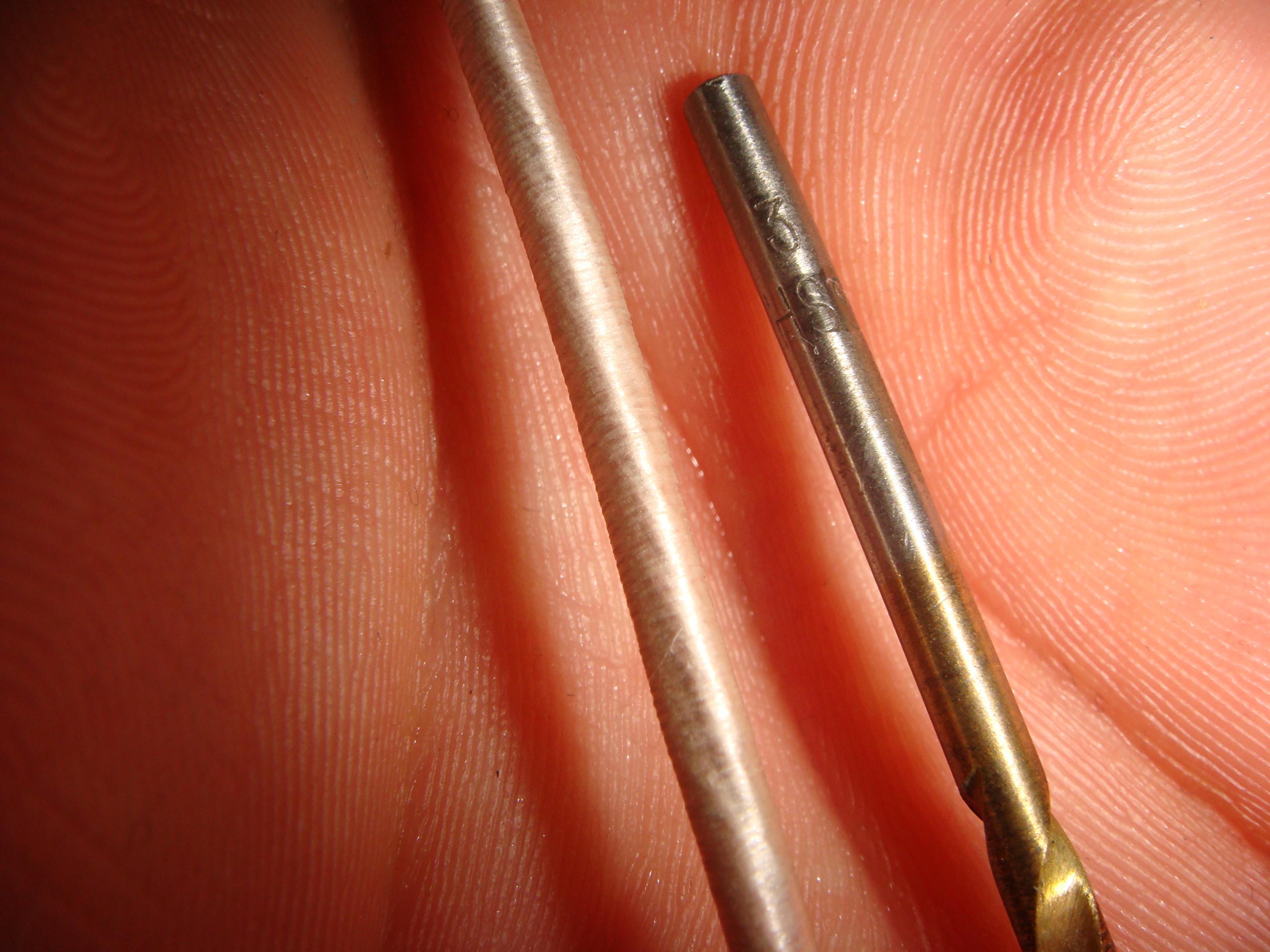

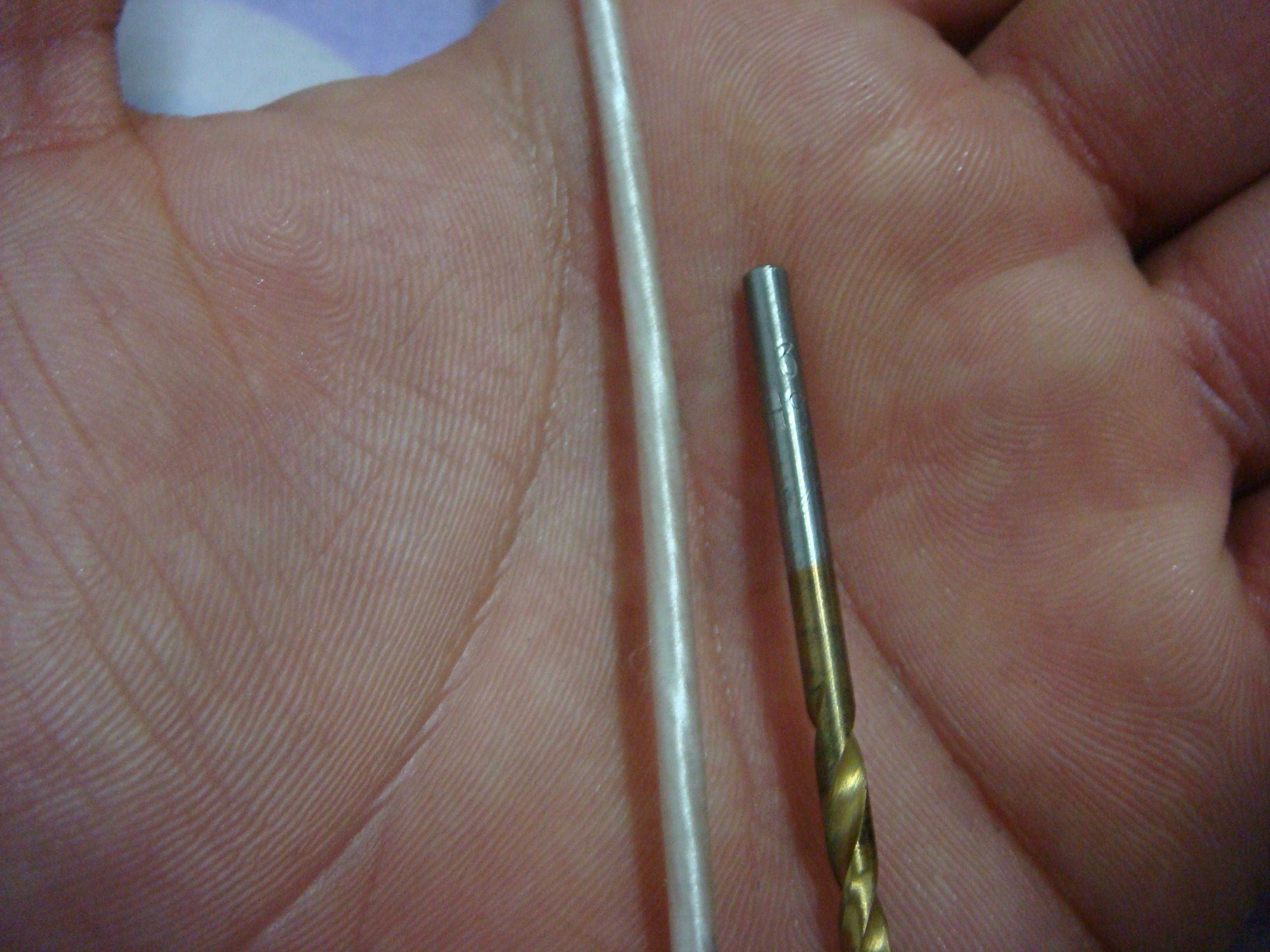

Comparation

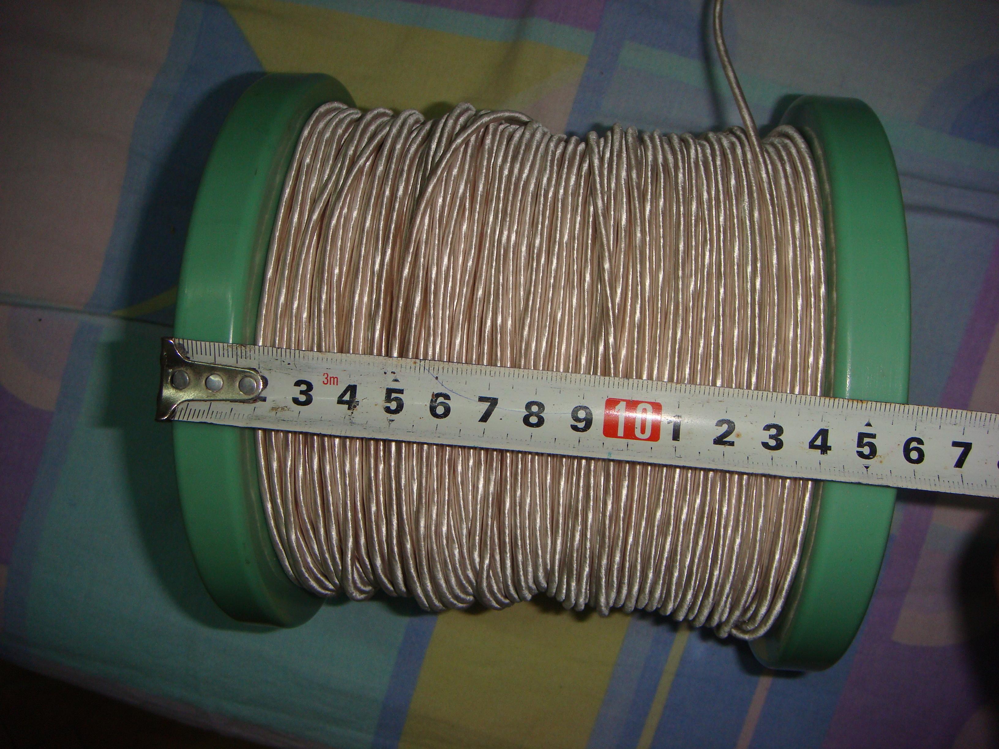

Those are the real dimensions of reel and litz.
Comparation was made to an 3mm drill spiral
Price around 200 euros ,all included, delivered exactly at my door (it woked me up from sweet dreams :cloud9:) , today al 11:30 Bucharest hour.

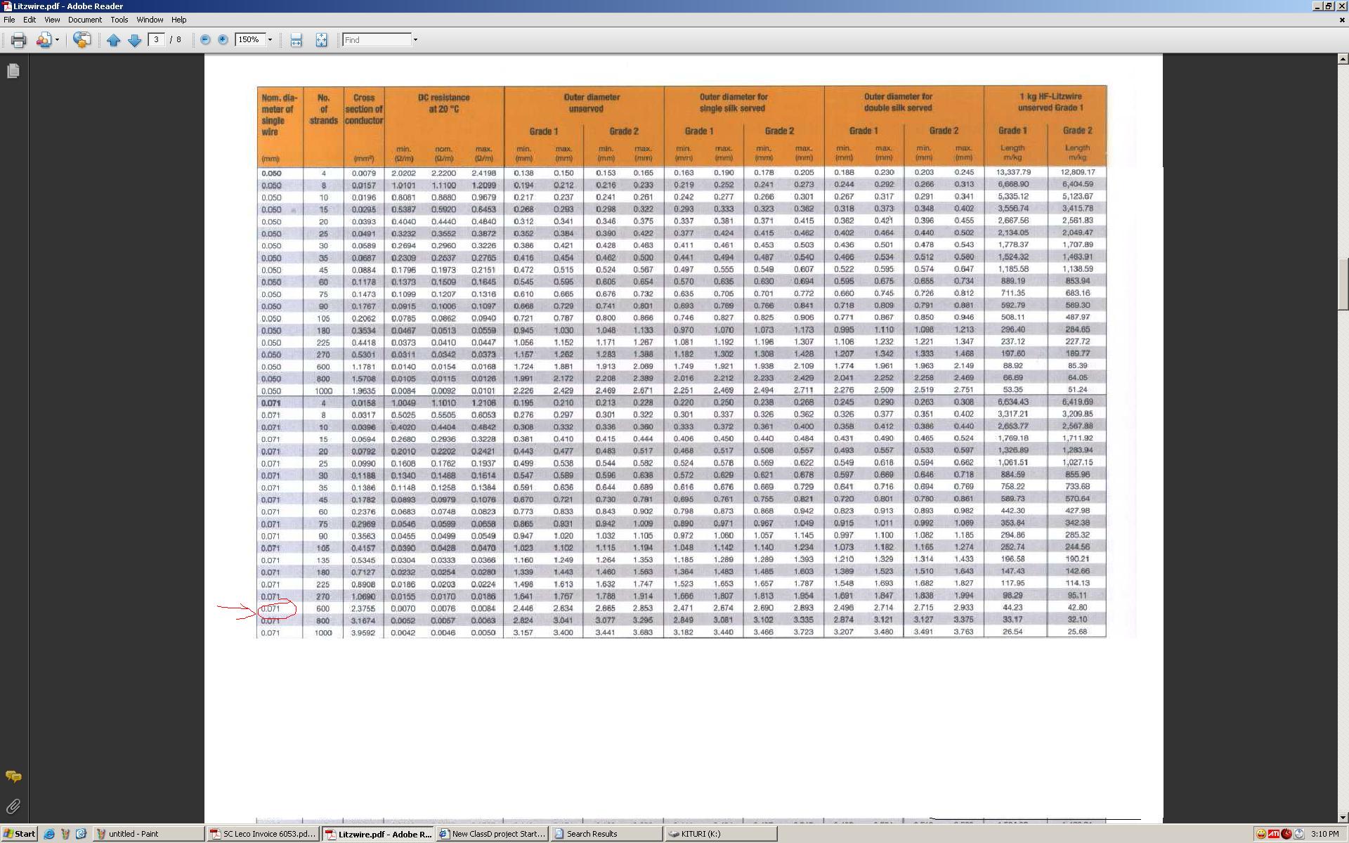

Check the parameters tabel and share your opinions.
It will be used for Class D Output Coils together with those T225-2 toroids from Micrometals, also for SMPS on trafo winding (ETD59 core) and PFC Core Coil too (T300-66).
