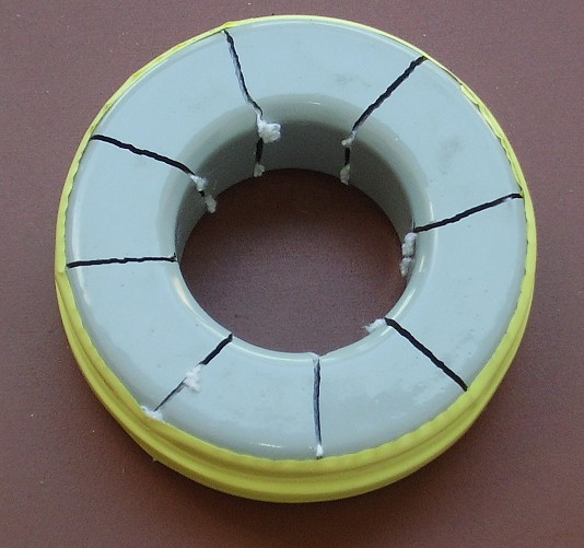

Pafi said:
A gapped toroid is a good idea, I use it too. You need 1.5 cm^3 of air gap approx.
In a bigger core the air gap can be higher too, and it's neccessary for this high power. Many small gaps are better then one big.
Where did you buy this core, for what price?
How "Many small gaps" on a toroid core?
I don't understand, can you make a small drawing?
How can I calculate the aprox 1,5 cm^3?
I have from a friend, I paid around 5 euros/one.
DjLeco!
Vairgap=0.5*I*I*L*mu0/(Bmax*Bmax)
