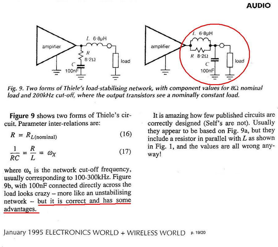

Well, I wouldn't say it's plain wrong, rather I don't like it for several reasons, as well subjective and objective ones.
Subjective:
1. It's weird and his argument (better HF immunity) makes no sense to me.
2. It blurs the understanding of NDFL essentials.
Objective:
1. A high quality Zobel capacitor is needed as this one is part of the FB path.
2. To avoid long FB leads, the Zobel network has to be placed on the PCB. Generally, this is NOT the best place for Mr. Zobel.
3. It limits the choice of possible other Zobel networks. For example, it excluded the use of Cherry's preferred one. 😀
But there is one more thing that bothers me: that magic factor sqrt(3)-1 (=0.732).
For better phase linearity? I don't believe it.
From Cherry's articles in Electronics World (Jan 1995 and July 1997), it seems that the load stabilising network in the design posted by Godfrey and Janneman is Cherry's preferred network.
I was referring to another 'preferred' network 😉, see the snippet below from Cherry's article in EW+WW.
As you see, this Zobel network is incompatible with his peculiar implementation of NDFL.
By the way, NDFL is from the seventies, not the eighties as you say on your webpage.
I guess you were referring to this article "A New Result in Negative Feedback Theory...... (1978 July), right?
Thanks for pointing this out.
