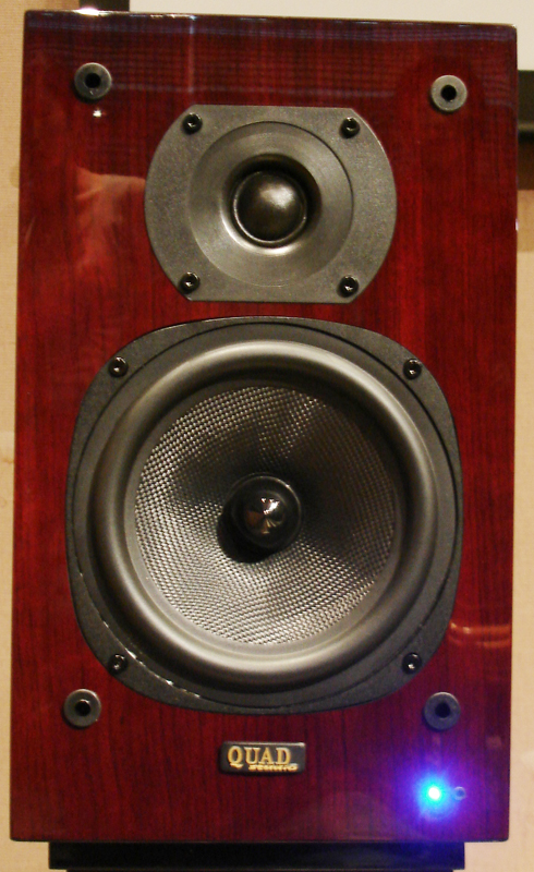

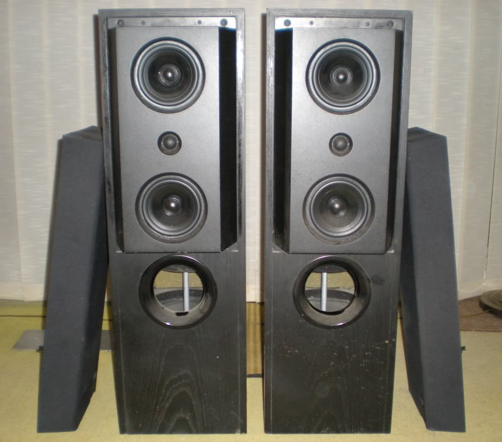

OK, re the sound quality, I have small loudspeakers (Quad 11L), my 'big 'speakers..KEF104.2 didn't make it our hear unfortunately. The rest of the rig is Arcam Alpha 5+ with Tricord clock used as a transport, Burr Brown 1702 based DAC (their top end demo board to be precise one of the few they made that sounded any good!) using 4 X 1702 per channel, and a sophisticated de jitter circuit and a modified Kinshaw Perception pre. Hugh's heard it both with his amps, my amps and the Cherry. By comparision we concluded the Cherry amp is a bit 'flat'...although I suspect we both like tubey, me rather more than Hugh I have to say...!
The power supply is 2 X 150VA toroids and around 10,000u per rail, the supply voltage is +/- 37V. The 10,000u is 2X 4700u split with 0.1R. I have tried various permutations of PSU and they make very little difference.
