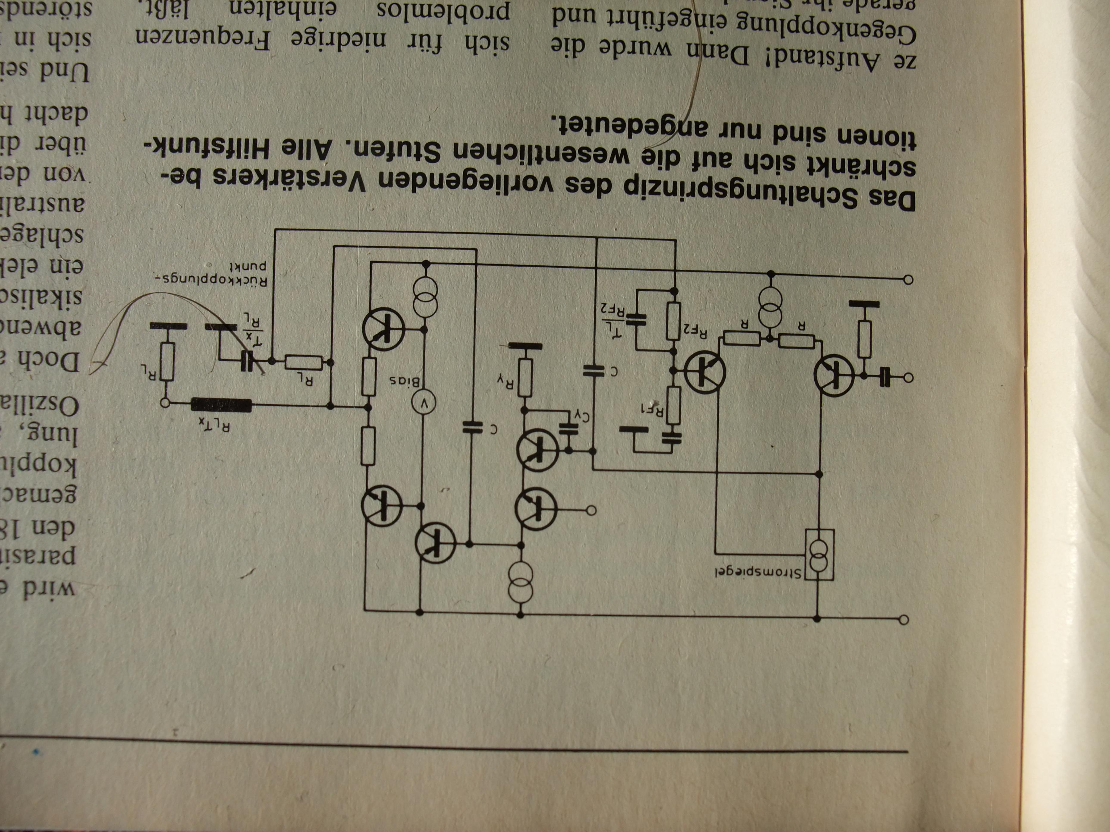

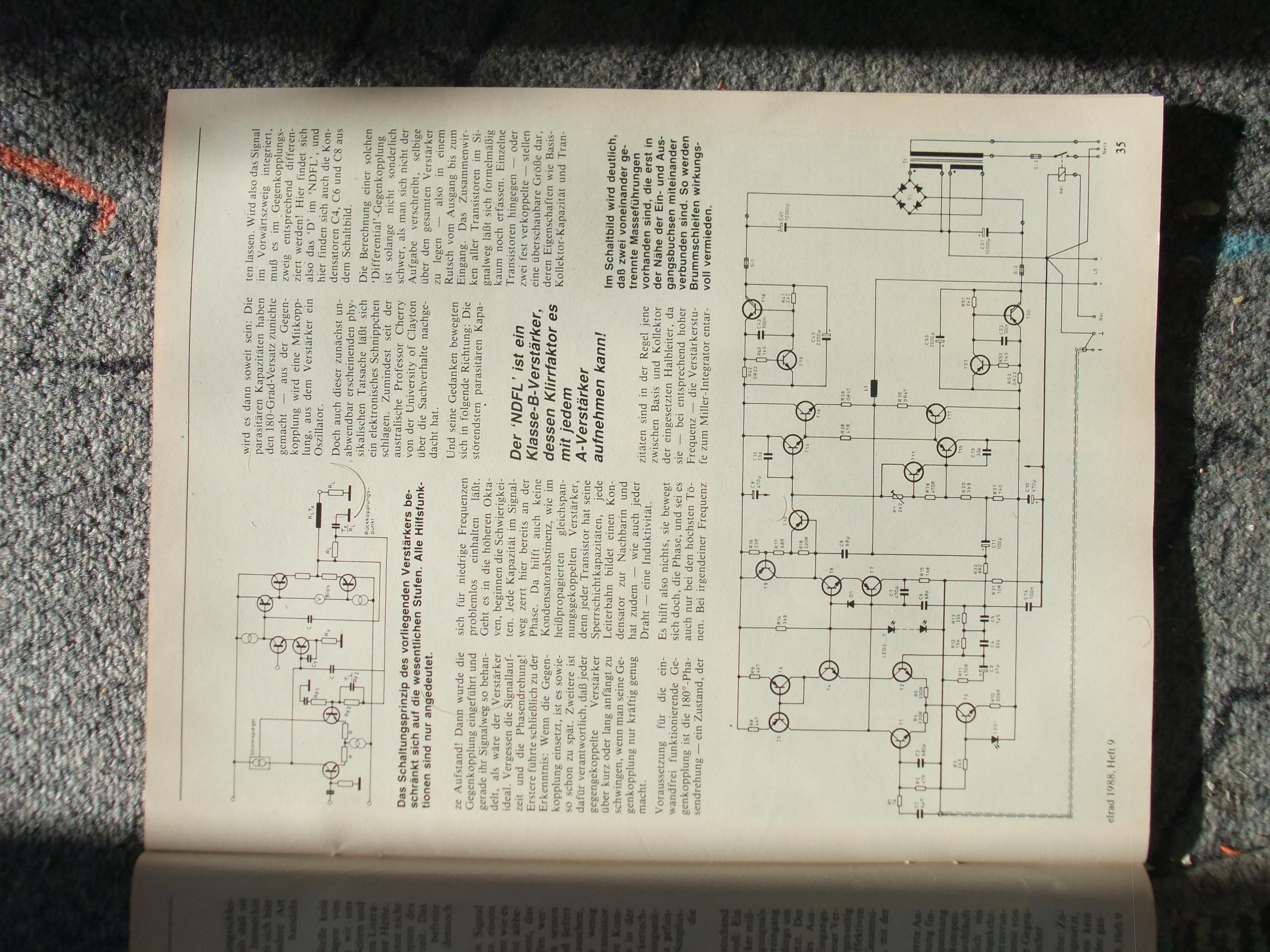

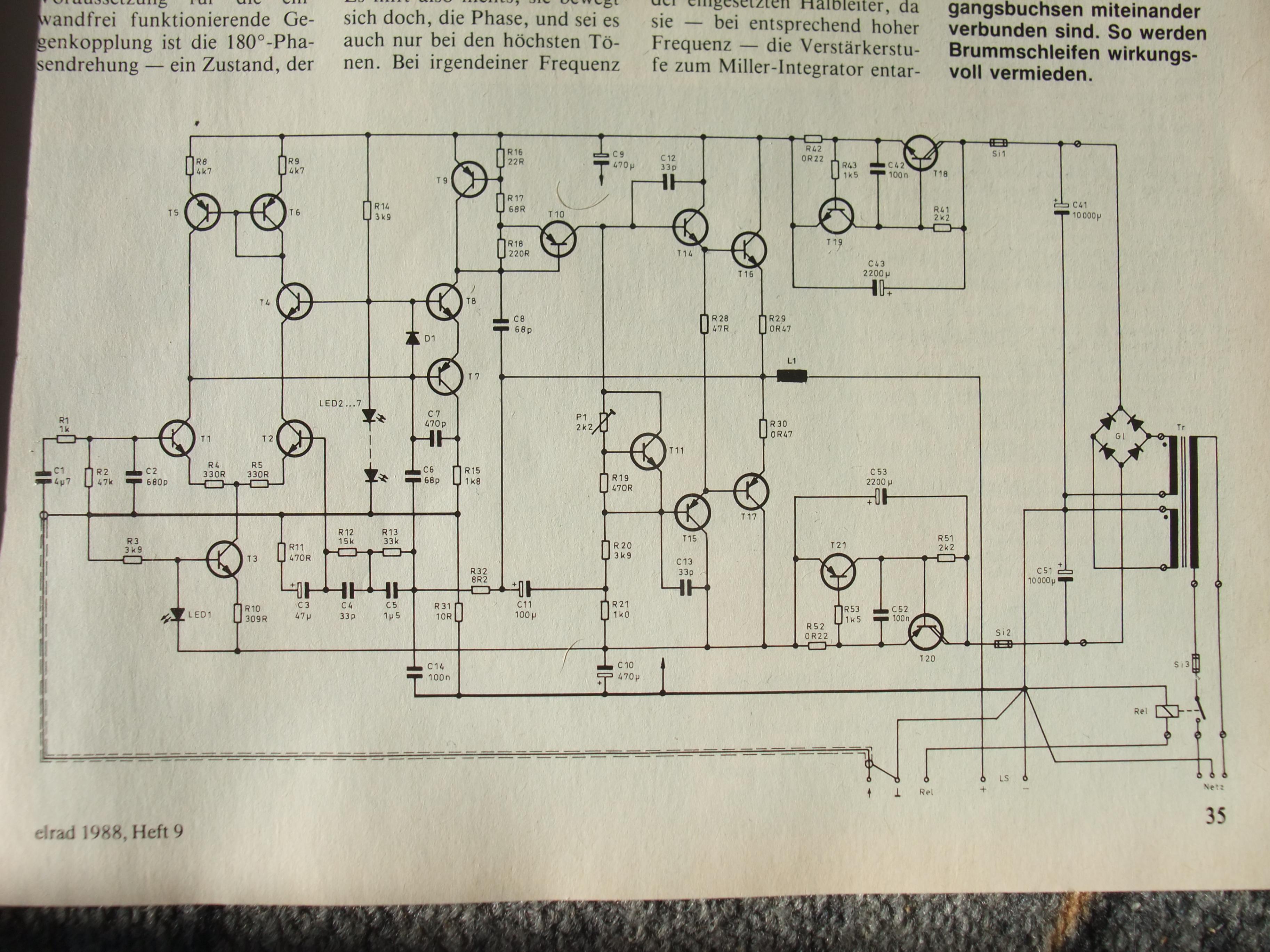

Check out the articles in follow issues from German's vintage magazine "ELRAD":Need a good amplifier circuit NDFL-type.
December 1983, February 1984 and March 1984 (amplifier project include PCB).
Maybe one of the members can upload this as copy.

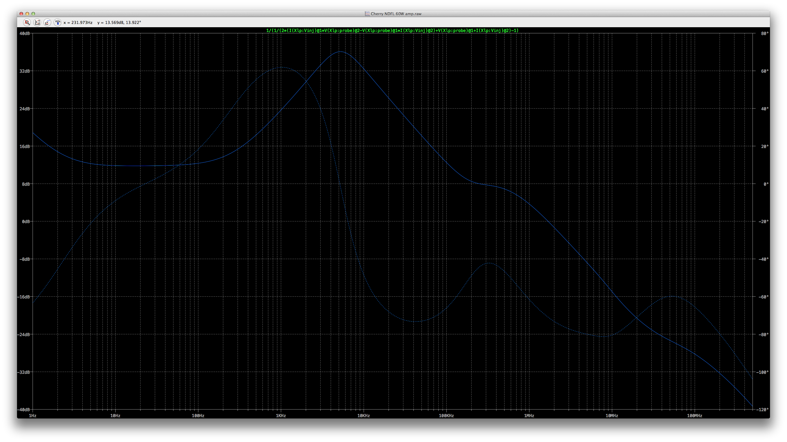

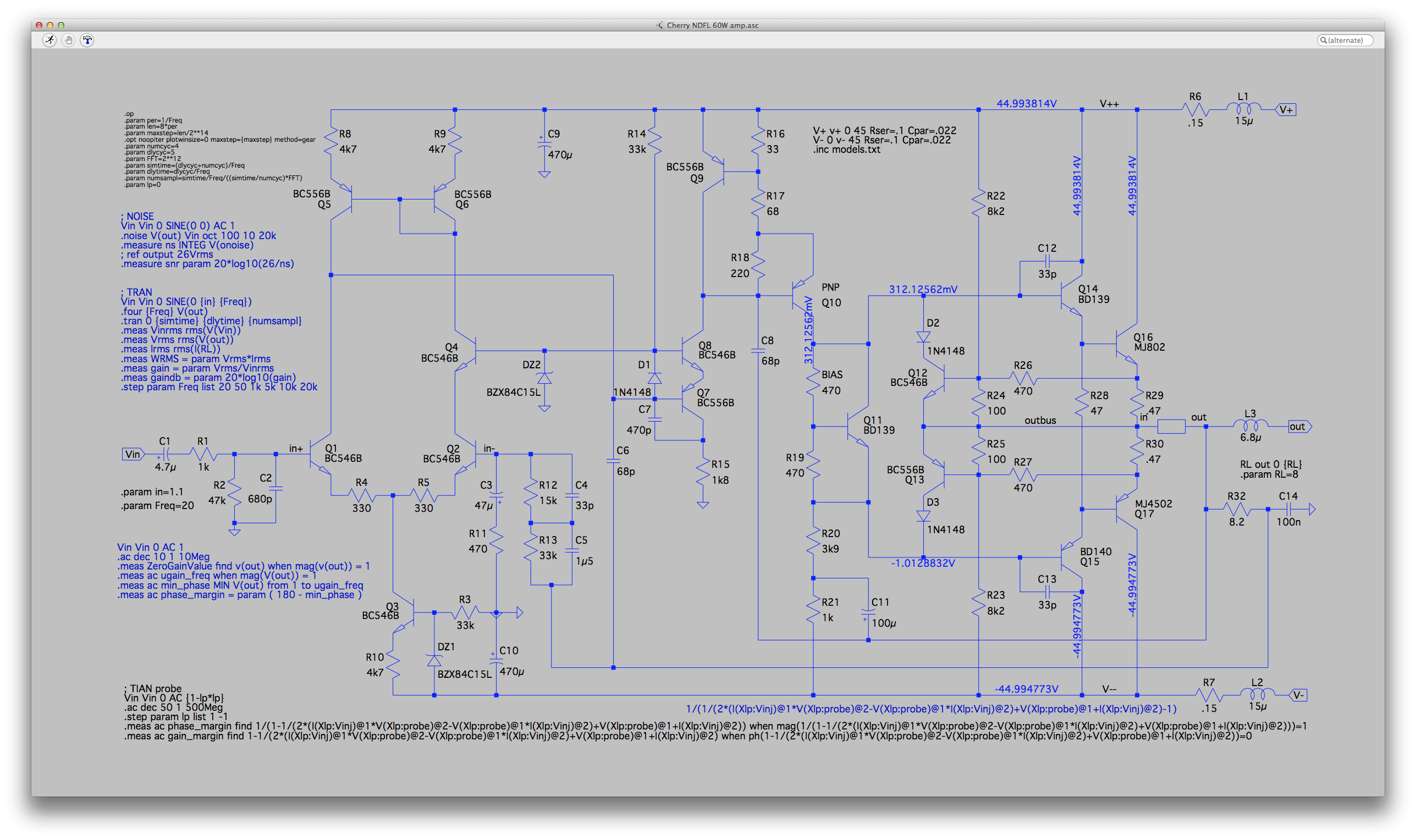

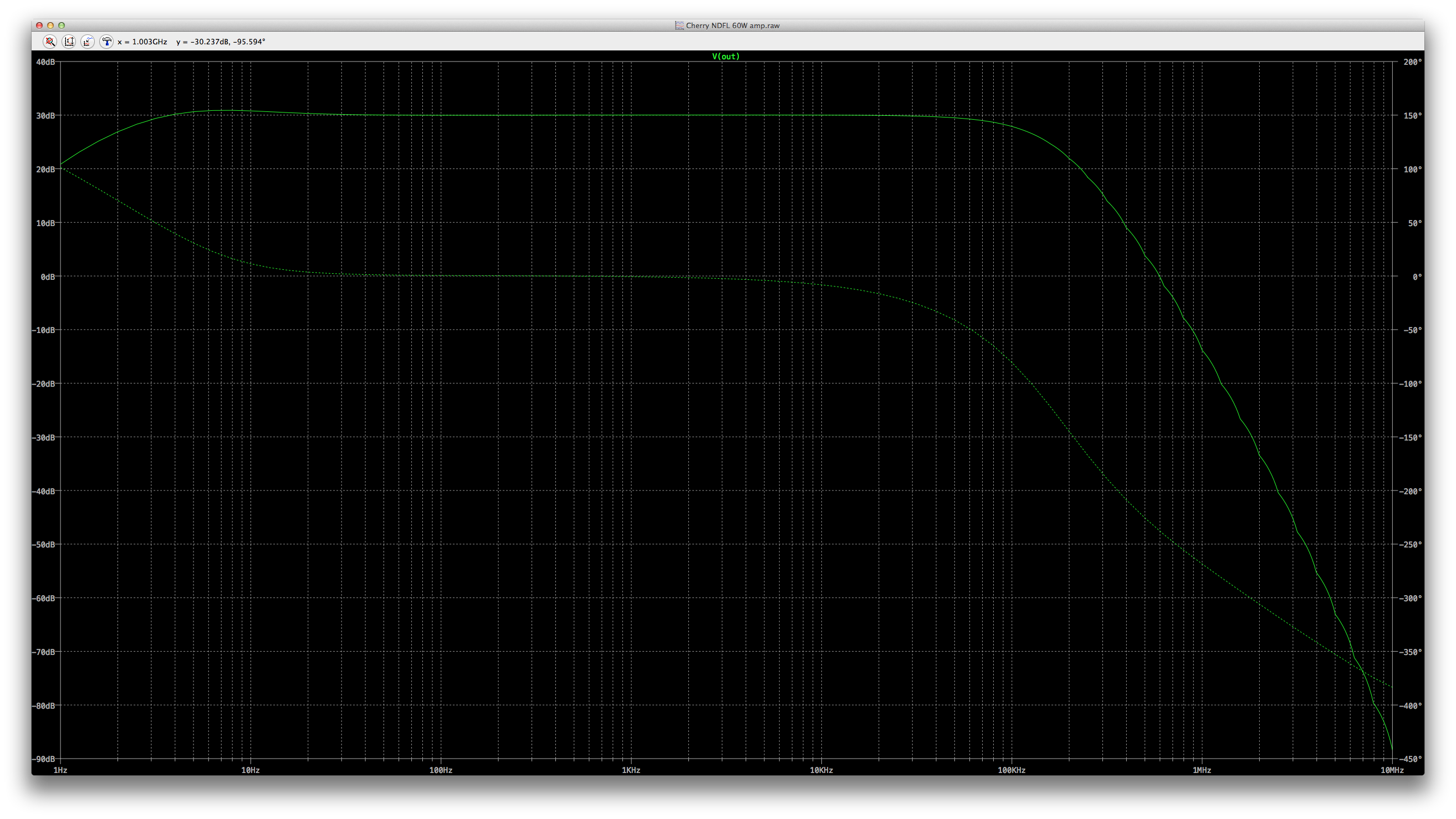

I made a sim of that NDFL 60W cherry amp from that old ETI article, using the models I have, BD139/40 for drivers, MJ802/4502 for outputs and the rest is just ltspice's library BC546C/56C.
It's not really giving stellar results, but decent.
However what I don't understand is how the open loop and closed loop gains compare.
The closed loop gain looks pretty good, with nice and flat response over a good audio band and about 30db of gain. There is a tiny bump in gain at the low end before rolling off..
But what I don't understand is what the tian probe shows for open loop gain, which is overall much lower than closed loop.
How can that be? Or Am I not placing the tian probe in the right place?
What I find interesting in that open loop gain plot is how the phase shift is "forcibly" kept from going beyond -80 degrees and that is way up there in frequency. Giving a serious amount of phase margin (above 100 degrees).
I see 3 poles. Is that right?
Those NDFL really control that phase shifting...
But Am I getting the real picture? Should that tian probe be moved somewhere else?

As far as I recall E.Cherry did not state that the 100kHz to 300kHz rule applied to the output inductor.Then using the R/L, with L at 6.8u being 0.0000068, calculates to a little less than 1.2 million, so again, somewhat close to 1.2mhz. Again not 100-300khz, but the 2 results are rather close to each other anyway, just not what is stated it's supposed to be.
So where did I stray?
It simply must not significantly impede the upper end of the audio band. One could say that requires F-3dB >40kHz, but equally some may impose an F-3dB >10*20kHz.
It should also sufficiently attenuate HF being fed back into the output and thence to the -IN node.
I wonder if the "bump" in the LF response is due to your error in selecting the LF correction R||C?I made a sim of that NDFL 60W cherry amp from that old ETI article, using the models I have, BD139/40 for drivers, MJ802/4502 for outputs and the rest is just ltspice's library BC546C/56C.
R13 =30k and C5 =1u47F, not 33k & 1u5F
The lost OLG must be down to using the wrong formula (posted in green at the top of the third pic).
I don't think, that the NDFL approach and thus the low value of THD is the reason for the mentioned sound character.Hi Tief,

DIY Instruction ELRAD September 1988 "No Distortions For Listeners"
here the jpg copies:

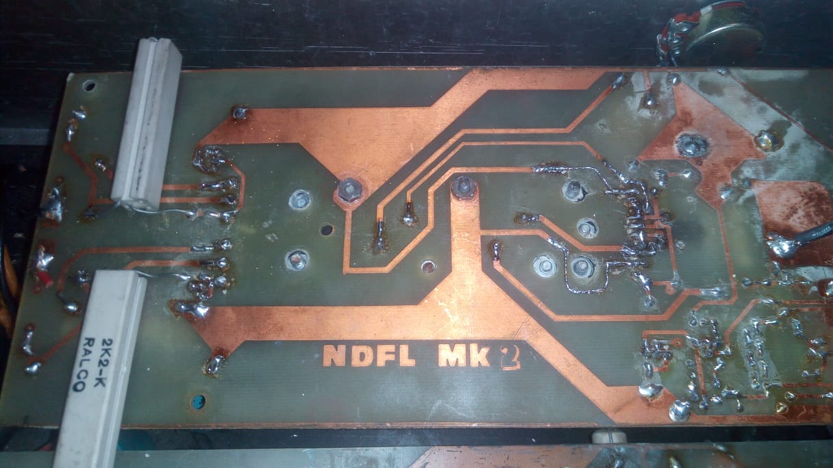

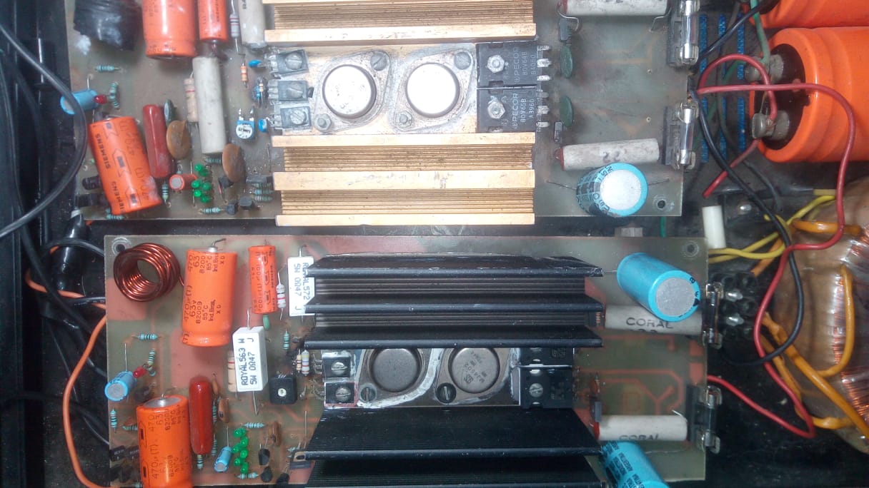

Hello, nice to participate in thfis forum.
Thanks for sharing the magazine photos, I lost the magazine and the circuits.
When I`was in College, in the 90s, some mate bring me a magazine`s copy from Germany and I decide assemble the amplifier. Some photos attached.
I used it for years, excellent sound, but a couple of years ago one channel burn (was repaired) and now the other channel died due to components aging (I should had used better resistors and capacitors).
Because of quarantine I have time to repair it now...
