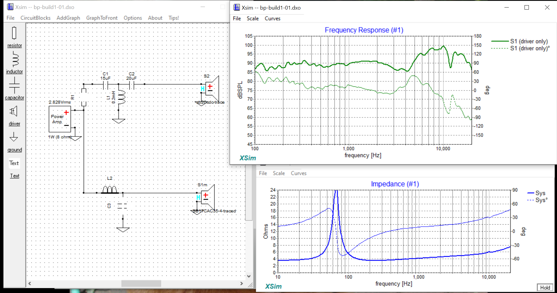

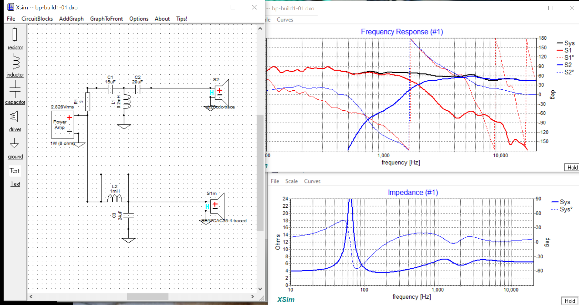

You can use a second order topology circuit on the woofer, and tame that high frequency peak... if you use a small cap in parallel with the woofer inductor. I learned about this from someone on this site, but I don't remember which thread.
image 1 is the SB17CAC35-4 with no filter (just driver response). you can see the 10 dB peak between 4k and 10k.

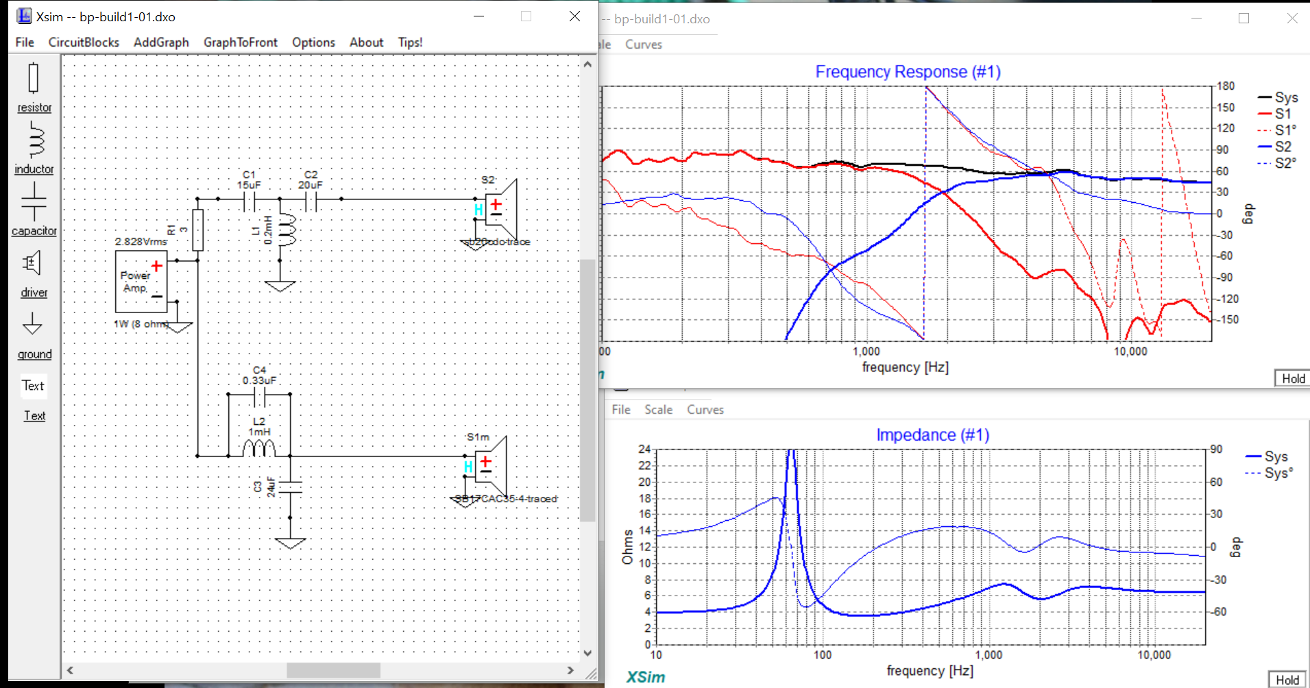

image 2 shows a 2k crossover to an SB26CDC tweeter. You can see the woofer's response between 4k and 10k is affecting the output.
image 3 shows the same crossover, but now with a 0.33 uF cap in parallel with the inductor. you can see that it zaps the woofers high frequency peak quite well.
Xsim allows you to "tune" the value of that cap to get exactly the response you want. In this case, any value from about 0.28 uF to 0.36 uF seemed acceptable.
I wish I could remember who showed me how to use this technique, but I don't remember.

I use the SB17CAC35 and the SB26CDC in an active system, and I am extremely pleased with the result. I use a DSP 4th order crossover at 2kHz.
The above circuit simulation was made when a friend was contemplating using the same drivers in a passive system, and I was exploring if it was feasible.
So this filter circuit is just a feasibility study, not a final crossover. I did not model the insertion loss of the inductors, or model the baffle step gain.

Very cool Hifijim. Any idea why that cap would do that? I'd almost expect the opposite since we're basically adding a high-pass filter to the woofer, although it may be at higher frequency than the peak. At best I'd have predicted it to have no effect on the peak, and at worst I would expect it to make it worse. It's a great trick it looks like, but I'm having trouble understanding how it works 🙂
Nope, I have tried to puzzle that out myself. I am not a electrical engineer, so I gave up on trying to understand it... But it works...

There are series and parallel LC and RLC circuits that can be "tank" circuits or "notch" circuits depending on how they are used. I have forgotten most of the detailed theory; guess this gives me an excuse to do reading and homework while waiting on inductor and capacitor parts deliveries expected today. My guess is the circuit has a very high "Q" that exactly cancels the un-wanted peak. In circuits, the "opposite" is a complex conjugate; that includes both magnitude and phase. To exactly cancel an un-wanted signal; both the real and imaginary parts are needed; it's not as simple as opposite polarity (-180 degrees) in a purely resistive circuit...
