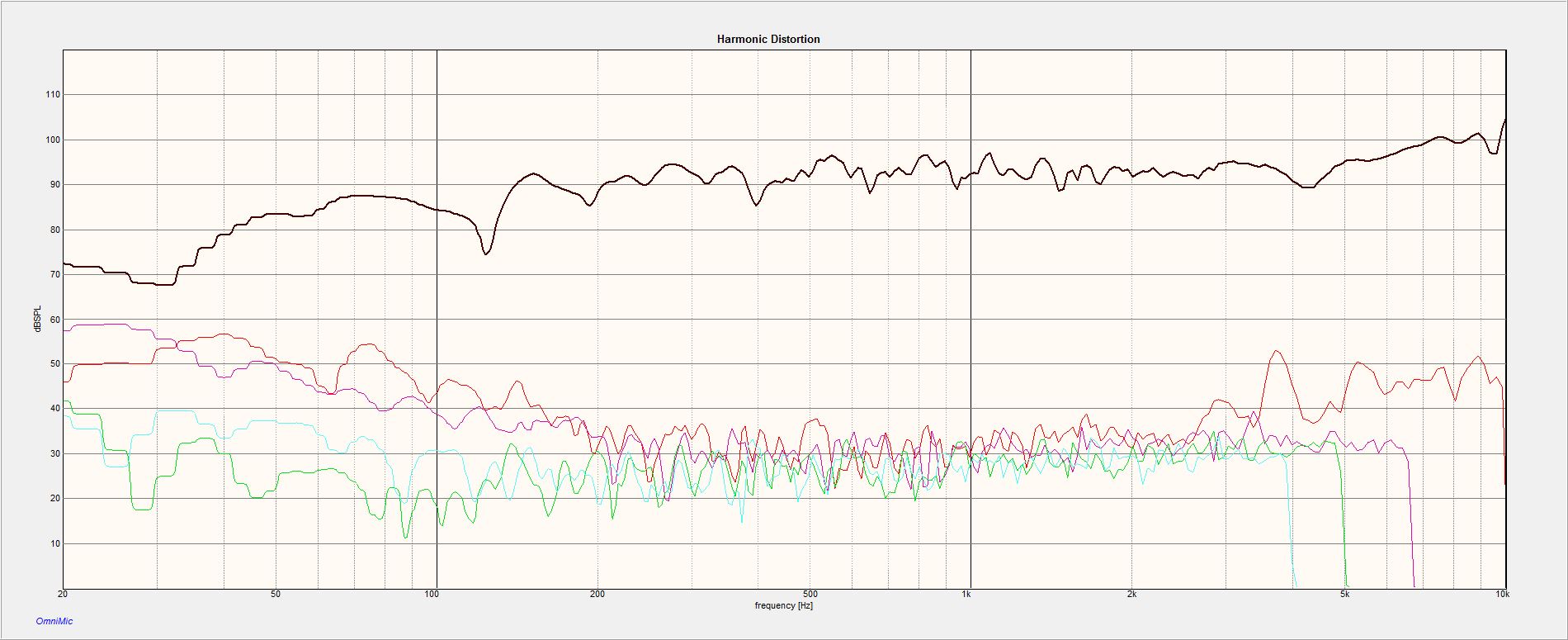

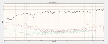

Interesting comparison. You can add that at least from the SB provided datasheets, the behavior of the NAC/NBAC drivers and the CAC drivers is basically identical. If the 'ceramic' layer is anything other than cosmetic, it isn't showing up in the datasheet measurements. Unfortunately, hificompass hasn't tested a CAC, and I'm not aware of any other apples-apples comparisons with more detail than the datasheets.

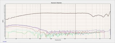

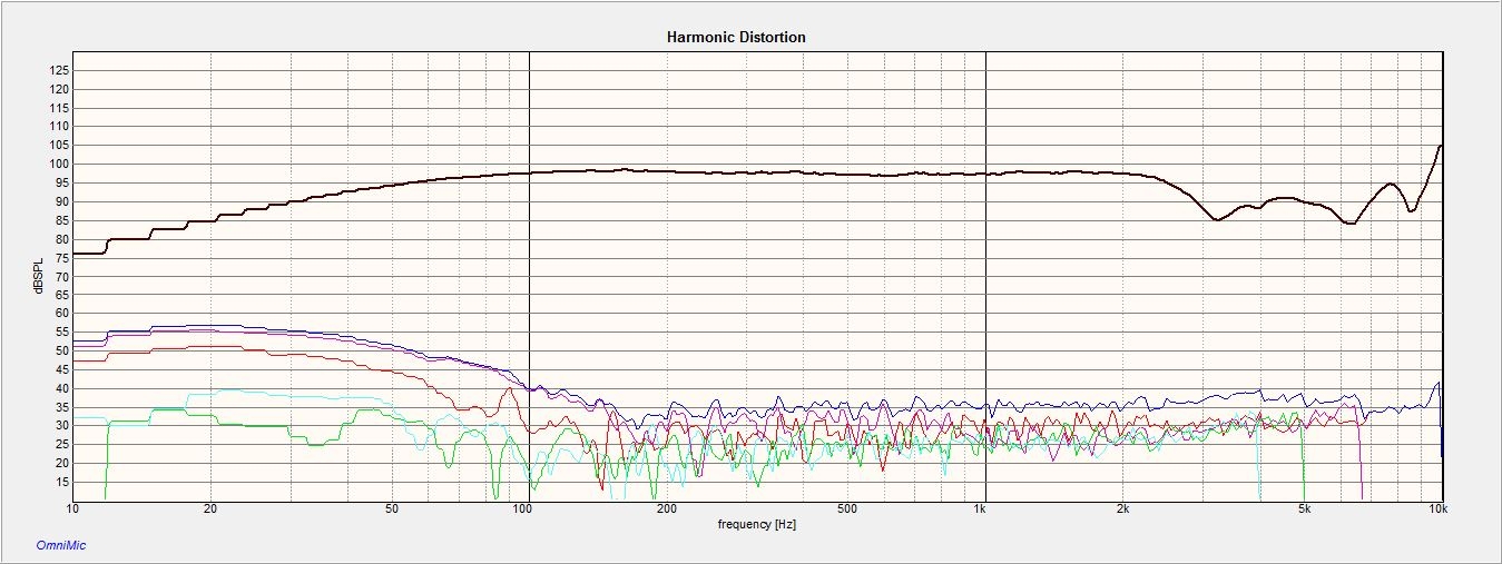

Curt has measured both the SB15CAC and SB17CAC. We used the SB15CAC as a mid in our Travelers design.
SB15CAC first...
Basically identical distortion measurements. The SB15CAC can cross higher.
HTH

That looks very good. Usually I never see so flat a FR or distortion curves... it's almost not a curve 😀
Perhaps i don't know how to grasp your curves, but is the THD an astonishing 60dB below the speaker output in the mid-range? .1%?Curt has measured both the SB15CAC and SB17CAC. We used the SB15CAC as a mid in our Travelers design.
SB15CAC first...
B.
B.
Yes, that is correct. Curt is the "brains" of our collaboration and the resident crossover genus. So, any in depth questions will be deferred to him.
The quick answer beyond yes is the CAC drivers are extremely low distortion and well behaved with exceptional detail and accuracy. Yes, I'm a big fan of the CAC's.
