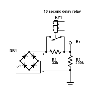

The voltage after the rectifier is good. Just the ones in the amp are stressed for a few seconds... I'm considering just using a 6Z4 in series with it. If I run it from 12V and use a 10R resistor for the heater, the ramp up should be pretty slow.
I'm just not looking forward to ripping everything down from the rack again...
Nope.. The quadupler can put out 700V with no load, and the PSU caps can handle 900V, but the in circuit power filtering caps are only rated to 600V. They are electros. https://canada.newark.com/epcos/b43541b8476m000/cap-47-f-600v-alu-elec-snap-in/dp/16AC3106
So either I make a zener string, or use a soft start (or put a big load resistor on it).

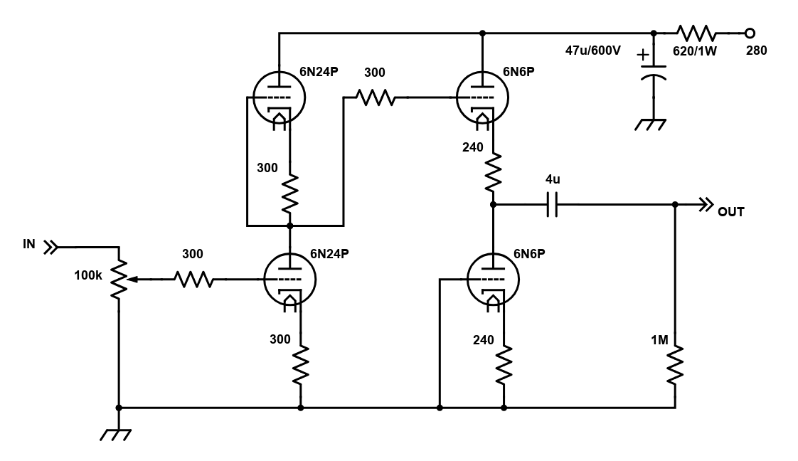

The active loading looks like the following. The first top triode and second bottom triode could be replaced by resistors or CCS like 10M45 from IXYS...

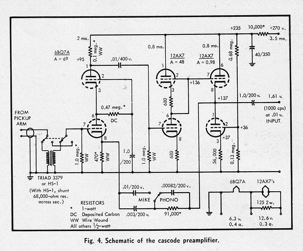

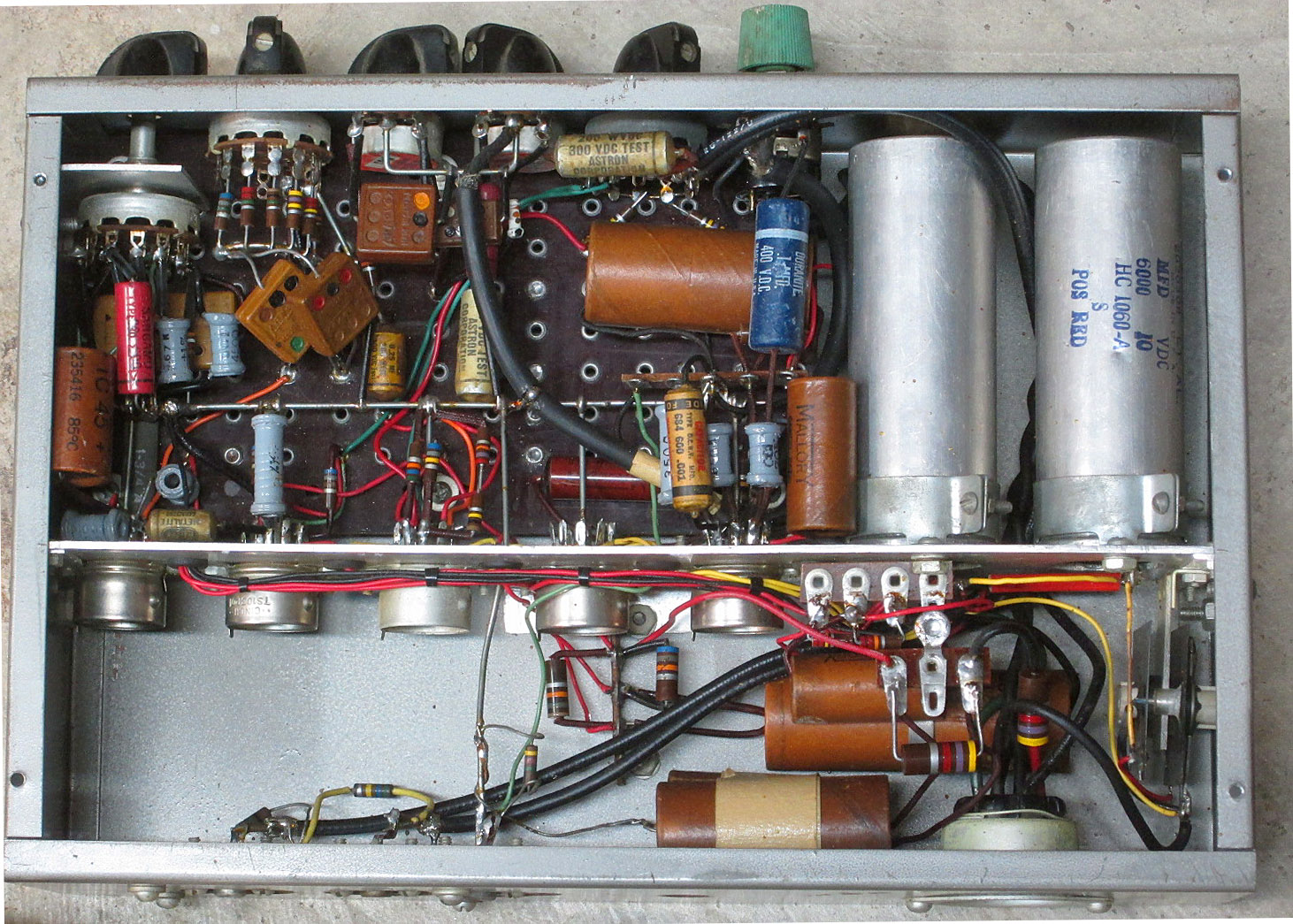

Here is what you are calling 'active loading'. This one built around 1956 while I worked at Ferranti R&D. The original cct was published in Audio Magazine about that time. The front end is simply a cascode connexion. The noise is down in the microvolts.
Still here on the shelf, hasn't run in years.
Amazing! I mean it's similar anyway. Mine has no feedback loop etc and it's certainly not cascode...
What I call "Active loading" is effectively using the second triode in the envelope instead of a resistor. Better performance than the resistor. In this case like a constant current sink/source, and most of the waste heat it radiated above the chassis. Plus the distortion curve supposedly cancels.

The first stage is a cascode, used for low noise but gain like a pentode without pentode noise. Triodes have less noise than pentodes, no separation of cathode current by a screen on the way to the plate.
The 2nd stage is a mu follower, low D% since the top triode looks like a current source load. The 3rd stage is not quite a White CF, the bottom triode is not driven by the top. But response is good for both +ve & -ve going transitions, something an ordinary CF does not do.

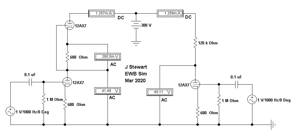

jhstewart9, 2nd stage is not what I think of as a mu follower (lower anode AC coupled to upper grid, output from upper cathode); which old textbook has an analysis of this stage?
It is deceiving, the 2nd stage is a minimal mu follower. We would usually see in addition to the 680R biasing resister another resister is series connected to the bottom plate. And then a cap back up to the top grid.
The cct in the 2nd stage has a 680R between the grid & cathode so the upper tube looks like a load of {(mu + 1)*680 + rp}. The 680R cathode resister about doubles the load as seen by the lower tube.
So stuffing the numbers taken from the RCA data sheet into your HP, TI or Casio calculator & turning the crank we get
{(100 + 1)*680 + 62500}R or 131.18 K. Looks like the top tube is an active load, not passive.
Otherwise the load would simply be rp, 62.5K, its not.

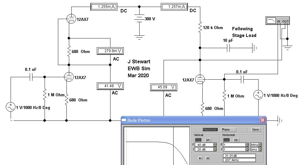

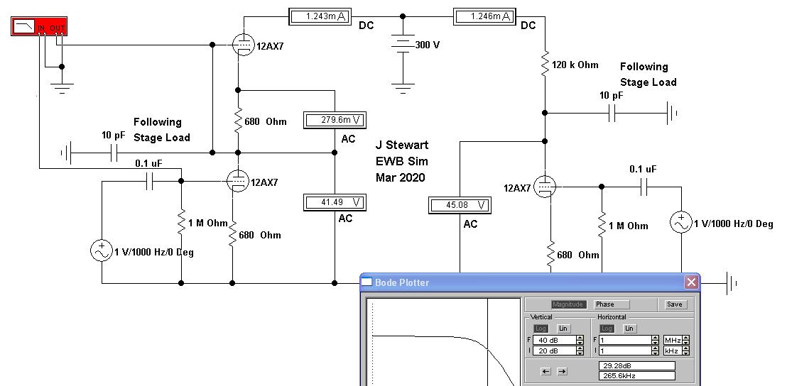

Frequency Response Comparison
The cct vers using the active load is marginally better than the vers using a simple resistor load. The 10 pF load is arbitrary but in any case very low since it goes to the grid of a CF. Rest might be stray C in the wiring.
So in this example the R load is down 3db @ 207 KHz
while the active load vers is down 3db @ 265 KHz.
Either would be OK.
