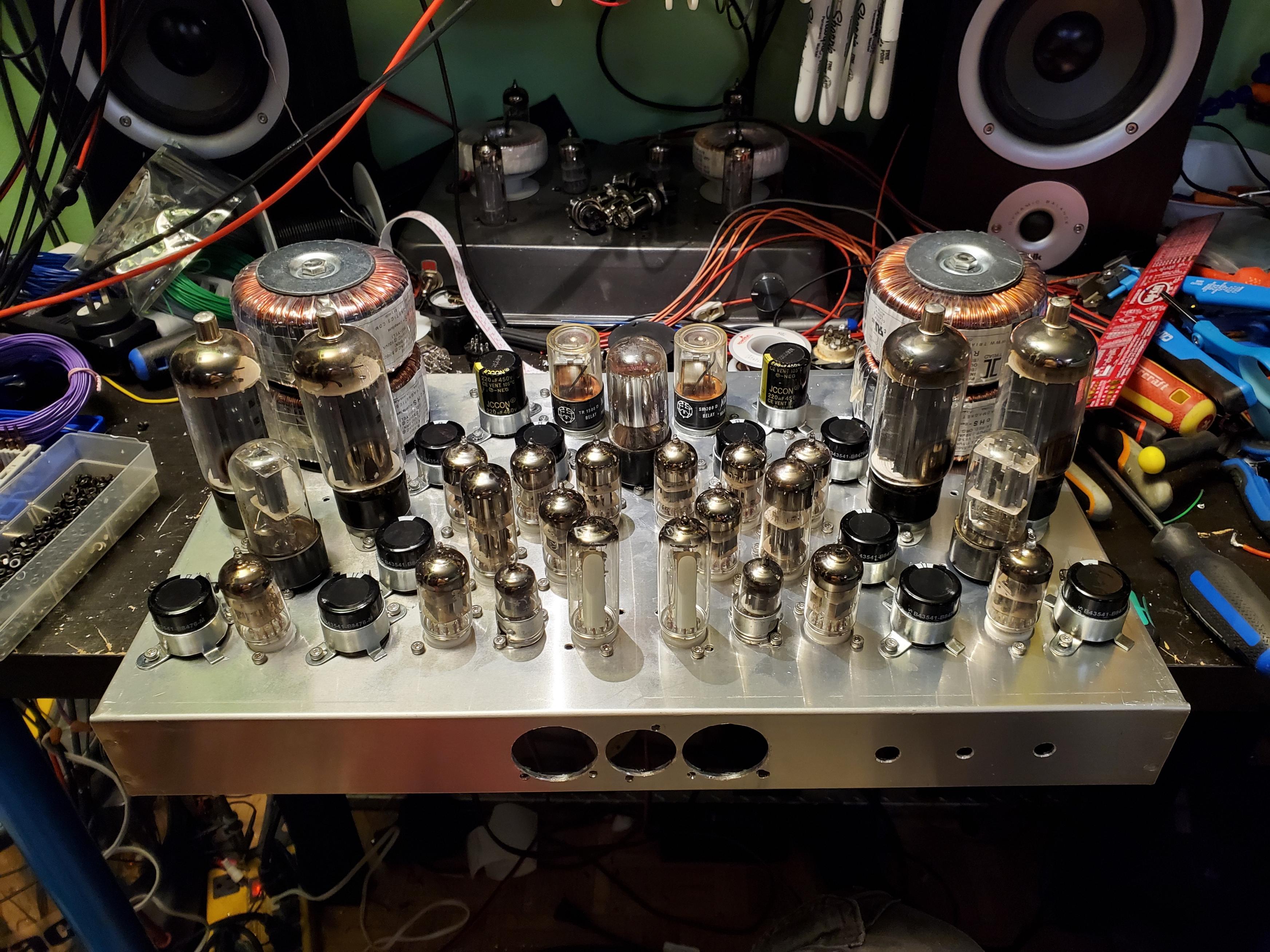

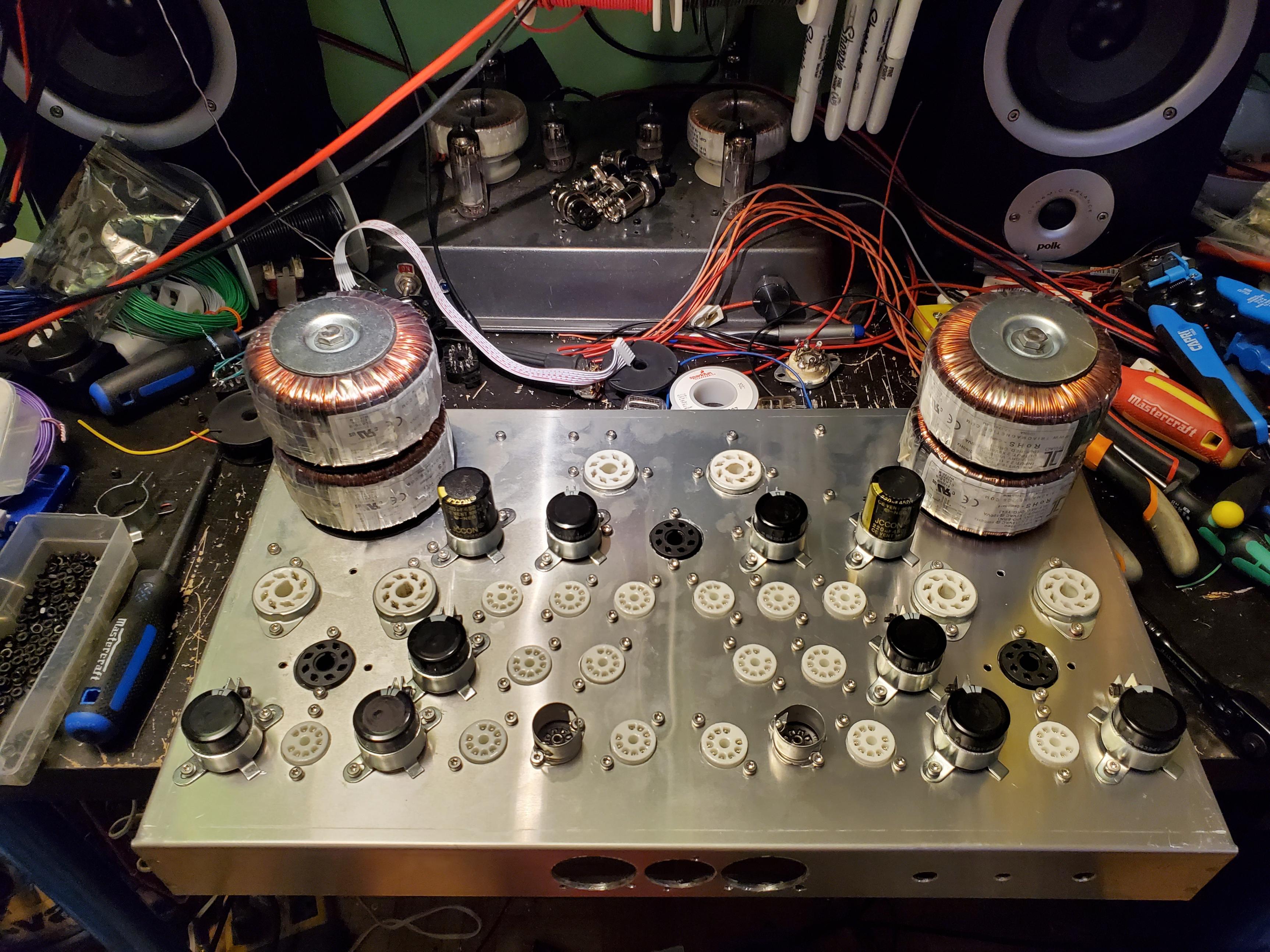

New build: 36LW6 integrated amp with phono avec SMPS/DC Boost.

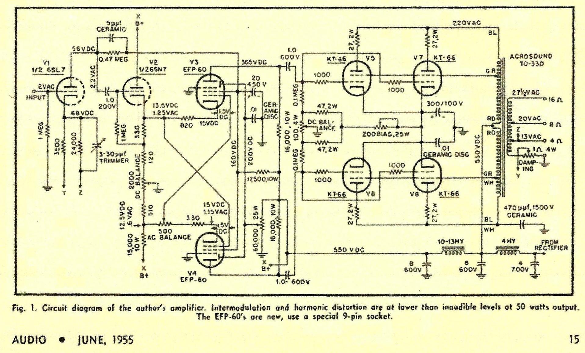

Somebody actually built an amp using EFP60s as the driver stage. The EFP60 has a very large gain/BW number, makes a great driver.🙂

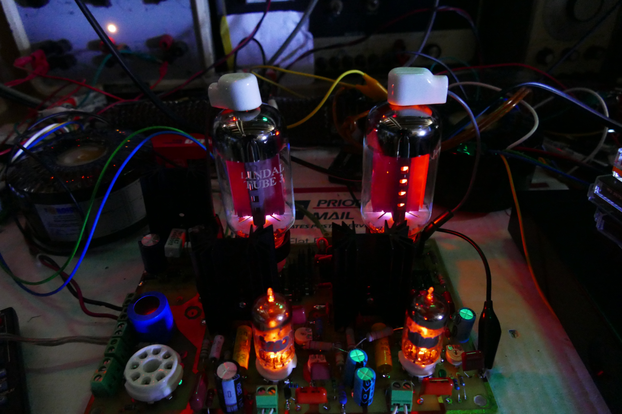

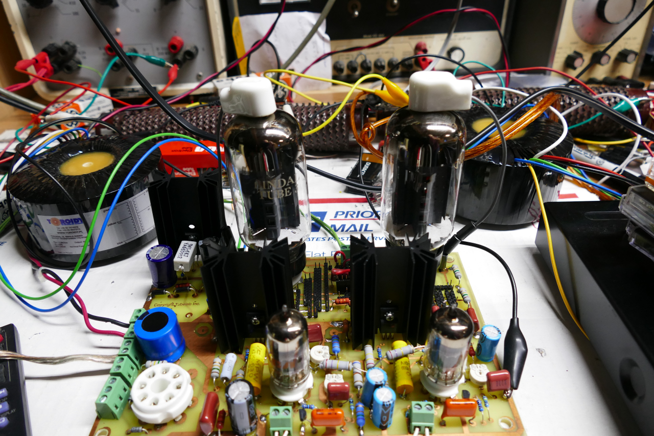

So a short update:
I think it was a bad connection to the biasing board.

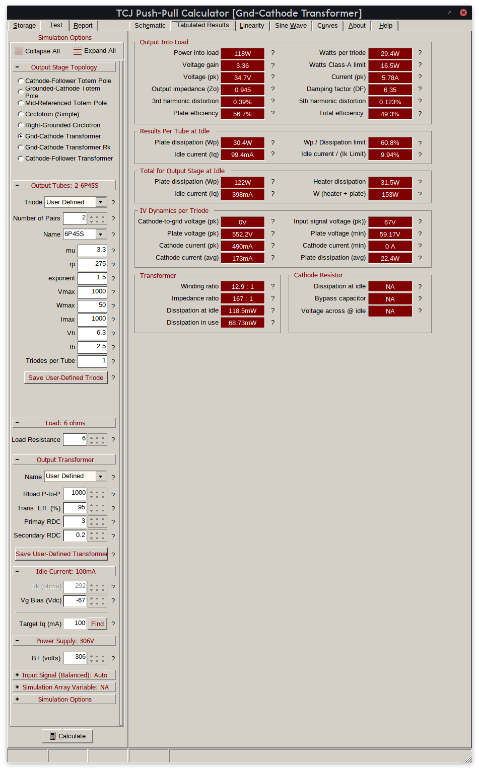

I've rebuilt the amp using 50VA transformers for 3k load instead of 1k3, and 6DQ6B while I wait for 6P31S.
The PI had an error. The splitter should have used 47k on the plate and cathode, not 22k.
For the record, the 6DQ6B is rated for a 1M grid leak as max, I'm using 470k now.
Also, my 6P45S monoblocs are using 510k grid leak and have worked for a long time now... The VA driver is designed for for a 330k load so no problem there.
Time will tell I guess...

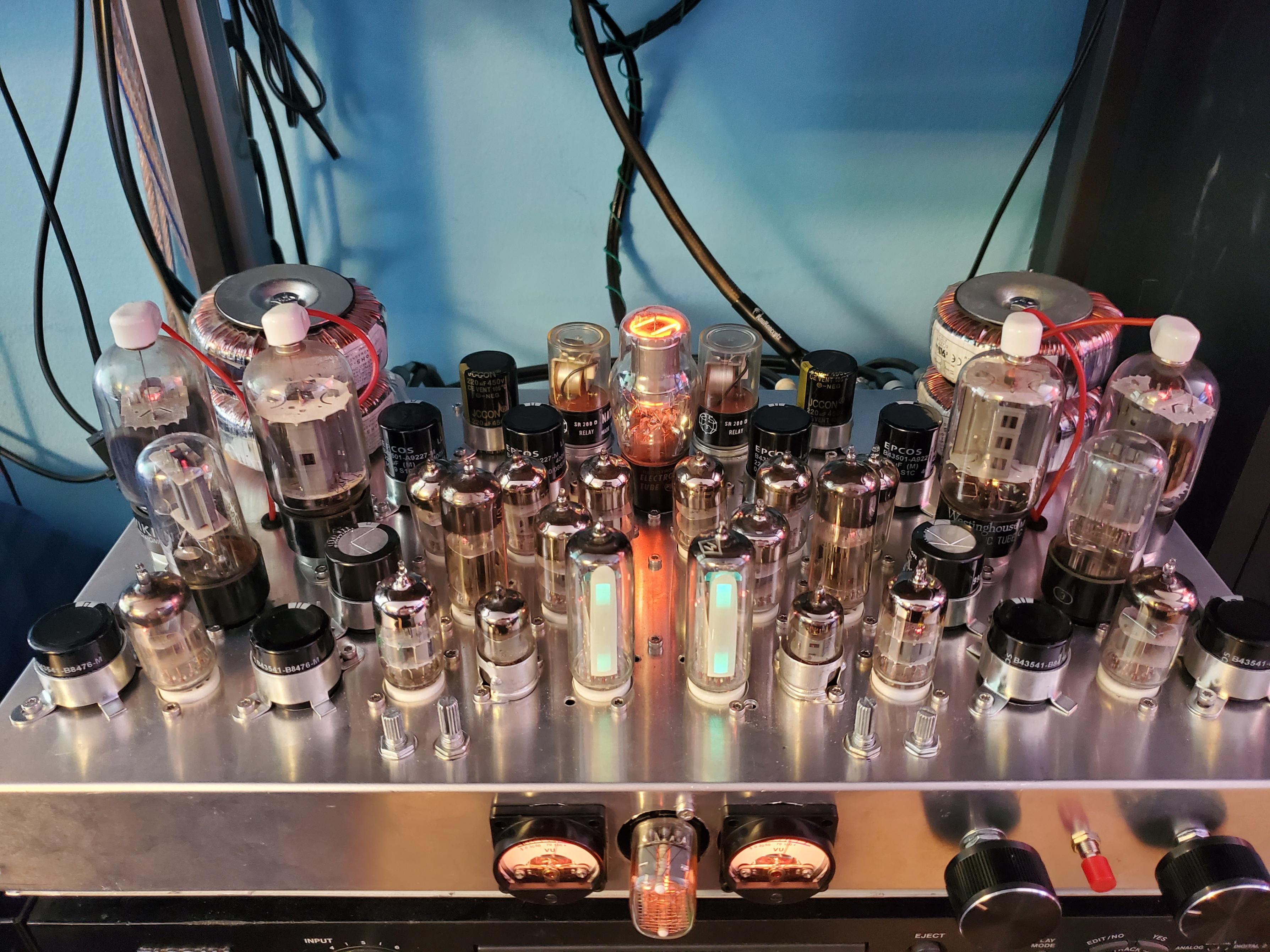

OK, perhaps it was a bad 6DJ8, but with them I had a nasty 6-10kHz oscillation just loud enough to hear. I swapped them out for 6N1P and no more oscillation.
Also forgot to mention:
The 47uF decoupling caps for the phono and line stages were upgraded to 220uF.
