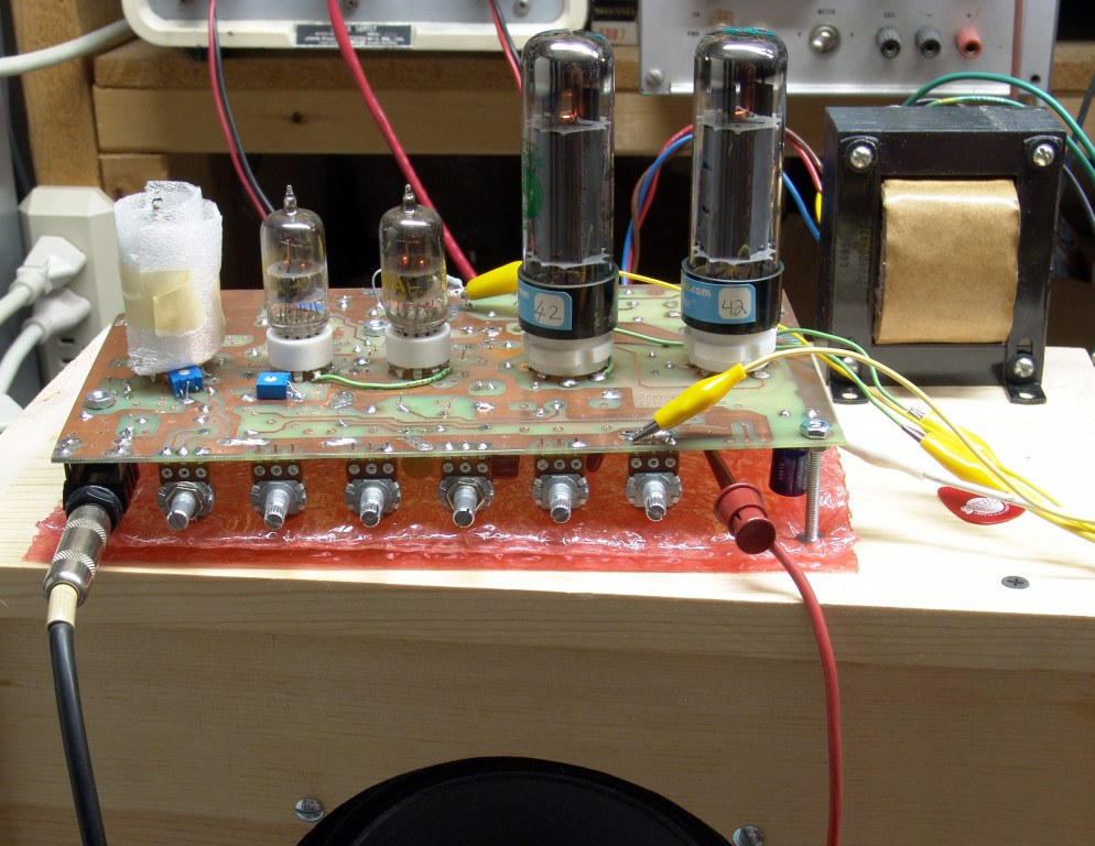

I've tried about 10 6N24P tubes so far, but they all sound like a spring reverb when you hit them. Even changing inputs makes a sound through the speakers.
ECC84 / 6N14P is an option but has more gain. Maybe I will just suck it up and rewire for 6DJ8 in that position.

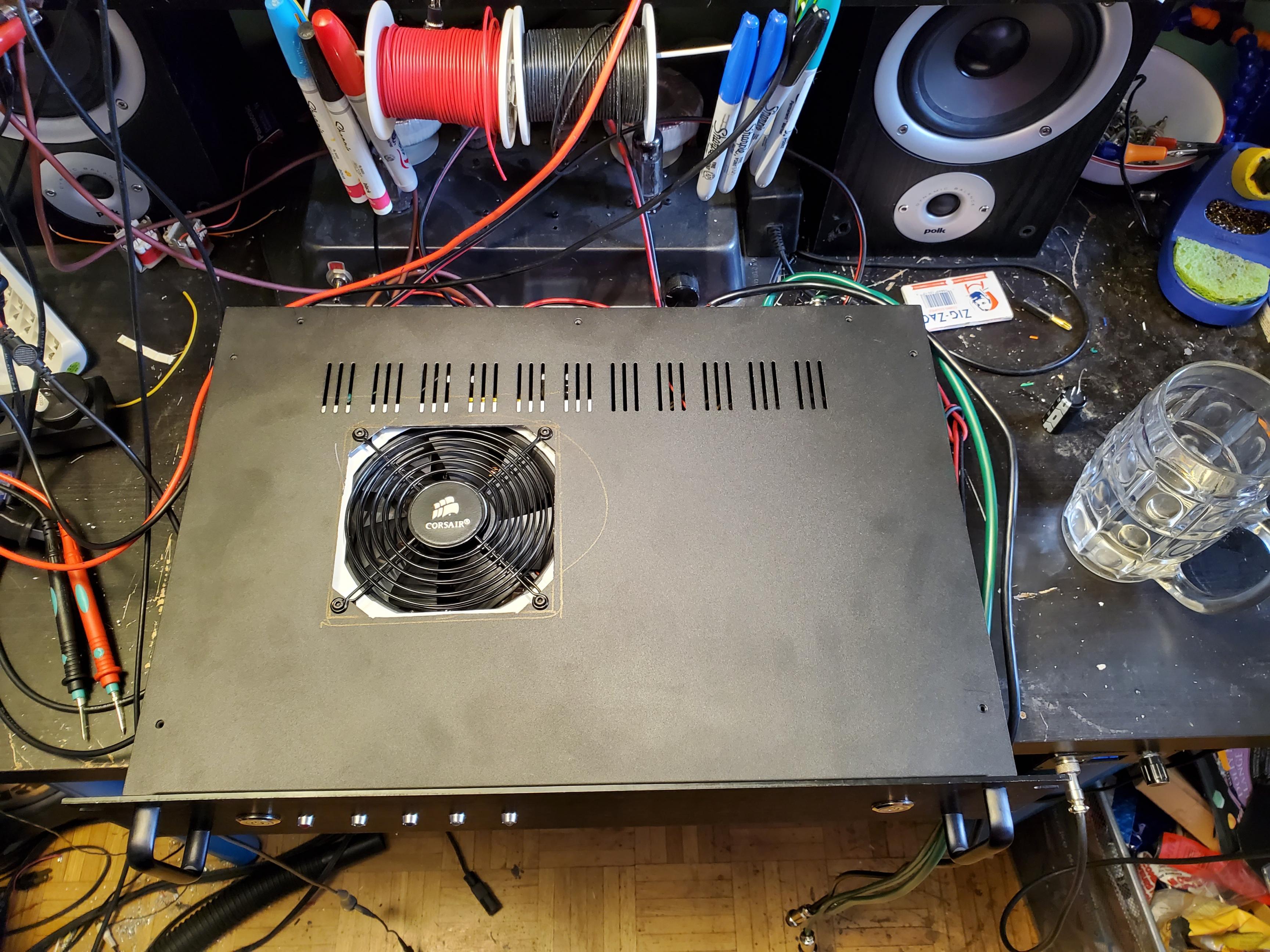

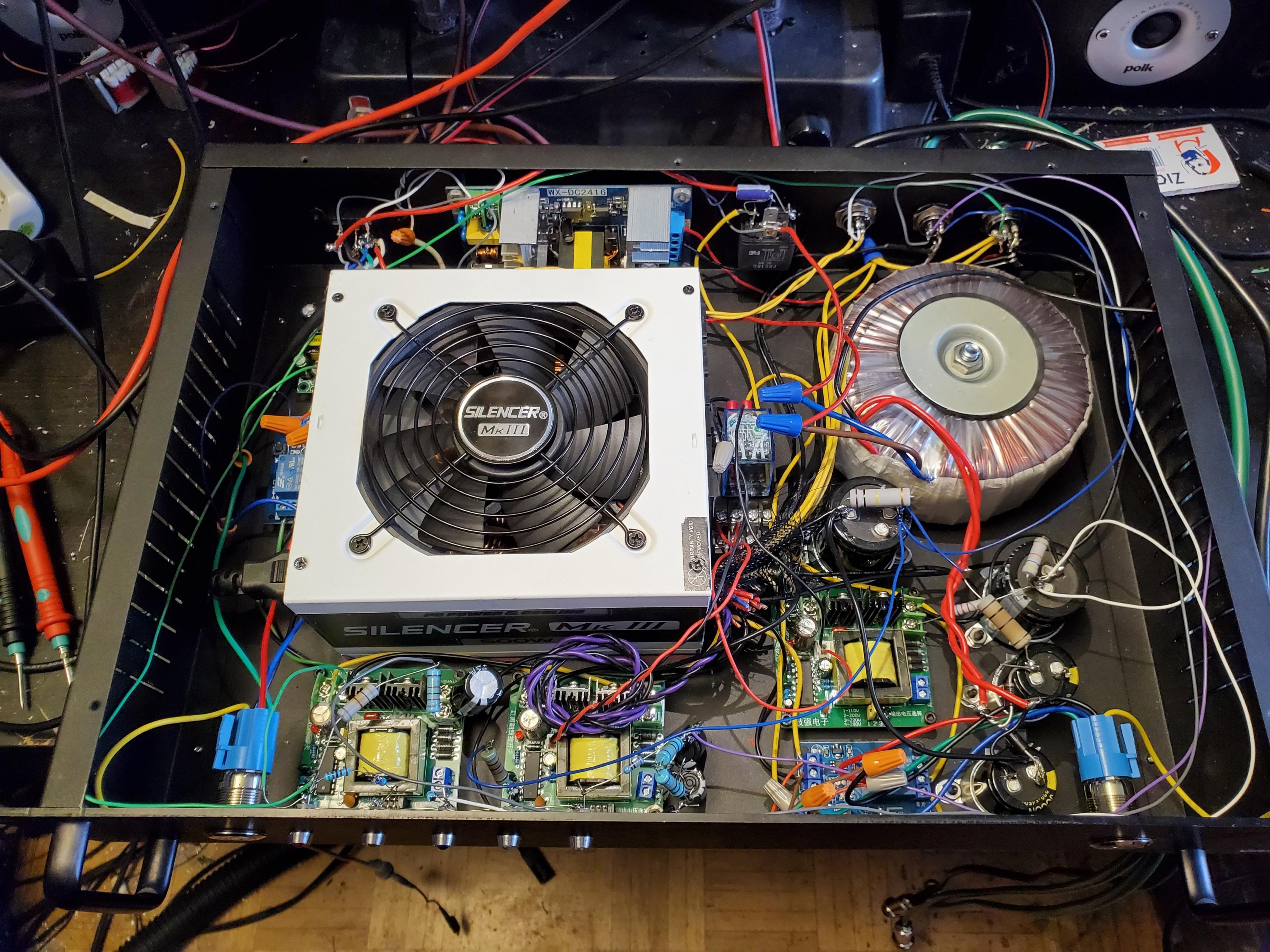

So I opened the PSU up to make a vent for the ATX supply inside.
It took 4 of those little Dremel cutting wheels to do it.
The LED dropping resistor is an example of running a Chinese 2W resistor at 2W in a hot chassis. it still works and measures ok though so j'men câlice.
So I opened the PSU up to make a vent ...
Nice work!
One Dremel wheel per side. How thick is the material? Aluminum?

It was 16 ga steel.
It's not such a problem per se, in normal operation it's never a problem, but if you tap or change the inputs without signal, you'll hear it. On the bench with the speakers coupled to the amp via the table etc, I can get it to feedback just from the microphonics though haha. The dominant frequency is around 5 kHz or so by the sound of it.
My "new" issue is that when the phono stage is on, and the power stage is on, I get 120Hz on the output of the phono even though it's being powered from the DC side of the system. If I turn off the power stage and use an external amp, no hum. If I switch back the internal amp no hum until the tubes are hot and conducting (on the phono output, not the power stage output). I can only figure this is either magnetic coupling in the PSU... Now that the cooling issue is solved, I may try the boost module instead of the linear supply. No 120Hz hum if no linear supply, right?

I had the same problem with UCC85's in a guitar amp I built years ago. Every tube was microphonic, some worse than others. Even with the best tube in the input stage, you couldn't set the amp on top of the speaker. I wound up rewiring for 12AX7's and I put a 5751 in the first stage.

In my case, the amp was upside down with no input connected and hitting the chassis would cause this spring reverb sounding ringing. So I cranked the volume and voilà!
It's a shame really, other than the fact the second triodes' grid is connected to the shield (was designed for cascode) it's basically a 6DJ8 for like 2 bucks.
I'm also happy to report that other than the hum in phono, the amp is completely silent. Unless I turn it up past 30%, then there is a massive oscillation on the right channel, but only when using the internal power amp. I need to reroute the signal feeds. Instead of going up the middle and over to the pot, they go around the right output stage and wiring... I think there's some kind of coupling going on.

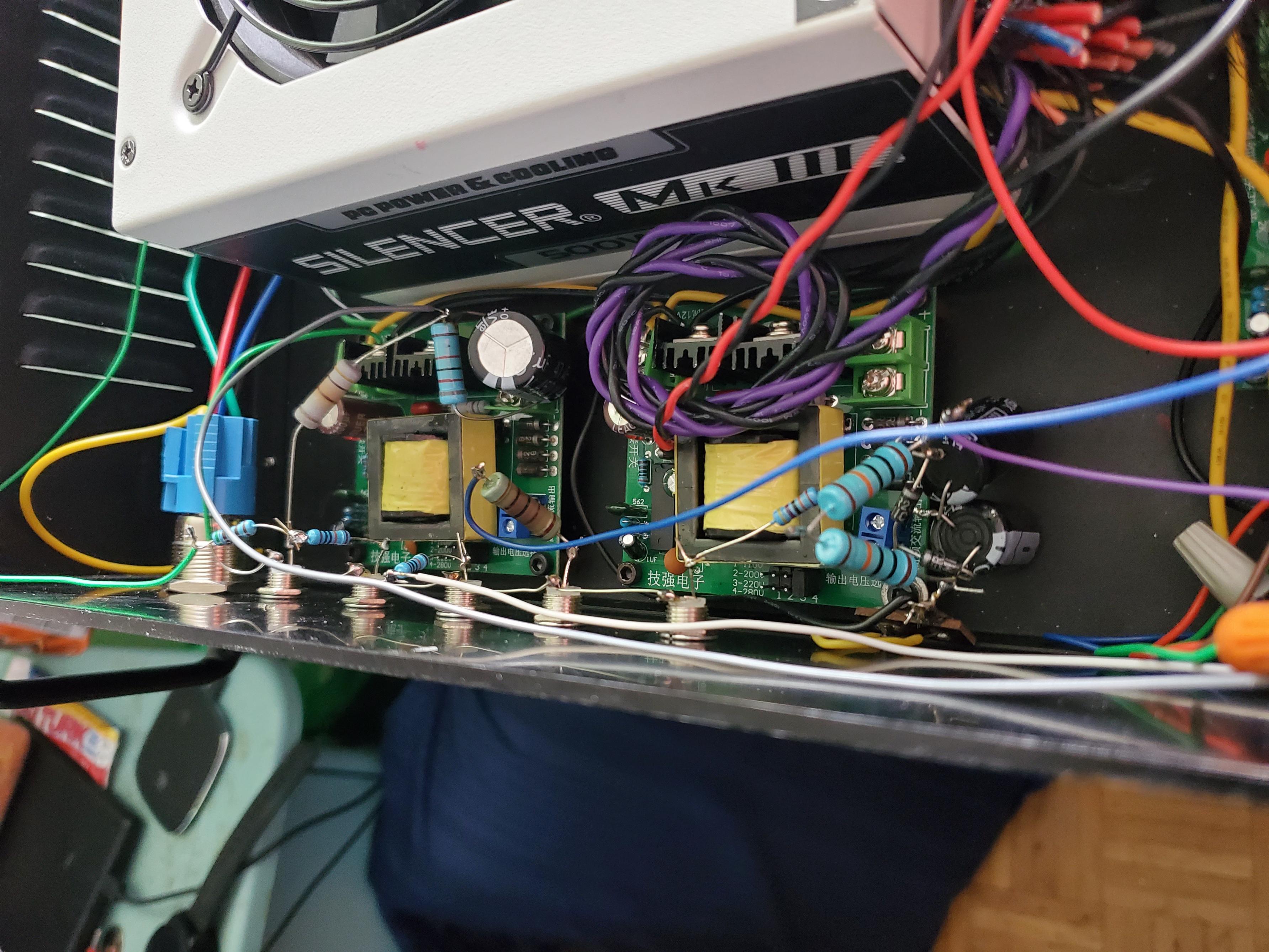

Can anyone assist with this oscillation? There is no oscillation until about 30% volume, then 400 kHz.
If the power amp section isn't on, the oscillation stops. The entire power section runs from linear supplies. I'm connecting the scope at the input to the power stage / output of the line stage.

You might try moving the series resistor on the green wires over to the end nearest the output tube's grid. As it is the green wire acts like a long antenna connected to the grid. A ferrite beat on the lead of the stopper resistors might help too if you have any.
Ok I'll try that... But I wonder why the output stage would cause the line stage to oscillate. The oscillation might be at the speaker, but it manifests on the output of the line stage but only when the power stage is on. If using an external amp there is no oscillation.

I doubt it. Got it to act correctly with the 50k pot after it was buttoned back up, but then the left channel effed off. Now I'm back to a 100k pot which seems only to oscillate when set to an input with nothing connected to it and crank the volume pot.
Admittedly the input wires to the pot are not shielded. The only wire I have that is close to shielded audio cable is RG174. I could try it when I replace the 100k pot with a 50k job.

Ok. So upon reflection I'm pretty sure it was just a matter of using a 1M input to the power stage. I usually use 51k or 100k with the 6F12P.
It's not the first time I've "figured this out" either. I remember now that once upon a time, I was using a 1M input on a power amp and it would pick up radio if the RCA cable was disconnected (and oscillate ~ 1.5Mhz I later found out).
