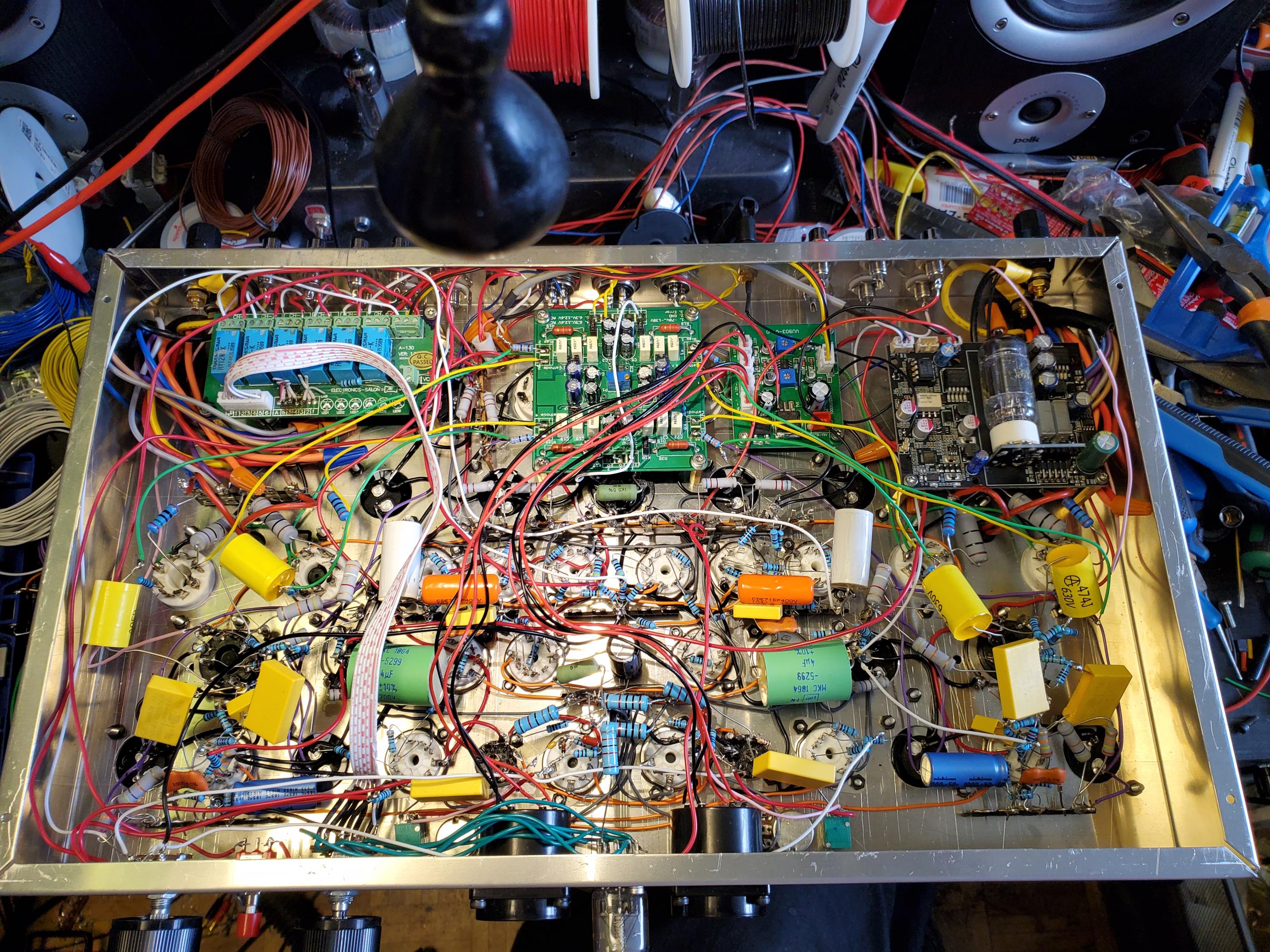

Kodamx, Watching your progress reminds me of when I start building an amplifier. Once started, I just can't leave it alone until its done. Also, you style of building looks as though I took a picture of one of mine with regards to the terminal strips and the point to point wiring. Mickeystan

It looked better without all those wires in the way..😀
I know, right? 🙂
I think it's my neatest work yet. 🙂

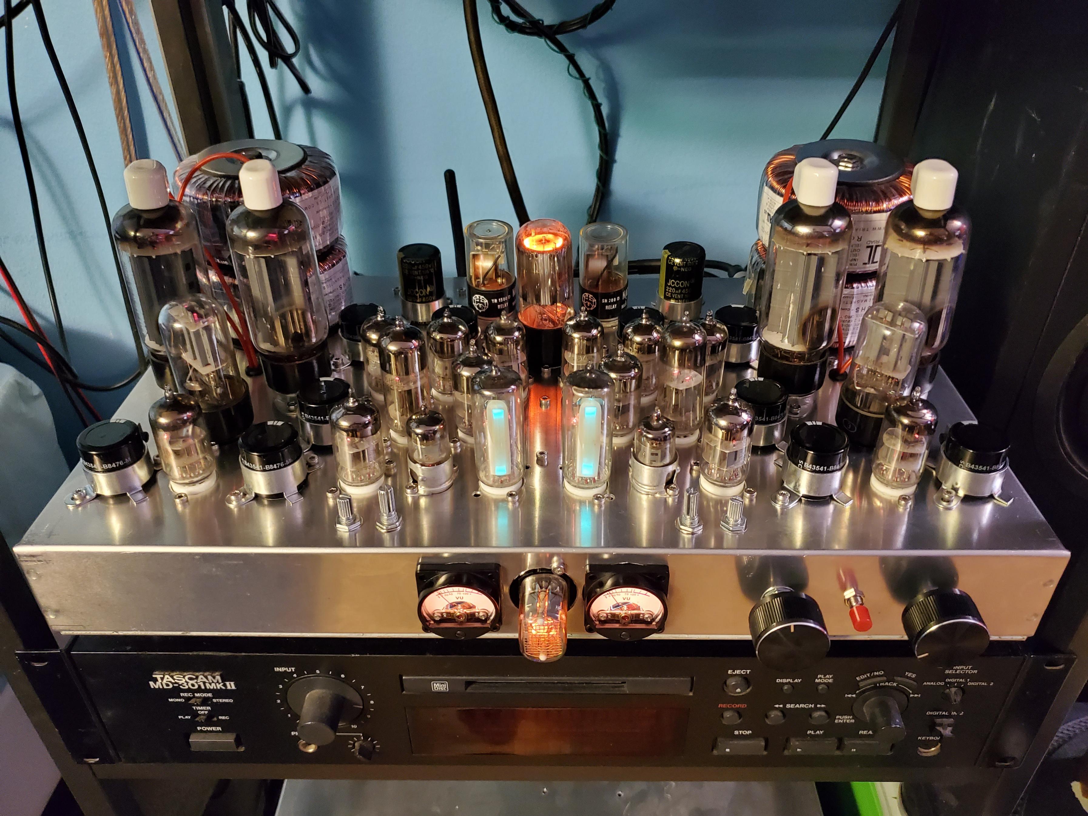

Well, I already trumped the *LW6 with dual monobloc 6P45S 🙂 I wanted to try for a neater design this time around. In this design, even though *LW6 can make over 200W, I use them for about 60W. Limited by the OPTs of course... These same tubes in the monobloc will only make about 10% less power than the 6P45S.
Power stage is switchable, too.
Phono stage is wired up now... On track to be finished this weekend I think.
Looking great! You work very quickly. Assembly is the part I enjoy the most.
Almost there now... All that's left are the boards, I/O, and to wire the OPTs...
Congrats with the progress.

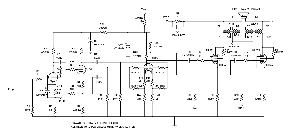

Please show what you are doing with a schematic. I can’t wait any longer to see what you are doing with the XLW6 operating point.
Wow, that's a whole lot of thinking, wiring, and soldering for one week. If I had done that I would have plenty of reasons to believe it won't work.
What is the PC board on the right with small SMD stuff and a vacuum tube, phono stage?

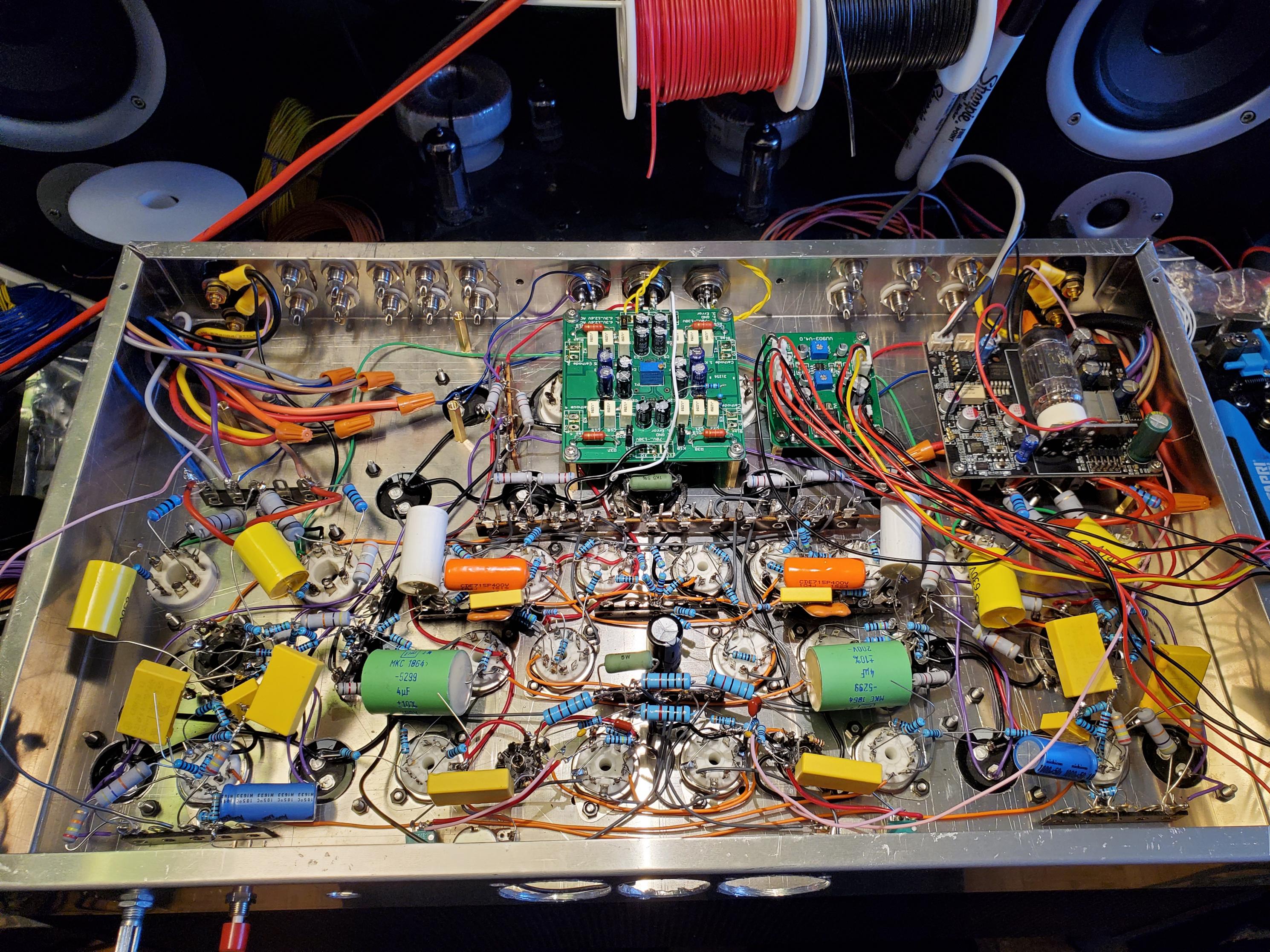

So far the line stage works, the 6J1 stage works, and the phono stage works. The 6E2 probably works.
I had to change a dropping resistor from 1k5 to 620 ohms, and I forgot a grid leak on one of the phono tubes... Now to test the VA/PI before adding the 330V power stage and testing the biasing board.
I would have finished it 3 days ago, but Thursday a friend came by, Sunday my dad came over, and yesterday another friend dropped by. 🙂
That board with the tube on it is a bluetooth receiver 🙂

Ok well the VA/PI/VA stage works but now it's off to bowling...
I'll resume tomorrow with the testing of the output stage and bias board.
Also the 6E2 is just pegged and the controls don't do anything. I guess I have to look at that circuit again.
Well after some struggles, it's up and running! Yay!
The 6E2 was miswired, as was one of the output transformers... Also one of the boost converters was replaced with a linear supply because the 12V supply is 50$ garbage. LOL
