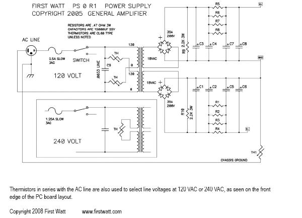

Hi CNX,
Please see the schematic for the power supply for the F5 that I am building.
WIth the soft start board, Can I omit the thermistors?

Please upload the schematic again, i just cannot see it.
do you want to remove the thermistors from the powersoftstart ? is a bad ideea. at least replace them with some power resistors, 5-20R at at least 25W.

Hi
This is the image. In fact it is the power supply described in the F5 manual.

I have another go at posting the picture.
With this soft start, can I omit the thermisters in the picture ?

as luka already pointed out, if you remove the thermistors, you won't have the current limit function anymore and the current demand for charging the capacitors can be high enough to trip the mains fuses or even to blow the rectifier diodes.
